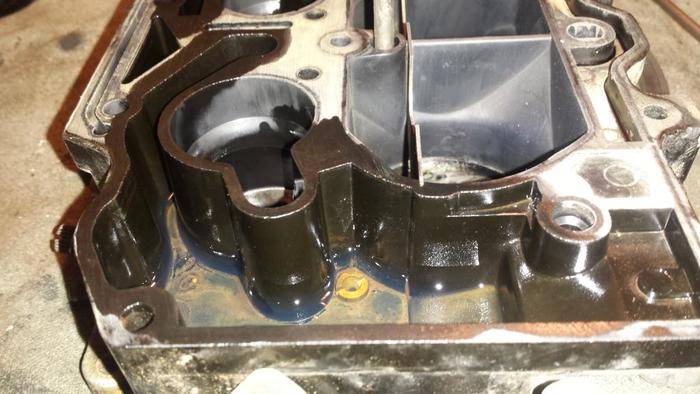

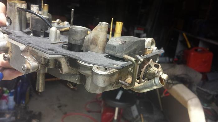

I pulled the carb, tore it all down don't see any issues internally.. fuel level looks low jn the bowls when you pull the lid.. but the floats are set right. The primary gaskets in the bowl are there and proper, everything seems legit in there. Top, bowl, and throttle plate all seemed pretty flat. No warping. Intake seemed to be pretty perfect albeit a bit corroded when I got it..
Blew everything out, made sure the accel pump has a good shot..

The throttle plate shafts on the Thermobog have a habit of wearing the base plate and need to be bushed. Did you check for play or any wobble in the shafts?

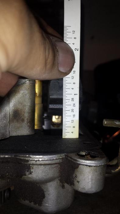

You guys will never guess what the issue was.. The instructions I had on how to properly set the float level were confusing at best.. Definitely Chinese written lolol
I had the float the thickness of the float too low..! Jesus what a frig around. As can be seen, I had it set to spec, but at the wrong spot.. didn't even occur to me that it was wrong.
So I set it to the proper setting for the float level, and lo-and-behold doesn't it run just as it should.. ?
