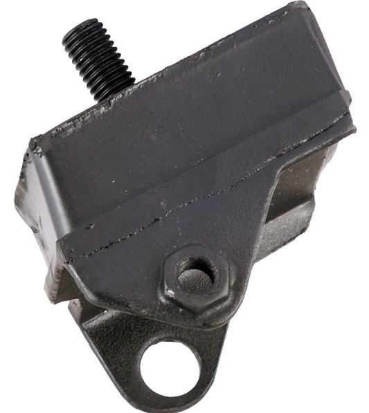

Chrysler changed from a flat rectangular mount to a round engine mount around '72-74 (depending on body type).  The older flat mounts can/will break allowing for the engine to move all about the engine compartment (not a good thing).

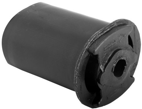

The newer round mounts are made so if the rubber breaks, the engine can not go anywhere.

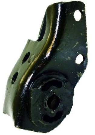

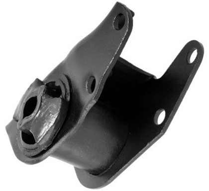

Also the newer mounts (the ones used for FMJ's) are almost (but not quite) universal – but Left sides are different from the Rights (but not sure why made that way).
The '72 and newer B-body had round mounts, '73 for A-body & '74 for C-body.  The E-body (and pickups/vans) never did go to the round mounts for /6 or LA engines.
All /6 passenger car (not pickup or van) mounts, from '73ish to '84 (A/B/C/F/M/J bodies) are the same.
All big block mounts, from '73ish to '78 are the same (B or C body, but again, not trucks/vans).
All small block mounts, from '73ish to '89 are (almost) the same (A/B/C/R/F/M/J bodies) but trucks/vans and E-bodies.  With that said, all Right side (round) engine mounts are the same.  The Left side mounts are different between the 273/318 and 340/360 engines – by about ¼ inch (just enough to be noticeably different).
There is absolutely no way to put a 340/360 Left mount on a 318.  A Left 318 mount can be put on a 340/30 if you install “about” ¼ inch spacer between the mount and block ear – but my experience is using the spacer causes that bolt to loosen over time.  My recommendation is to find a 340/360 Left mount if installing a 340/360 engine into a car.
