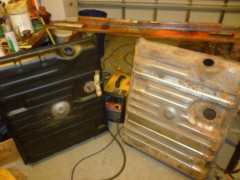

Side note greymouser has 2 new gas tanks which I was able to compare to the tank on my car and it is an exact match. So the old tank will be going bye bye.

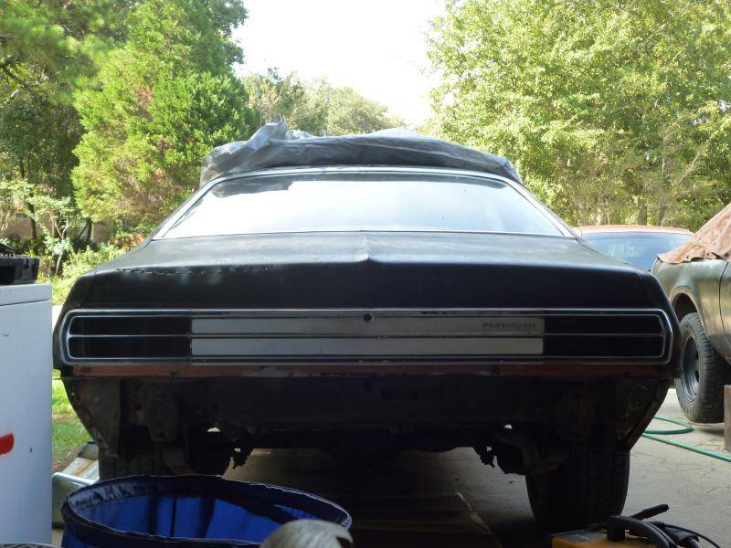

I was able to mock up the tail panel and there is still a bit more trimming to allow the tail lights to fit in but the more I work at it the more it lines up perfect. I am not having the fear of a crooked tail panel anymore. I am just going to tack it in all around before laying a good bead. so that if it doesn't line up I just have to break a spot weld to adjust.

Here Are some pics of the tanks new and old...

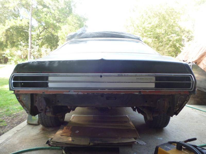

its only spot welded in still haven't committed to this alignment. in person it looks good to me but his picture because it is angled a slight bit more to the passenger side makes it look crooked
