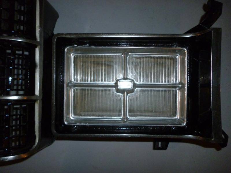

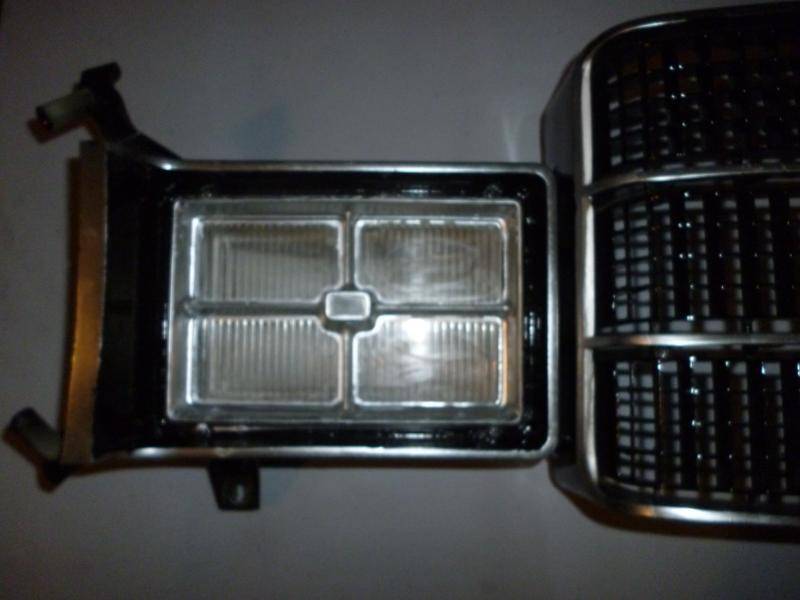

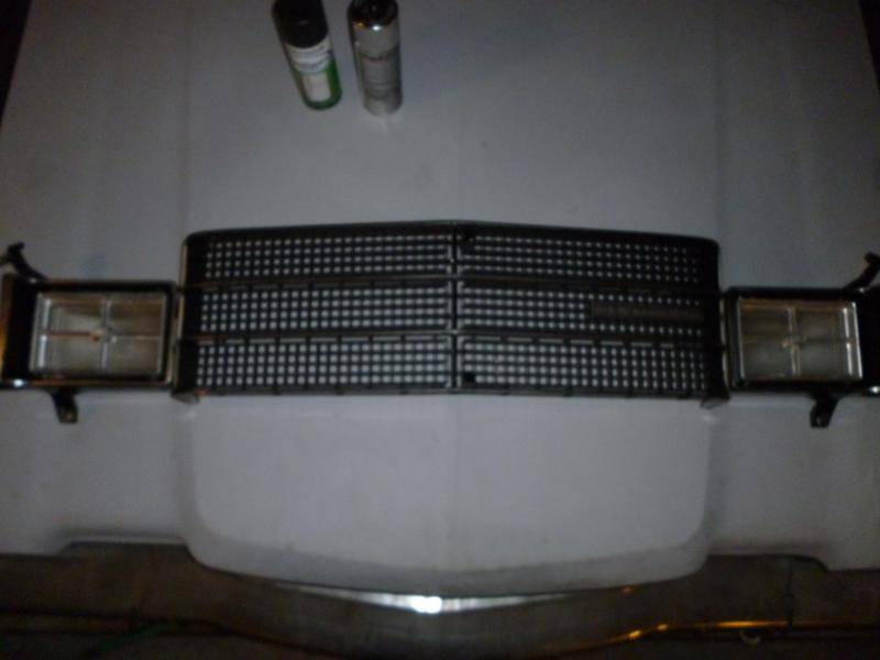

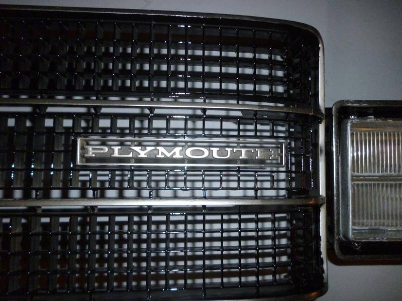

Thanks it was alot of hard work getting all that in there. Its getting a classic tag and the licence plate is going to be custom BLKBRD. not sure how well it runs yet but it did crank and cylinders fired briefly. its out of gas and I am not filling it up till after the trunk repairs go on since I will have to drop the tank. The rear seat was covered with a Mexican blanket from the Hess station. I just finished my grill repairs and painted it up with Rusto Appliance Epoxy and Duplicolor Instant Chrome.

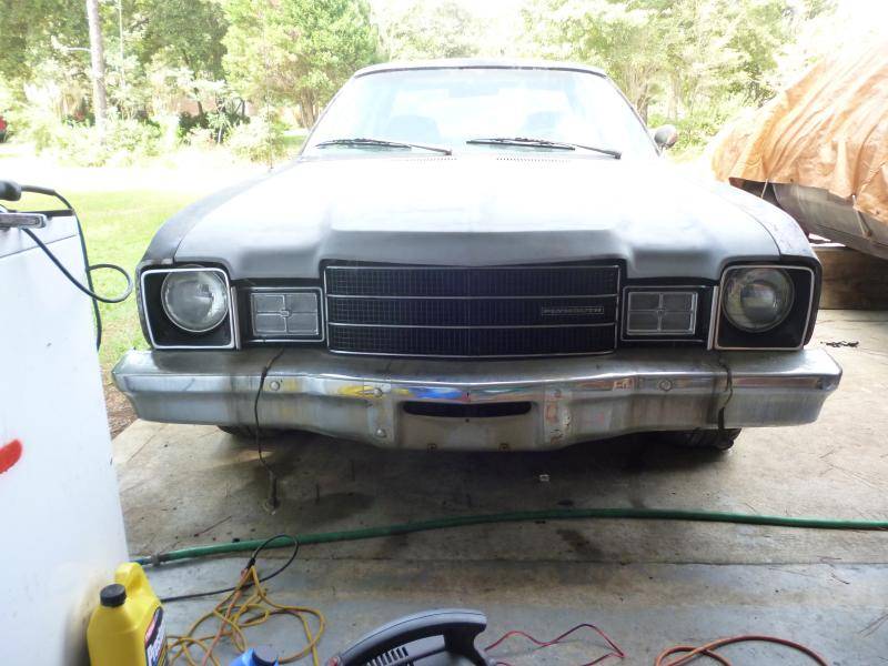

Had to see how it looks with the grill.. and headlight bezels.they are just set in there I'm not ready to screw them down yet

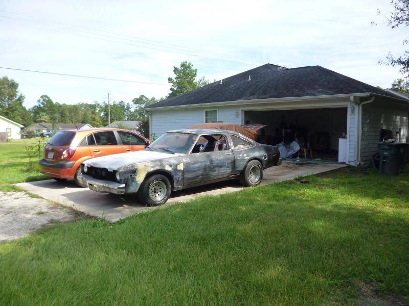

IT MOVED!!! I turned it around so the back is facing the garage so I can work on the trunk and taillight panel in the shade...
