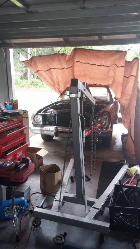

The more I put back into the car the more room I have in the garage....

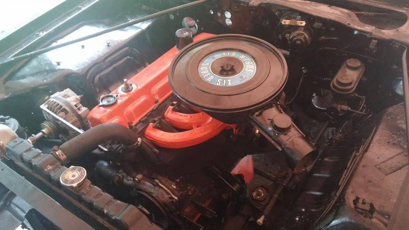

The tree in my yard looked like a MOPAR Christmas tree with all the painted parts hangin off it. I like the orange also but it wasnt by choice it was what we had. I do think it turned out well. Amazing what a little paint can do for some old parts

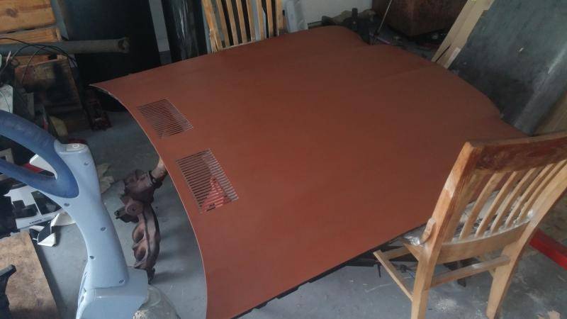

I should have my hood ready to paint sometime tomorrow and then I can put the hood back on my car. The hood is taking ALOT of space. As soon as I get it on the car and empty the parts bins I can begin doing the same thing to greymouser7's Aspen. It takes working 12+ hours everyday for 1 man to get things done this fast. Its a race with the clock on this one.

Got the intake/exhaust manifold ready to bolt on. I cant wait to see what it looks like with the super six air cleaner on... calling it a night. :sleepy2:

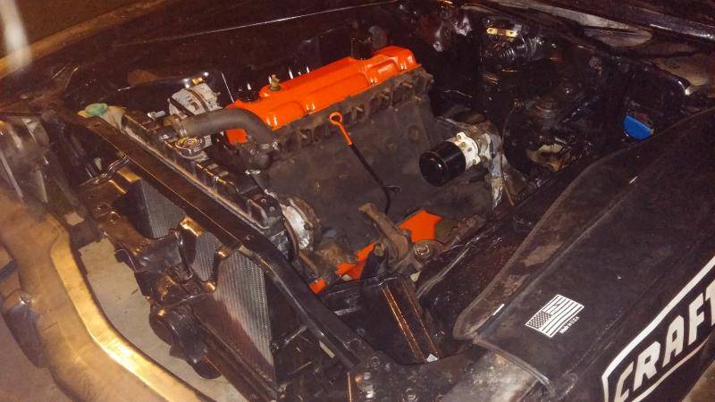

Had a bit of a snag today when I went to install the power steering pump.. the crank pulley is only two groove and the original engine had AC so it was a three groove...I should have took pics because I used a long piece of rope to hold the crank still by tying it to the torsion bar and a pole from a chain link fence as a breaker bar... lol looked hilarious but I was able to swap the third pulley from the old engine to the new. also cut hoses for the breather, PCV, installed the fuel hose and the drive belts...Those were the last things in the bin that I am using for greymousers dash pieces
