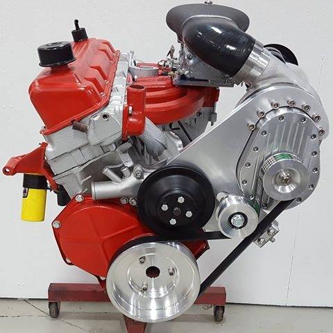

MiradaMegacab
Feb 27, 2011
1,847
753
Long Island NY
Did someone say Boost?
Don't take anything apart, low CR begs for a supercharger:)
