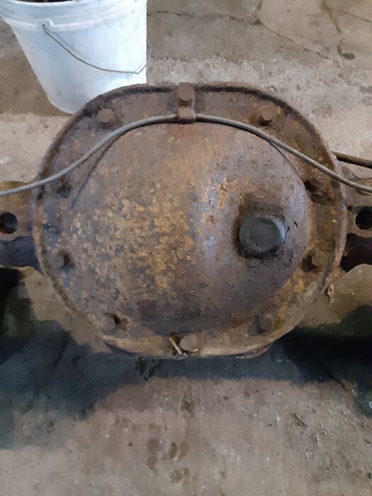

My 89 Fifth Ave came with a 7.25” rear end with 3” axle tubes that had a taper into the differential housing and flat sides on the diff cover. 8.25” will have straight 3” tubes into the differential with no taper and an oval diff cover.
A lot of guy have been fooled before and thought they had a 8.25” when they only had a 7.25”.
I've done the homework on the differences and that is a common scenario I've read about. It indeed has an oval cover, with full length 3" tubes. If I pop it open to find it's a 7.25, I'll be very surprised. The 7.25 has more of an octagon shape, mine does not.

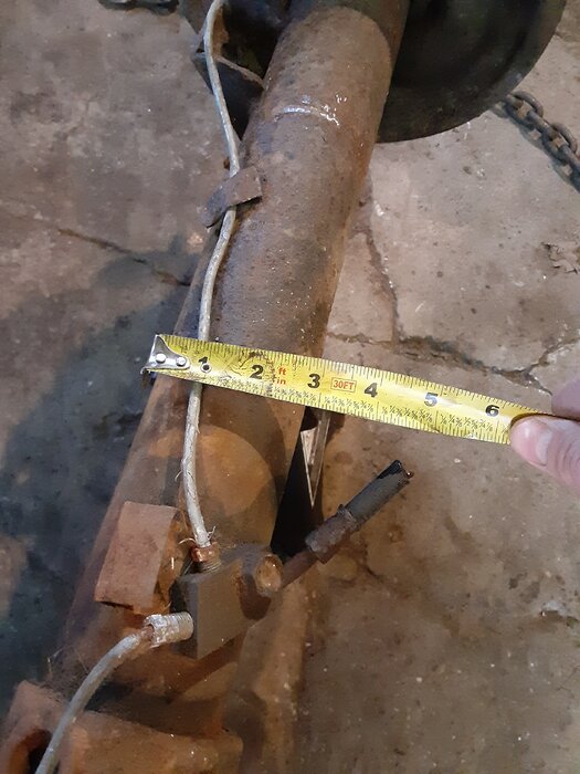

I've seen at least one 88/89 with 8 1/4 but very rare. A lot of people mistake the 80s 7 1/4 as one because of the 3" tubes and roundish cover compared to the older ones. But tubes 3" from end to end mean its 8 1/4.
The transmission is hit or miss. When it comes to 904s behind 360s I run them till they die and then go 727 and that's what I'd do in your situation also since you've already got all the parts now. Other then whatever linkage you need for the carb you're using. If it doesn't last then you can decide what you want to do with it.

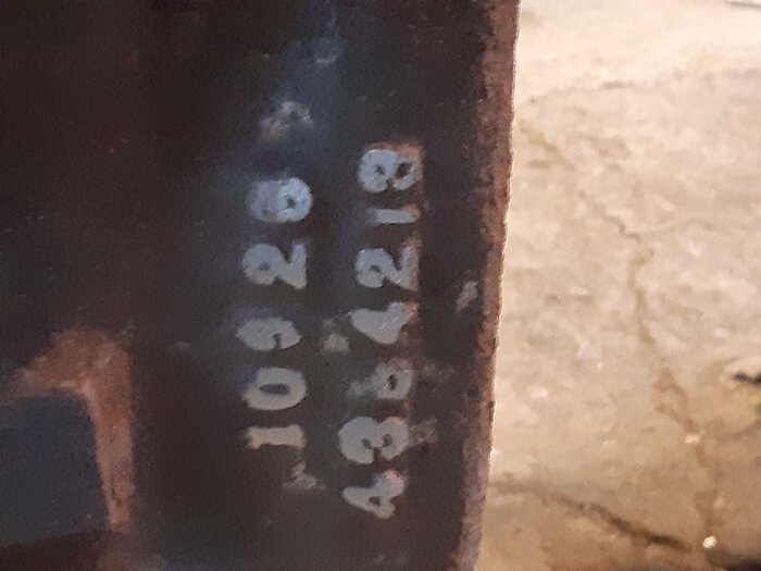

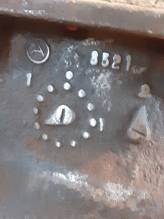

Here's a few pictures I got this morning. I can't quite make out all the numbers that are cast into the center section. Definitely 10?2? and below that, looks like 4364213. As for the date of manufacture, looks like the four digits are 8?21. The second number there could be a 3, 5, or 8. Hard to tell.
Definitely 3" tubes all the way and an oval cover.

That's a rarity for sure. Wonder if it was swapped in.

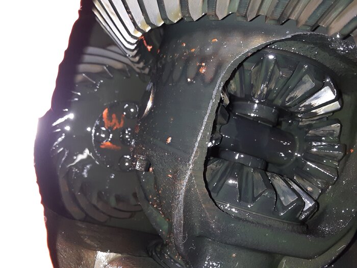

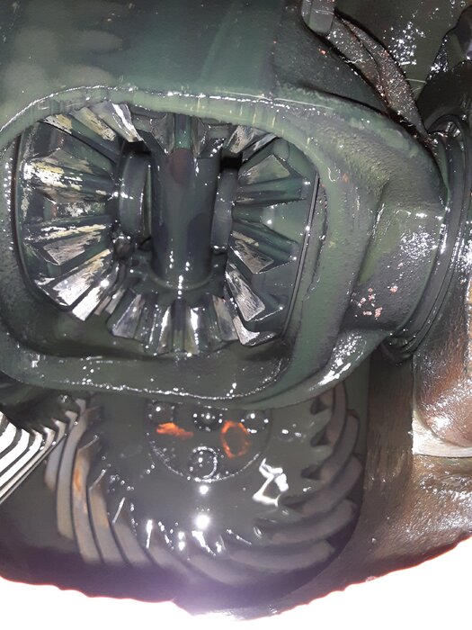

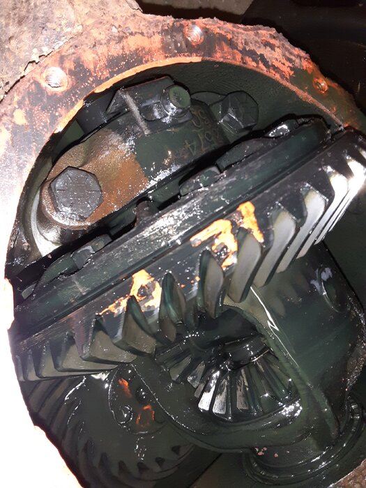

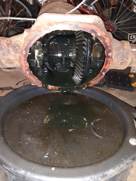

Just got around to popping that cover off the diff. 47 teeth on the ring gear and 21 on the pinion, so I've got the fuel sipping 2.2 instead of the highly sought after, tire shredding 2.45 like I'd hoped for (sarcasm). I can't complain, though, because the gears all look good. The oil I drained appears to be brand spankin'. There's no mentionable backlash in the pinion. I was going to pull the axles and inspect them, but I'll leave well enough alone for now.
Question: what can be said about the paint marks on the ring and pinion? Looks like 31 and 01. Is this a factory thing, or a sign of a rebuilt differential?

I don't think I've seen numbers like that on any of mine. It's not very likely that it's been rebuilt being behind a 318 in a 5th Avenue. I'd almost wonder if maybe it was a replacement rear if the original 7 1/4 got chewed up at some point but the most common 8 1/4 to find for that would have been in the 2.45 2.7 2.9 type range out of an AHB.
Thanks, Mike. I did think the paint was a bit odd at first. The fender tag indicates an A998 trans, but I still can't say for sure what rear end was supposed to be in it originally. According to the previous owner (for what that's worth) there have been no major mechanical issues to speak of. Like I said; for what it's worth
