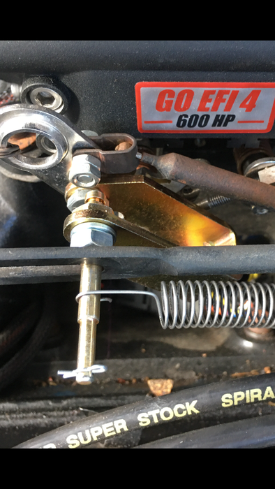

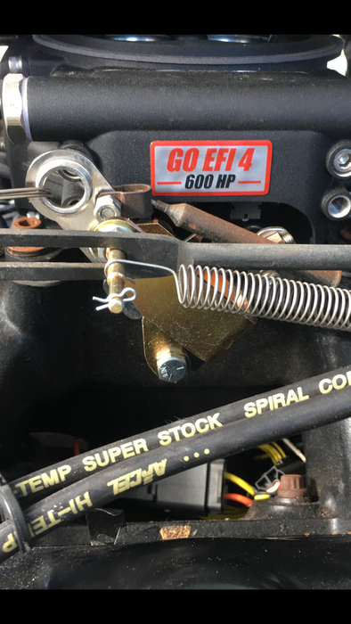

Ha! Mine has been in almost 2 years, but I'm also having other work performed on it and with one guy there qualified to do the work, it's been time consuming, but I do believe I'll have it back before June lol. I'm not expecting much in the mpg area, but hopeful that it will be a smoother performance overall, and maybe a modest increase in hp since most of the smog equipment will be gone. Mine is undergoing an engine overhaul with this fuel system, but I'm also having the front suspension rebuilt. Once I get it back I'll post a video on YouTube and what my mpg's are with the Sniper. I'm still running the 7.25 rear with the 2.2 whatever gear ratio. Later on I'm upgrading to the 8.25 and probably the 3.07 ratio with new leaf springs, so I'll be able to do mpg's with each phase. Here's the last pic I snapped and honestly, missing my car, but I also can't wait to report on the performance of the Sniper. My patience and my tech's patience will hopefully net a quality ride. I would also guess that the different Sniper kits may yield varying performance results.
