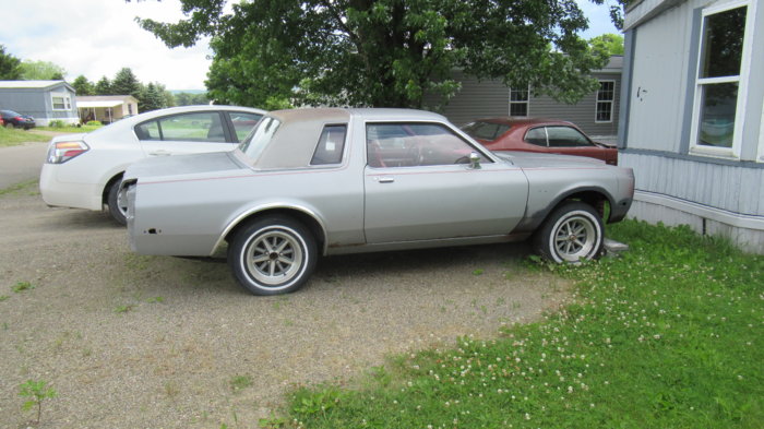

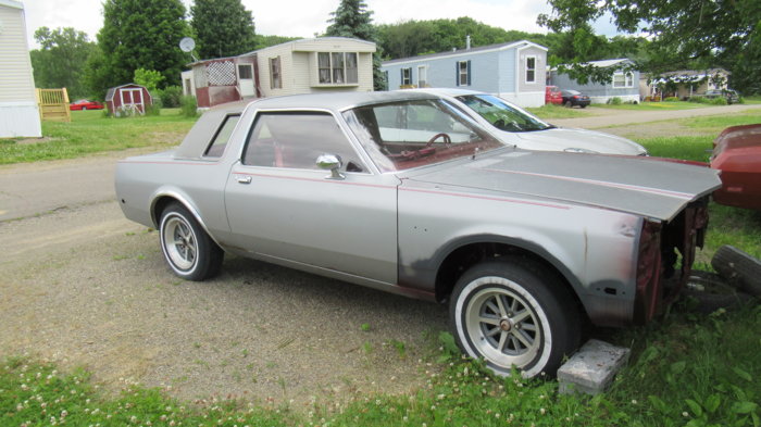

hi folks,im an old fart whos gotten himself into a bit of trouble here with this car.
its a 1980 lebaron salon coupe thats grey? silver?
faded is a good word,with red interior.
it has original wheels and seems like most of the parts were there Except under the hood is Bare,no nothing.
it came originally with a slant 6 auto trans,and im not real sure what rearend this is.
plus this thing has what looks to be brand new bushings/body mounts and the entire k frame is new or completely refurbed,im not sure which,but it looks pristine/newish.
the body seems? good and the interior is mostly Really nice except for the headliner.
i was doing a cleanout job for a lady when i saw this car sitting in the trailer park and figured why not ask?
an amazingly low wad of cash later and its now sitting in line with the rest of the herd.
yes,the bumpers front nosepiece/grill and rear tailights and bumper were all in storage there and in Vcg as well.
looks like someone was getting ready to paint the car the underhood area is done already.
however,im kinda not up to speed at all with this odd torsion bar setup on these cars.
looks like they made more space but the steering linkage runs across the rear instead of the front of the engine bay.

If it was a 4 door I'd say bail on it because there are better examples for cheap... but a 2 door makes it pretty special.
- Drivetrain options are all the same conventional choices as that Abody in the background.
- Suspension options are probably best eyeballed at FirmFeel.com.
- And look for some build threads here on the forum to scroll through.
2,992

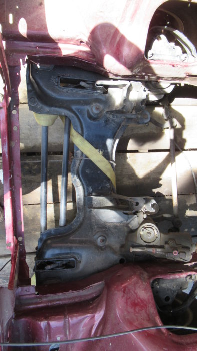

If it's a S6 k-frame, you'll need Schumacher engine swap mounts to bolt a 318 to it.
The rear axle is an 8.25", if that's what you were asking about.

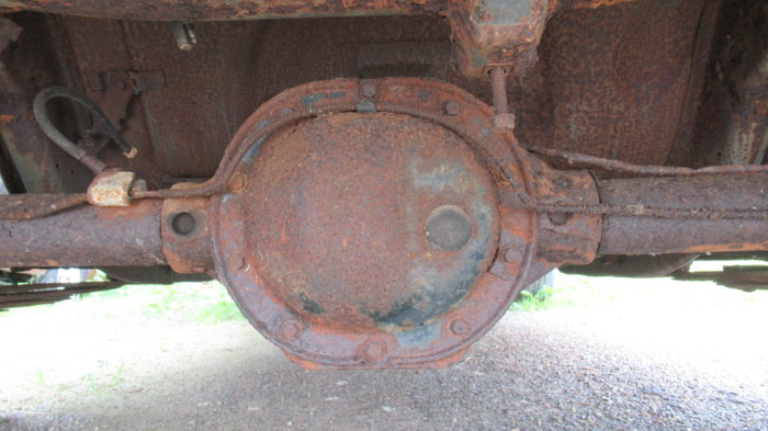

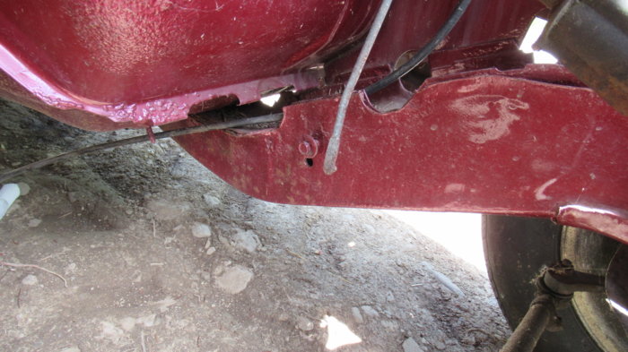

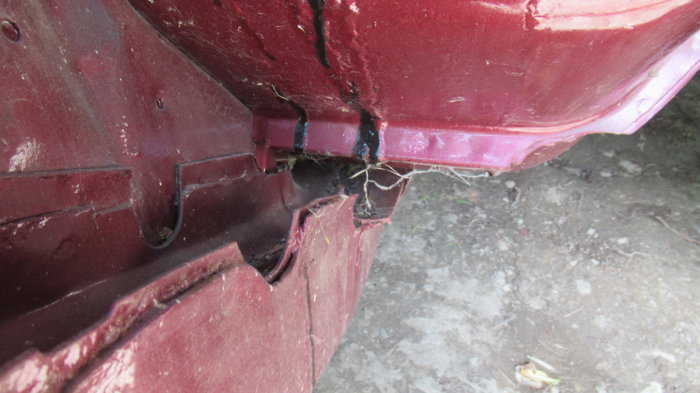

Yeah, looks like a New York car underneath. What do the frame rails look like?
I do have to say though, I think the LeBarons are the sharpest of the entire M body line. Wish I could find a clean one.

Your reply is kind of confusing. Why would you bail on it (if it was a 4 door)? This is a mostly complete car and it was cheap.
Only because there are 4 door cars for sale on this site and craigslist that are still cheap and incredibly clean. It would be much more cost effective to buy one of those.
-BUT-
Yours is 2 door and thus more rare, desirable, and worthy of the restoration time/money. Just keep that in mind as you bump into part shortages, paint work, and upholstery expenses that may shake your resolve.
... Also that rust does look kinda angry. Are there any holes in it yet?

Wow, you got the last dance at the prom, too bad it was with the lonely fat chick.
Good luck if you proceed, I think its gonna kill you on small parts where this one here would be a exe. parts car. If you not deep in it as you say, the rims are worth a little coin.
But you just cant unrust a car thats that rusty on the bottom.
Maybe its a geographical thing, but cars like that around her get parted or worse.
But I wish you the best of luck on whatever you decide to do with it.

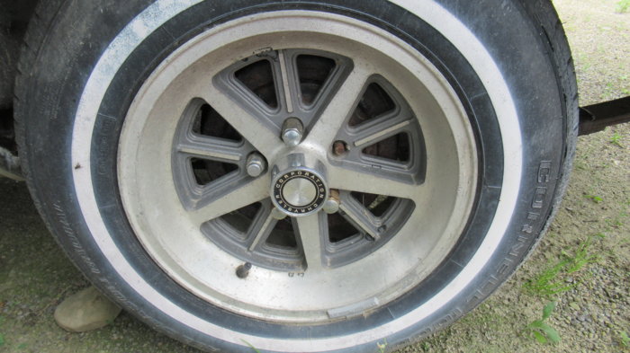

Looks like a fun project. I really like the roof lines and back windows!! Very sharp. The wheels are great too. Would you keep the same color, or change it?
beatersRus
Jun 30, 2019
94
22
14560 new york state
as far as the bottom of the car goes,yes,its a new york state car its got some crusty on the bottom but it isnt rotted to death like a lot of our cars are.
" you cant unrust a rusty car"
no,but you sure can clean it por15 it and Stop the rust??!!
apparently noone has heard of por-15..?
this cars too nice to be parted period,and its a 1 owner car with 34,900 original miles even.
so no ty for your kind offers to part out my car........

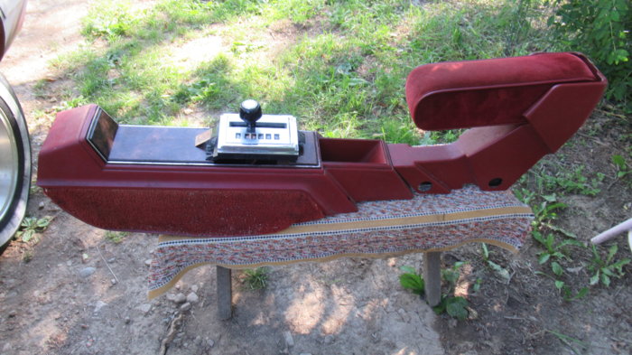

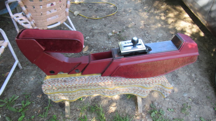

altho i would sell the console/w/shifter and the wheels.
i understand those are collectible and i wont be using them.

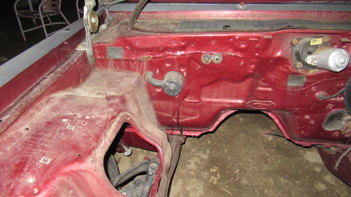

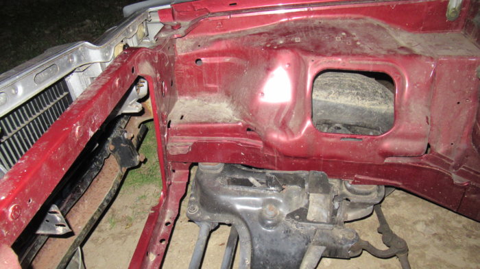

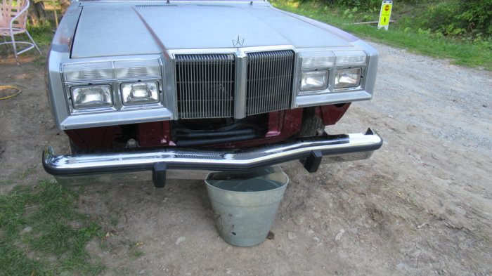

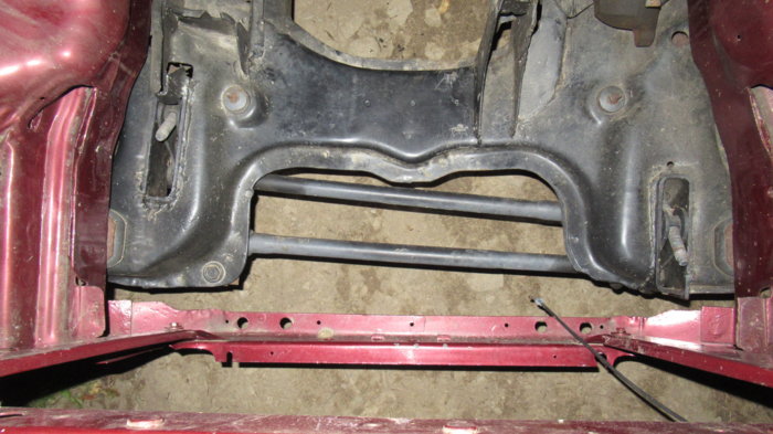

i spent a little time tonite cleaning it up and installing the front clip and rear lights.

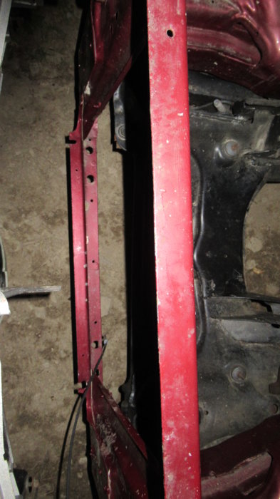

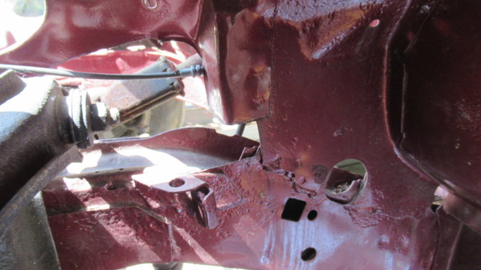

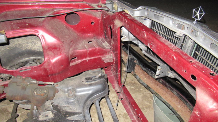

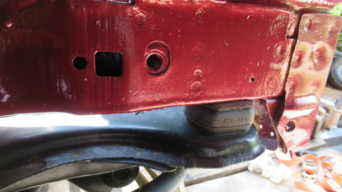

i do have an issue tho,in that the k frame appears to be sitting Crooked in the car?
is that possible? can it simply be loosened and adjusted?
Alignment looks to be too far back on the passenger side when looking from front of engine bay.
motor mounts seem to be aimed towards d-side tunnel/firewall.
please lmk what your thoughts are.

I don't know about the K. It does look off, but it's hard to tell with the photo. The core support doesn't look square either. Need more photos.
For the 518/500 I can help you with that. I've installed both into multiple F/J/M cars. It does require fabrication.
Axle isn't hard so as long as you're not a purist and are open to non Mopar axles.

Wow its cleaned up good.

core looks good to me?
that was one of the first things i checked.
im hoping the kframe can be loosened and tweaked into place,
ive never messed with one of these m cars front ends before.

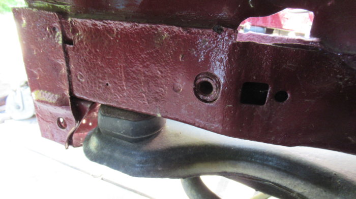

look at this k frame i kinda wish i had better pics because i swear it Looks new,
look at the bushings too,and the steering box itself.
and so do the parts on it everything except for the steering linkages.
comparing this to the rear of the car,which is crusty ?
