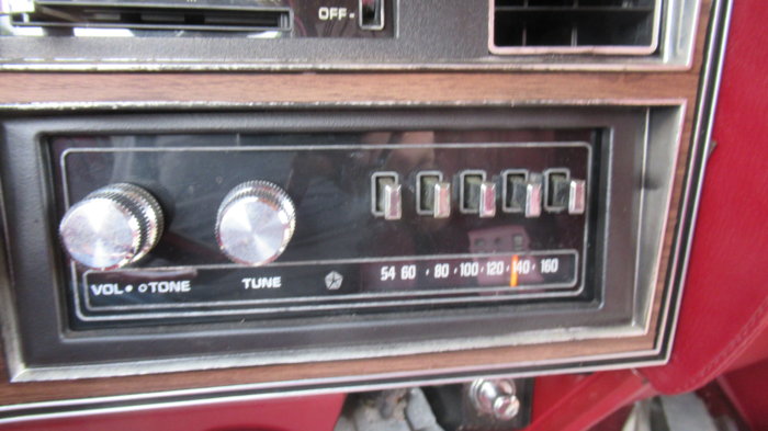

all cept that am radio lol,i could use a different radio setup that fits that space.
would prefer a newer factory one but still older setup.
like the ones with the tape deck And the cd and the little joystick for the speakers.

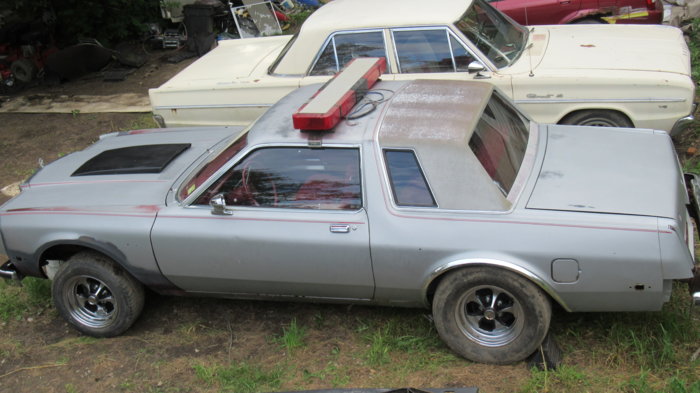

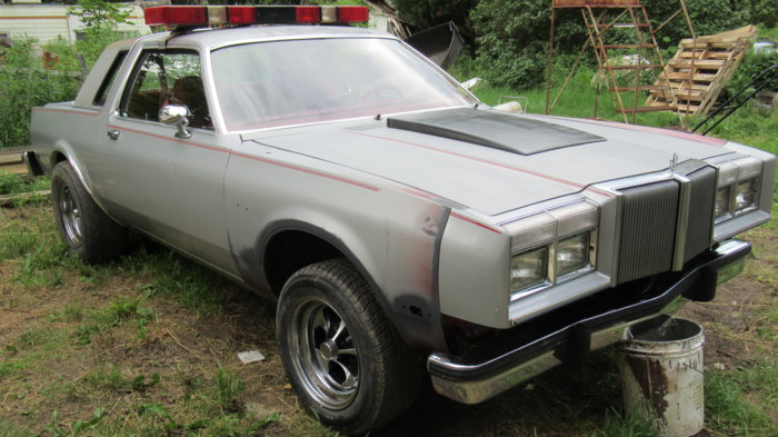

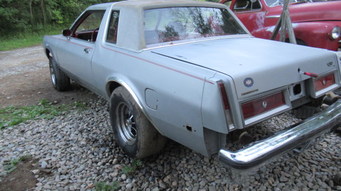

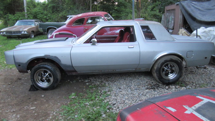

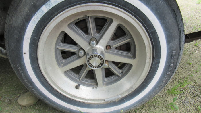

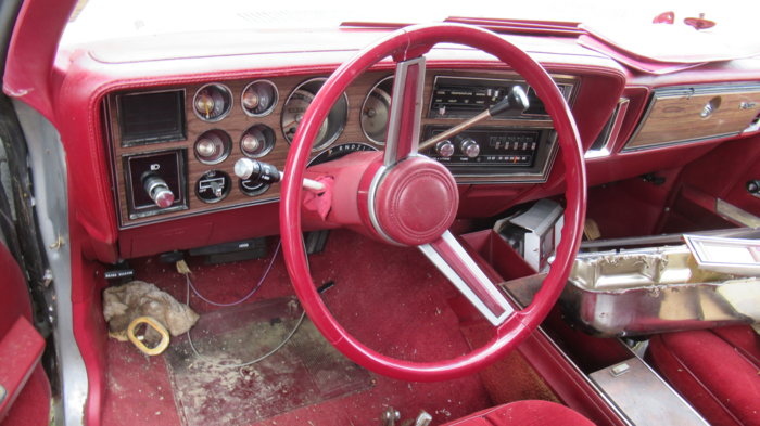

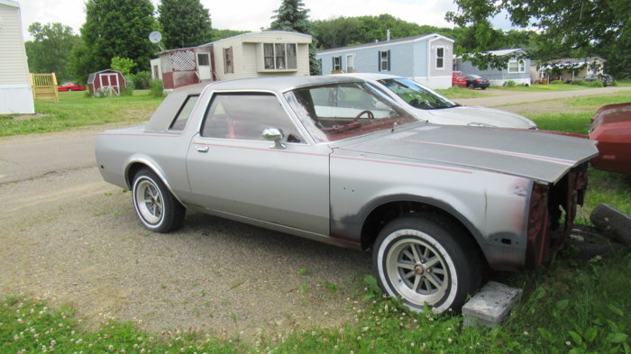

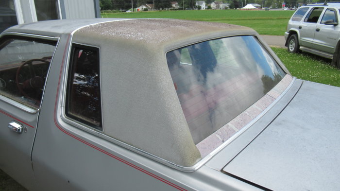

hi folks,im an old fart whos gotten himself into a bit of trouble here with this car.
its a 1980 lebaron salon coupe thats grey? silver?
faded is a good word,with red interior.
it has original wheels and seems like most of the parts were there Except under the hood is Bare,no nothing.

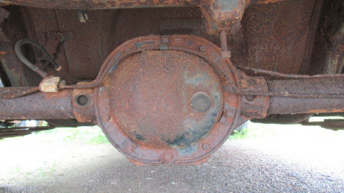

it came originally with a slant 6 auto trans,and im not real sure what rearend this is.
plus this thing has what looks to be brand new bushings/body mounts and the entire k frame is new or completely refurbed,im not sure which,but it looks pristine/newish.

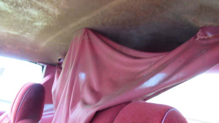

the body seems? good and the interior is mostly Really nice except for the headliner.
i was doing a cleanout job for a lady when i saw this car sitting in the trailer park and figured why not ask?
an amazingly low wad of cash later and its now sitting in line with the rest of the herd.
yes,the bumpers front nosepiece/grill and rear tailights and bumper were all in storage there and in Vcg as well.
looks like someone was getting ready to paint the car the underhood area is done already.
however,im kinda not up to speed at all with this odd torsion bar setup on these cars.
looks like they made more space but the steering linkage runs across the rear instead of the front of the engine bay.
im gonna try and post some pics,
and id appreciate you fellas sharing some thoughts on what i should do with this roller?
as in what would you do with it? am i wasting my time?
my thoughts were originally to stick the 318 magnum in and get a big cam with a good vertor and some 373 gears and go have fun blowing peoples doors off with it.
i dont think anyone would see this thing coming.
i do have an la 360 rebuilt but with truck pan and mounts and a 727
i also have a 318 magnum,same thing,
truck pan and mounts And that would need a magnum carbed intake.
View attachment 35439 View attachment 35440 View attachment 35441 View attachment 35442 View attachment 35443 View attachment 35444 View attachment 35445
We'll need a photo of the front header panel to confirm, but there's a good chance this car is an LS. LeBaron's answer to a Mirada CMX. All the sport looking bits, but as you've found, it could be had with any engine offered. Firm Feel is the place to go to improve the car's handling. Poly bushings on the sway bar, another, but smaller bar on the back and some good KYB shocks will all work well. As for brakes, find yourself a '79 Cordoba with the 11.875" rotors, grab the caliper mount, swap it on to this car and with new rotors you'll have bigger front brakes. If you really want to up the brakes look for an `up to' 97 B100 van with an 8¼" rear axle, and grab the backing plates and some of the internal hardware bits and you can have 11" drums on the rear. Just watch that the right rear doesn't lock up early. You've already got 15" wheels, so just one size up on the first number, one size down on the second number and you've got a nice improvement in the footprints.

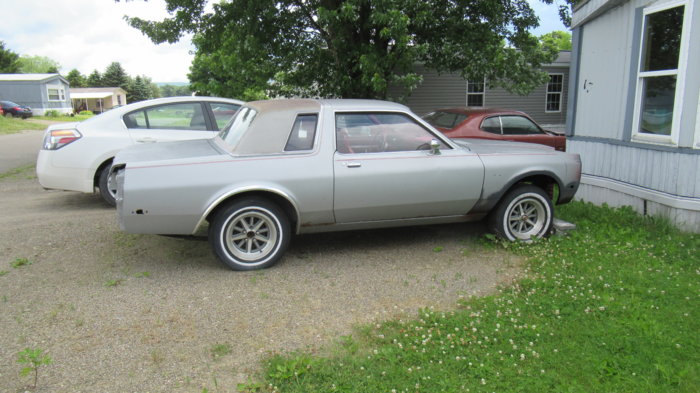

phase 2
style of wheels and hood scoop determined.
painter located,waiting for time to get estimate.
blaster located,waiting for appt.
motor trans located,318 magnum with a518 trans.
need cam and any recommendations you have for this build.
convertor is 2800 stall.
rearend 8.8 with 3:73 gears.
only thing lacking now is leaf springs,a fuel setup and a wiring harness for the front of the car.
also,i Hate the way these bumpers stick out in the back a country mile off the body....
thats going to Need to be fixed.

This car is getting a new lease on life. Looks great.
You looking for a hydraulic flat tappet or hydraulic roller?
Oh yeah! That is starting to look great. Ruby red is a good choice for color. Was it originally red? I wondered because of the color of the engine compartment. Those wheels are great and that roof line is fantastic! This will be an interesting project to follow! ;)
