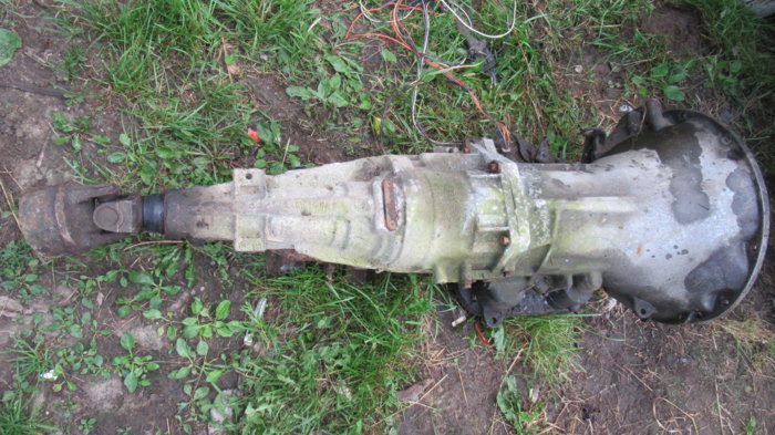

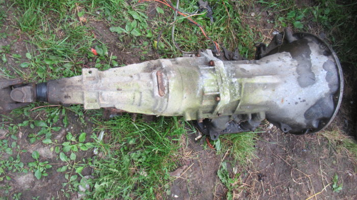

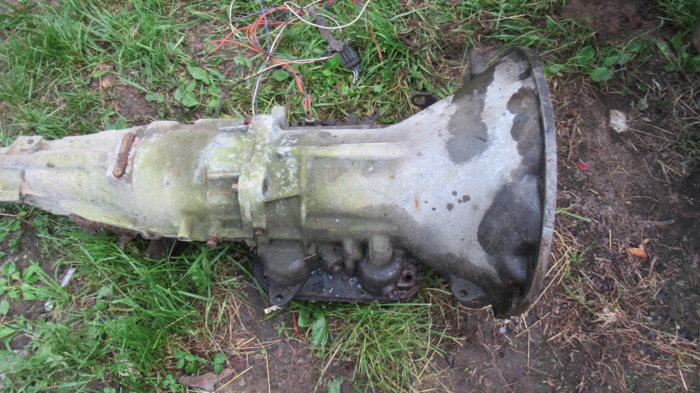

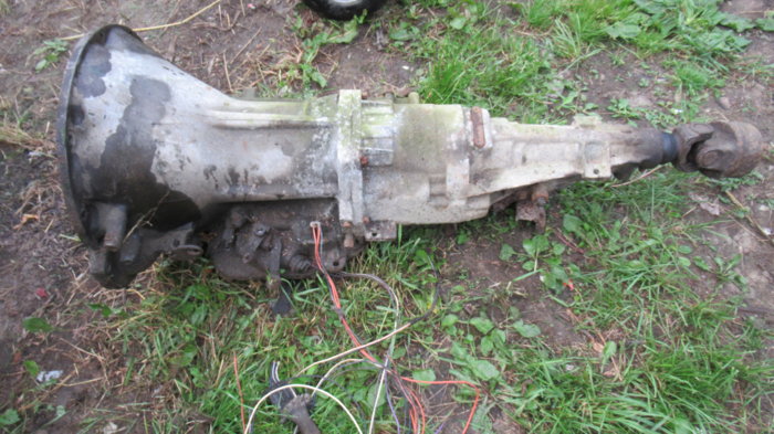

transmission turned out to be a a500,904 variant.
think it came out of a dakota,it should be fine yes?

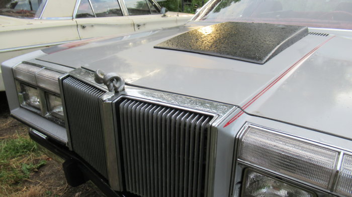

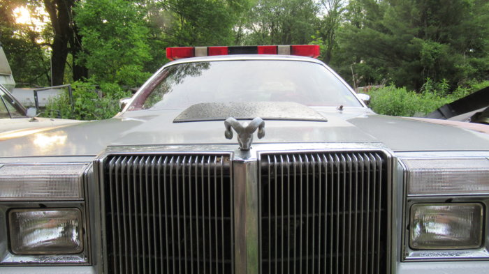

and i found this old rams head hood ornament today so i messed with it a bit too.

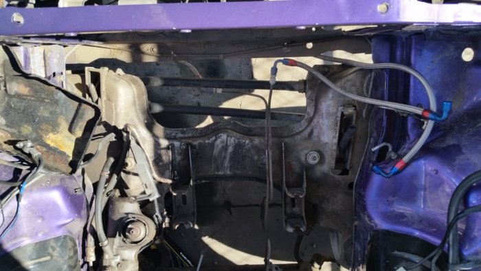

I am not completely sure how much the F and M cars share, but here is a picture of the K frame from my Aspen for comparison.

can someone give me tips and advice on the install of this transmission?
i see theres a huge pinch weld going across the roof of my tunnel > should i cut that off?

To get that 500/518 to fit you need to cutout the cross-member that the transmission mount bolts to. Slice it on the inside of the bolt holes and drill out the spot welds.
Next that pinch weld you reference, while it doesn't interfere with the bell housing it will cause you grief reaching the bell housing bolts. You don't need to cut it out though. Just put a few slices in it, one at the top, and two on either side then pound it flush to the floor folding towards the engine bay.
You will need to make your own transmission mount. I've got plenty of photos I can post on these steps later (I'm at work right now).

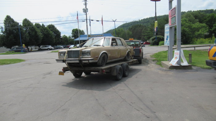

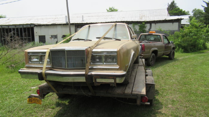

heres the parts car.
shout out if you see something You need
Besides the front bumper hood and engine/trans/wiring harness.
those i am keeping,
then im trading the car off for the big block motor and trans plus cash back to me.
so far i have 735 bucks in these 2 cars....a very good start indeed.
