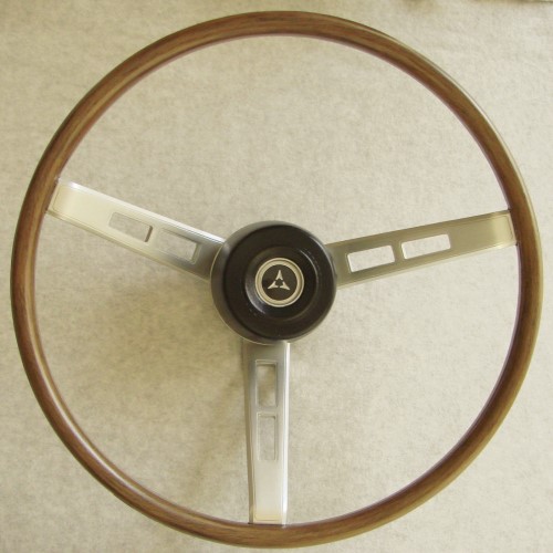

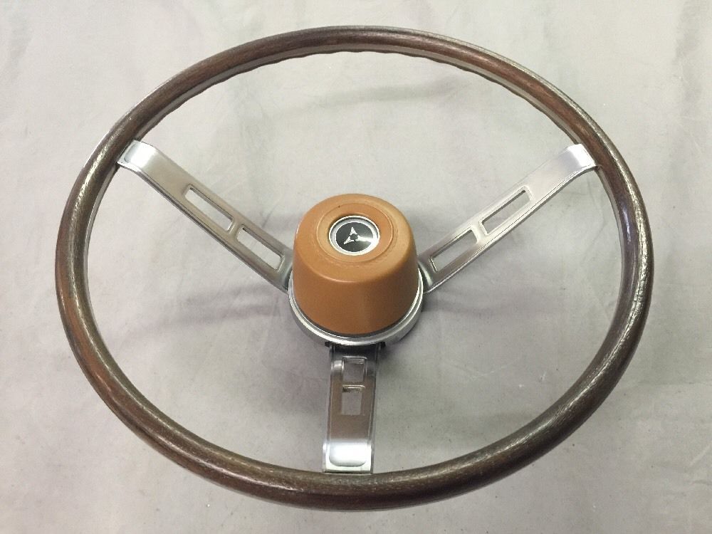

I installed a ’69 wood grain 3 spoke steering wheel on my ’87 Shelby Daytona, for a while. If fit fine – with one exception. The Daytona had (tilt column) has a wider diameter steering column (same upper half of column used on most M bodies). There was about a ¼” gap on both sides of steering wheel where you could see inside of steering column. I figured I could attach a painted plate on steering column (behind wheel) which would fix that problem – but decided against it. The 3 spoke wood grain wheel was much bigger (same offset) so I decided to remove it and put the smaller one back on.
I could turn much faster (more aggressive?) with the smaller wheel. That, and the leather wrapped wheel looked more in place in the Daytona.
Chrysler changed the steering columns in 1970 (same basic non-tilt column used during the 70’s), so there is a plastic trim on ’70 version of the (‘66? Through ’70) wood grain steering wheels that fills the gap on the ’70 column (which is wider than ’69 down columns).

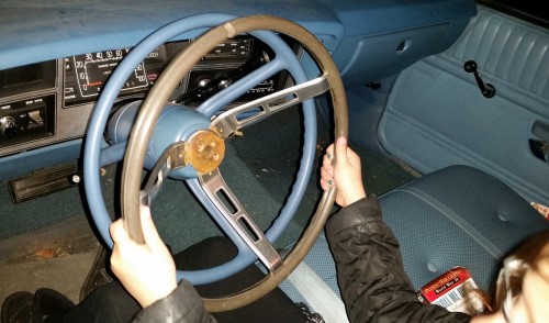

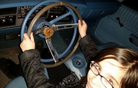

The wood grained wheel is still hanging in my garage, and it will fit in place on my ’77 Volare wagon (non-tilt steering – small diameter column) with only one disadvantage. I’m not sure I can get my wide behind in the car with that wheel on, without tilt steering . . .
My kids want me to keep existing wheel in place.
--- Post updated ---
The (‘70) wood grain steering wheel (pictured) is 16" in diameter.
The steering wheel in my Blue ‘77 Volare (also pictured) is also 16" in diameter.
