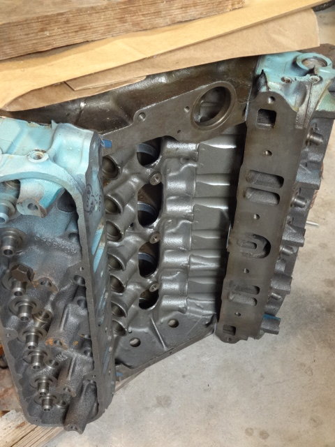

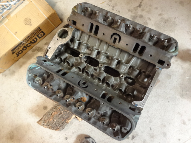

    If youd like to step up to a dippy like roller motor ive a machined block, new mopar heads that I cant seem to give them away either.
    Look at page 5 and 6 here. 350 Hp 318?
    Here is the machined roller block ready to build and brand new mopar heads.... Ive new mopar roller lifters, spyders, dog bones,... Id dump all for $500 or better and just the bore, hone and hot tank was close to $300.
