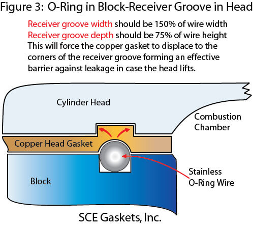

Head gaskets are a concern.
Back in the day we didn’t have MLS gaskets or Cometics.
I run 6PSI of Boost and upto a 150 shot of N2O.
I also have a copper head gasket with my heads O-Ringed and receiver grooves cut in the block.
This setup never fails...

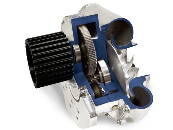

The Pro Charger gets confused with a turbo, all the time. It looks like the intake side of a (large) turbocharger attached to a pulley and gear-reduction driven by the crankshaft. Gear-reduction is not the correct term, but I couldn’t recall what the gear-increasement term is.
Most of the “Street Outlaws” in the Oklahoma City area (if you watch TV) are using ProChargers ProCharger Self-contained Superchargers and Intercooled Supercharging Systems as well as either computer (ECM) upgrades if factory FI or digital fuel injection/ignition system if using an older car, so the computer can keep up with engine management.
The ProCharger system does needs a rather large intercooler to work properly (which means no A/C).
