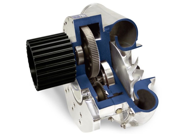

The Pro Charger gets confused with a turbo, all the time. It looks like the intake side of a (large) turbocharger attached to a pulley and gear-reduction driven by the crankshaft. Gear-reduction is not the correct term, but I couldn’t recall what the gear-increasement term is.
Most of the “Street Outlaws” in the Oklahoma City area (if you watch TV) are using ProChargers ProCharger Self-contained Superchargers and Intercooled Supercharging Systems as well as either computer (ECM) upgrades if factory FI or digital fuel injection/ignition system if using an older car, so the computer can keep up with engine management.
The ProCharger system does needs a rather large intercooler to work properly (which means no A/C).

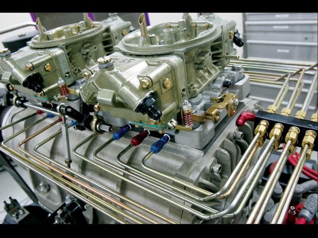

What I was once told was that they let a supercharger generate besides a boosted inlet pressure also generate a lot of heat. This is to allow the large amount of fuel (methanol) to evaporate before it is inhaled into the engine.
But this is done for the Roots type supercharger where there is no room for intercooler.

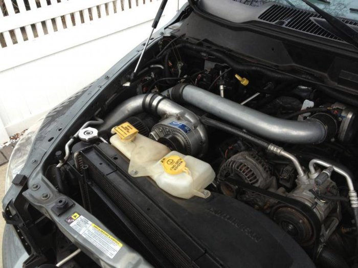

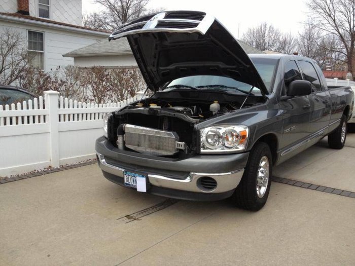

That wouldn’t be your pickup, would it?
If so, I would like to hear more about it (but maybe not in this thread – don’t want to hijack).
