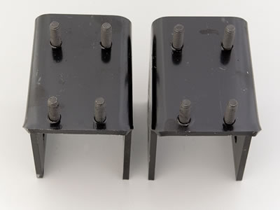

I'm not sure if these also fit f/m/j-body but, here are the hangers that are 2" longer to put SS springs in other than an A-body. The stud spacing and offset looks the same as an f/m/j.
Mopar Performance P4120080 Mopar Performance Hanger Kits | Summit Racing

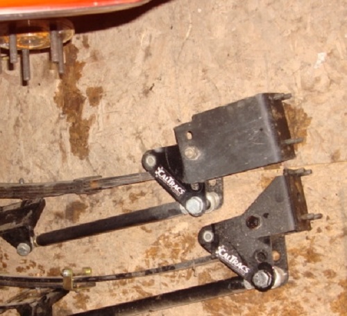

There's the bracket for an Fbody, the one on top.

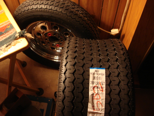

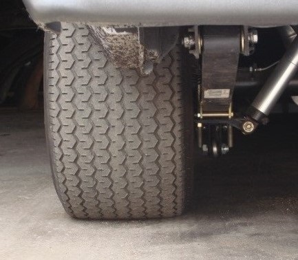

You should have no trouble with a tire like this fitting if done right. Moving the axle back one inch is the key and its simple and requires little in new parts. But a few.
3,132
797
What size tire is that and is it a Micky Thompson? That's what my street tire is, I can put the torqueflite in 3rd gear punch it and it will smoke the tires for as long you can keep it strait.
I didn't move the front hanger but did use the offset rears. If I remember correctly the springs are farthest apart in the rear.

I might be a bit confused. This is a shot from post # 7:
and from post # 8
For some reason I thought all FMJ's used the same front spring hanger, but @XfbodyX 's picture shows two completely different front spring hangers. I don't have access to a 2-door (or a J-body) currently.

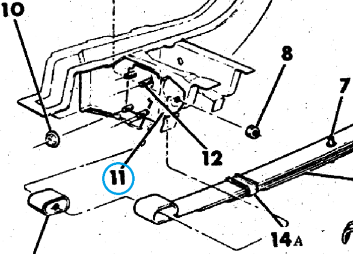

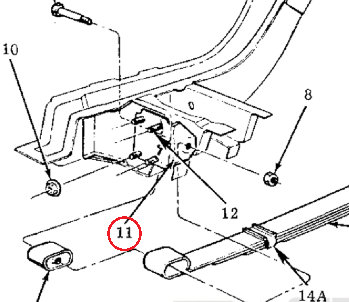

My '78 part manual shows (for F and M bodies):
I'm going to "assume" the "w/o Isolators" is the police version.
This is from my '80 parts manual for FMJ's:
A different part number but I would wager part number 4014753 and 4052205 is the same part.

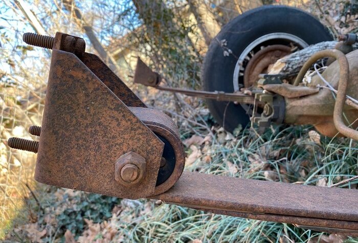

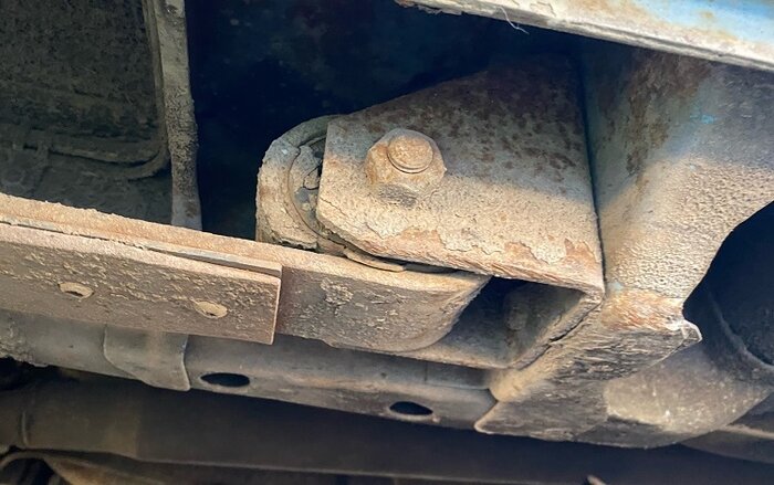

This a picture of the spring hanger from my '77 wagon:
It looks like the lower item of the front spring hanger (top picture, this post).

Don't quote me but, I thought the upper hanger in the pic was an aftermarket part to use SS springs in an f-body, unless I misread something. Parts catalog shows all H,N,F,G use the same hanger, unlike B-body which is different 2dr to 4dr.

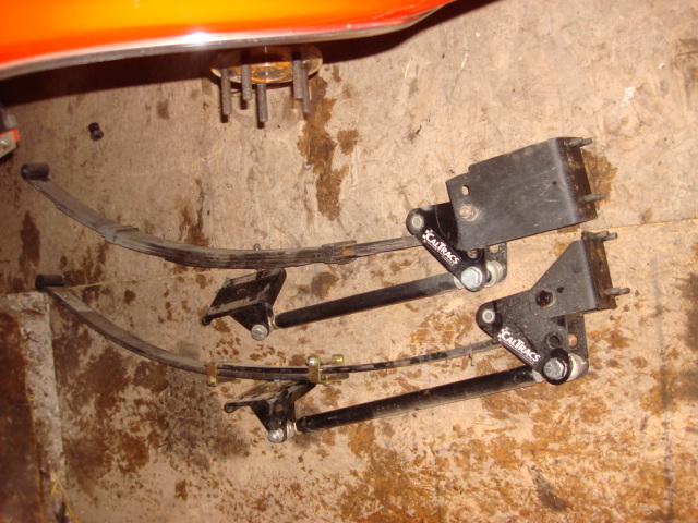

Sorry bud for not explaining more, the top is a SS spring box, the lower is a oem FMJ type.
Id ask the op why SS springs when there are other options some consider much better. The reason they say caltracks do not work well with SS springs and I know he didnt say he had them but its the short front spring segment, the caltract system for the F-s is one of the best you can get on a mopar due to the front spring segment being so long.
But if SS springs are whats on the plate they are great in a different way and work and give that big jacked up rear look.

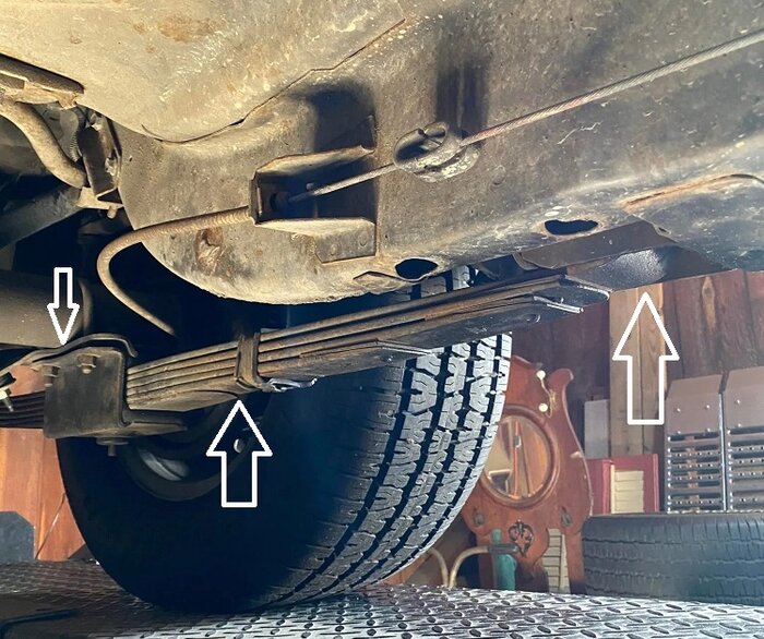

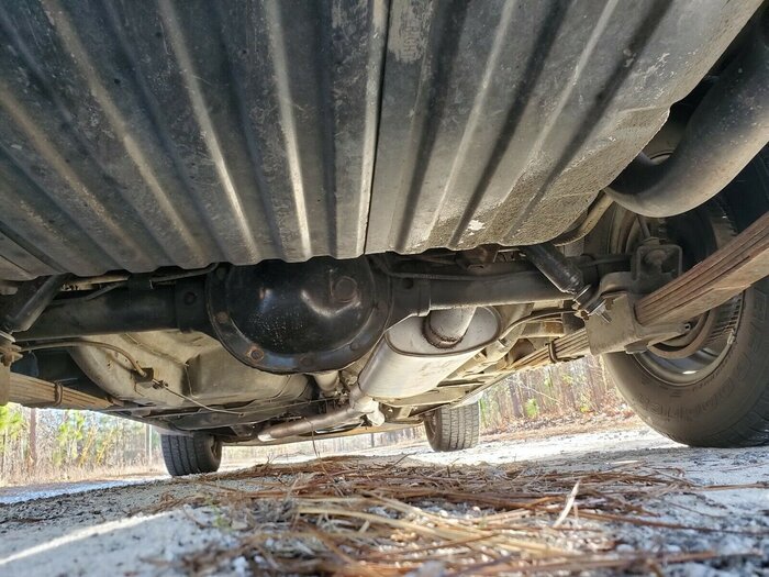

There is a post for a SC currently for sale elsewhere and here are some pictures from it:
It would appear, with that (new to me) information, that this car might also have the SS springs and longer spring hangers. This leaf spring appears to have 6-leafs. It also appears the factory (5-leaf) lower ISO spring clamp is not touching the top clamp by the thickness of one leaf.
Note: I'm not picking on this car or the owner - just an observation when I was looking over his car (I happen to like this car...).

I know that car a bit, I think those are just added some sort of HD springs and clearly not SS.

Bud ya ever notice that lil support strap on the body under where the front spring hanger mounts?
Coupes do not have them, one of my stealth mods is to make that strap out of flat stock ant mig it all the way from the frame to the outer body panel, that and backing plates on the hanger itself to spread the load.

X how did the SS springs and Caltracks work together? If I remember correctly the SS springs front half is only 22 inches long...
