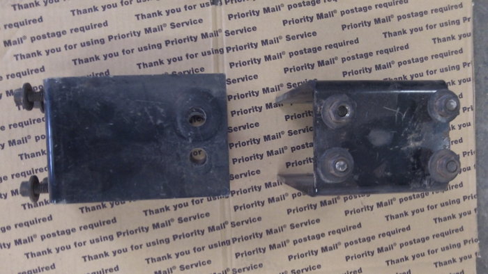

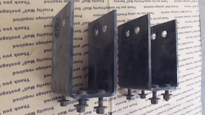

dont know the pn but are these them?
were from a 68 or 69 B body if memory serves...attached to super stock springs

Should be about 6" from hole to mounting surface for a Fbody.
These are for 22" front segment springs, I believe SS springs are 55.5" long with a 22" front.

F Body Deconstructor Jim – Your hangers may or might not fit for his application. One detail that is important is the ’68-70 Dodge B-body is 1” different length than the Plymouth B-body is, in that time frame. The Springs are the same, but the hangers are “brand specific”.
The propeller shaft is also 1” different length between Dodge and Plymouth B-bodies, as well.

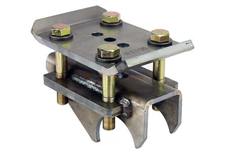

Interesting perch kit, but it looks to be for a truck application with springs on top of the axle housing. No provisions for a shock mounting plate or conventional U-bolts.
Even if it could be flipped & somehow modified further, there are lots of factors to consider when you start mixing parts around, including the back length of the leaf springs, proper final shackle angle & tire-to-fender clearance.
3,171
818
You can't use conventional U bolts if you're adjusting axle location on springs.
And yes it says it's for 4x4.
