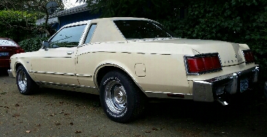

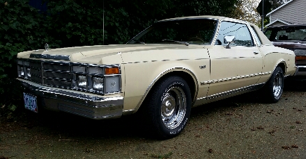

235/60s and 255/60s on 15x7s.
I haven't gotten down to measuring yet, but I was thinking of going to a 15x8 on the rear when I replace these chrome things. Backspacing will likely have to be custom.
If I have 4" of bs now (an educated guess), and add an inch of wheel width and split the difference with 4.5" of bs I think they'll tuck up nicely.... YMMV, but I think the dimensions are the same between the two body styles.

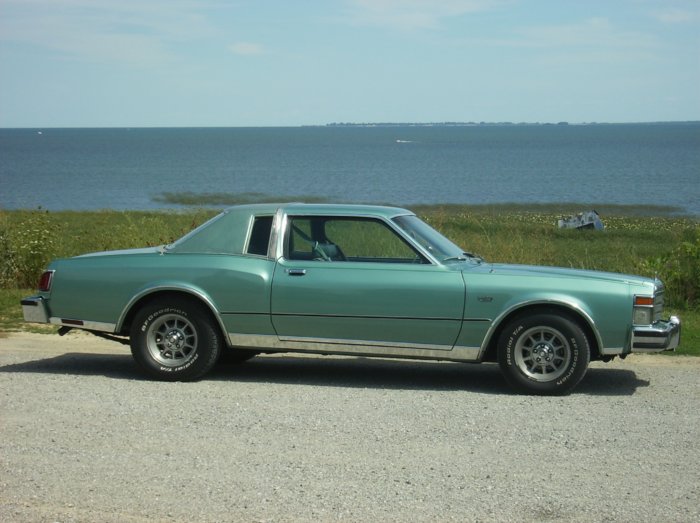

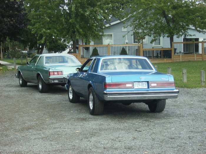

I just put Cooper 275/60-15 on the back of the J. Pretty sure a 295 will fit with stock 15x7 rims and no effort. Id guess 9 1/2" tread width. No noticeable trade off in power, rpm, top speed coming off @27.25 tall 215/70s. These are @ 29 - 29.25 in. They fit beautiful. I prefer the Remington's but the Coopers are made in USA, had no miles and where a very good deal. Not to imply the Remintons are foreign, I believe Coker makes them in Tn or Ky.

I have 275/60/15 rears
What size and backspacing are your wheels? They look very tucked-in, not oversized at all. I'm guessing 15x7... ?
I think I might rotate the 255s to the front (on 15x7s) and put 275s on the rear (15x8s w 4.5" of bs). That's the same size tires I had on my '69 300 hardtop... that thing was 20 feet long! A real land-yacht.
I had 16x8s w 265/60 16 BFGs (no longer available... I got the last two in the country, but that's a different story) w custom 4 5/8" bs on the back of my Cordoba and still had to roll the fender lips... that's why so many questions.
Eventually I'll have to get on the ground w a plumb-bob, straightedge, and a tape measure unless... you've already done that tedious job and are willing to share what you learned :rolleyes:

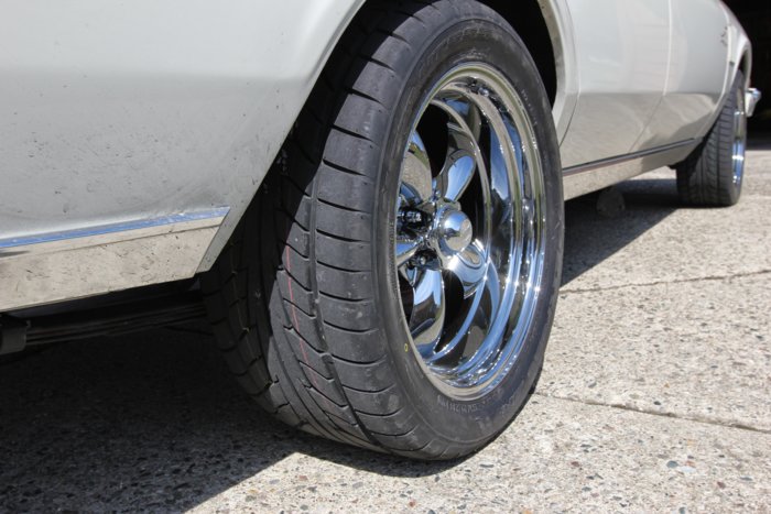

Are you still w a 15" rim, or did you go up?
The tire looks like maybe a Nitto 555-series... ? I can't read the sidewall on my tiny phone screen.
Nitto 555 285-18-40 on 9.5" wide rims. It just misses the lip of the wheel well and rubs a little on the inner fender when the back end squats. Probably the absolute max you can run without going to a smaller diameter tire and even then it won't get you much. Plenty of room between the rim and the spring though if you wanted to mini tub an F/J/M. Could probably get 325's under there.
Wow... that's a lotta tire. If I could find aftermarket cop wheels (or similar) in +1 or 2 I'd gladly give em a go... I've got nuthin against larger diameter/lower profile rims and tires.
Do you remember what your backspacing on the 9.5" wide rims is?
