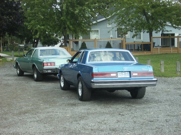

Hears mine with a 80 Dip with the same size rears, but the Dip has 4 inch backspace
That 80 almost makes me wish I'd kept looking... almost. It's a real toss-up for me which body style I like better. The 77-79s are so sculpted but the 80-up just looks like business. Both are great-looking cars, and your picture and info tells me exactly what I needed to know.

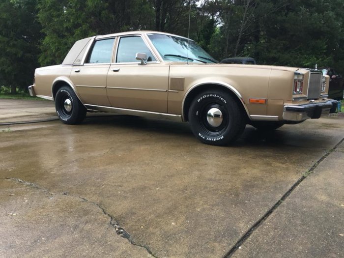

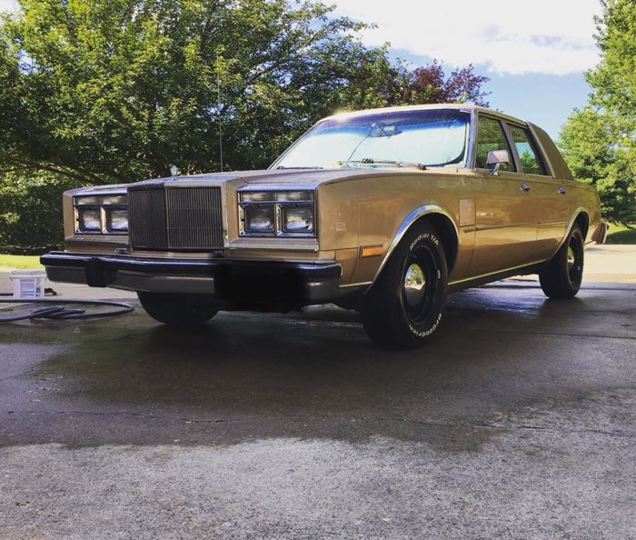

Finally able to update this thread on what I chose:
Did a 215/70/15 on the front and a 225/70/15 on the back. Chose to go more mild, but I've gotten plenty of positive comments at shows, and I'm really happy with how it turned out, and that's what matters, right?
They fill up the wheelwells very nicely... better than I would have expected by just the numbers... very cool.
Even more important than tire size is your wheel measurements... what size and backspacing did you go with?
Looking at your 5A is proof that a guy (or gal) doesn't always have to stuff the biggest tire possible under a car to make it look cool... an affliction I (and my bank account) suffer from.
Classy, cool, and practical, I'm diggin' it big time. Nice job, beautiful car... I love the color, it's (the gold) on my short list when the repaint happens.
