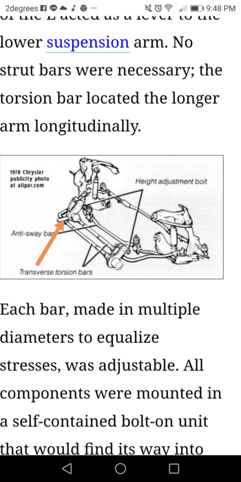

Ok I need to replace this bush, see orange arrow, what's best way to do it? Seems a lot of weight there on that part, had bolts undone and could not separate bracket.

The bracket is held together by 4 spot welds. You will have to remove the torsion bars from the car to drill them out, a spot weld cutter might be easier than a drill bit. I recommend using urethane replacements since they are split for easier installation and they can be greased.

Yes, they are spot welded together. Good luck getting them apart without damaging one side or the other. I`m pretty sure I may have a couple good used ones and maybe one NOS kit but I would have to check.

I just cut the bloody thing off with angle grinder, drill the welds out and might weld the thing together again, no mucking around.

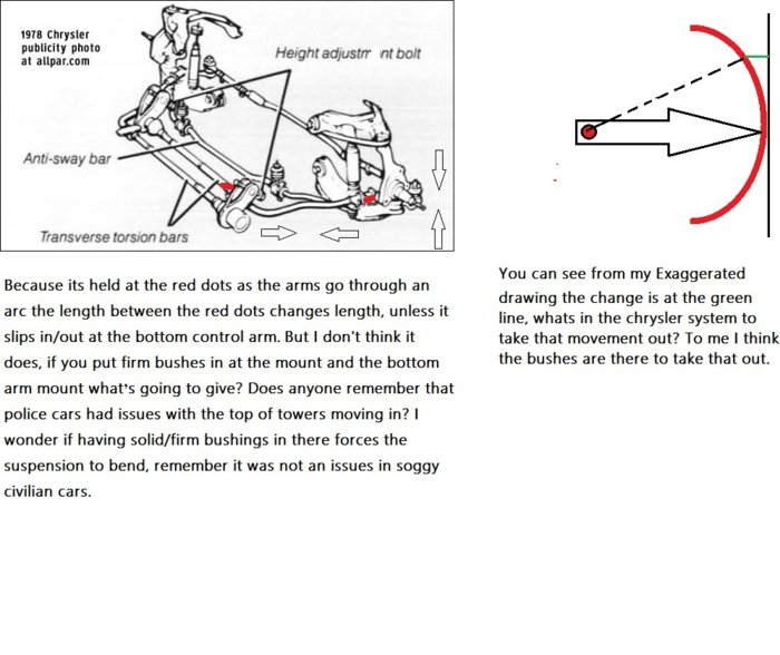

Have you guys ever looked at the suspension and what is wrong with it?? The torsion bar is connected to the bottom of the arm, then come out towards front of the car where it is connected with this bushing, this is a pivot point, as the wheel goes up and down through and arc that torsion bar is relying on the play in the bushes to move up and down. Its a poor design! the cars with parallel bars never has this problem. Anyone like to help me out if I am right or wrong here, I am no suspension expert.

Personally, I like the rubber bushings for the torsion bar. I agree that the poly just don`t seem work like the OEM was intended. Problem is nobody has them. The NOS ones I found the rubber was too hard and they split when installing. The poly ones seem to look loose after use unlike the OEM rubber.

The stock system works because the rubber has a lot of compliance.
The outboard ends of the bars are inserted into the bushings like sockets. As the suspension cycles the rubber gets stretche this way and that. Simultaneously the bar-bushings get squashed, And the LCA bushing get squashed as the LCA moves forward and back. So everything is doing the jello-jiggler dance.
A-bodies do the came thing, minus the T-bars moving. But now it's the strutrod pushing and pulling the LCA around.
I've never put polys in an FMJ, on account of I haven't owned but a few, and never considered them for performance, as I always simultaneously had an A-body for that. I think my 1980 Volare is getting close to half a million clicks, and still on the oem bushings.

Do the Firm Feel Torsion bars use urethane or rubber (on both ends)?
Urethane will work great for the K-frame (pivot) bushings – but I wonder if urethane is “too hard” for the control arm connection point.
Somewhat unrelated, the lower control arm will twist in place with the torsion bar attached – if using rubber lower control arm bushings (the other end is a ball joint).
The item of interest is the outer edge of lower control arm will be more forward or more back through the range of up/down motion – which that will affect Caster angle (of alignment). Personally, I don’t think it will affect enough to cause any noticeable issues.
