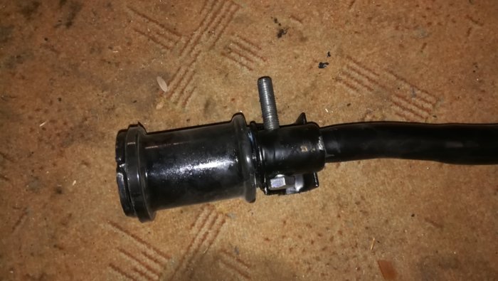

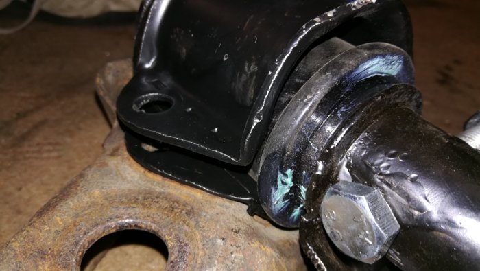

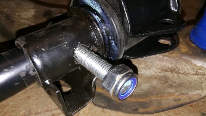

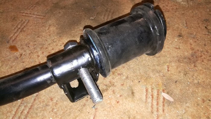

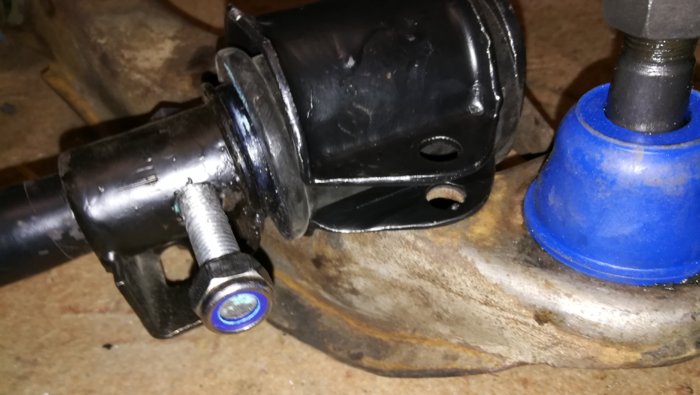

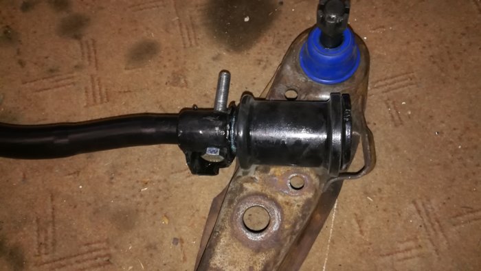

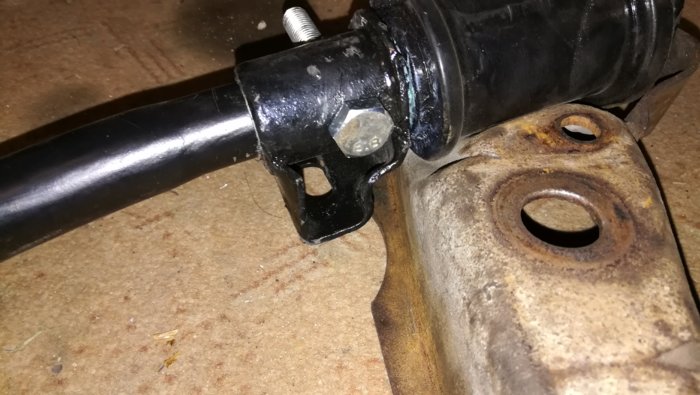

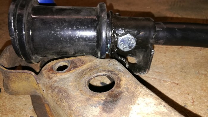

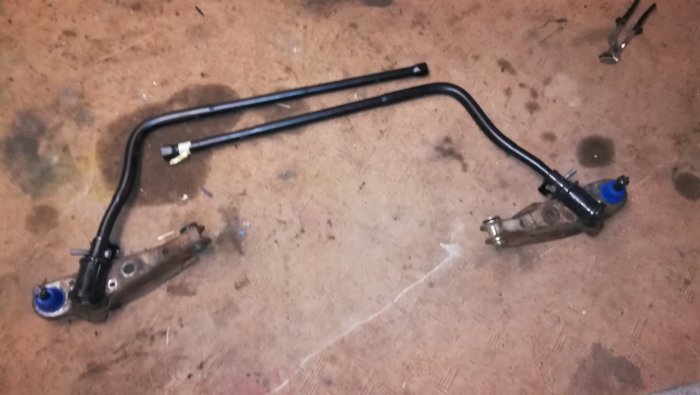

So back to the original topic: Today we were able to reassemble both torsion bars. We heated the parts and puttet it back together (pictures below). I think it will be enough to last for a while... which it better does because of the high effort.:rolleyes::mad:
So many greetings to all of you!

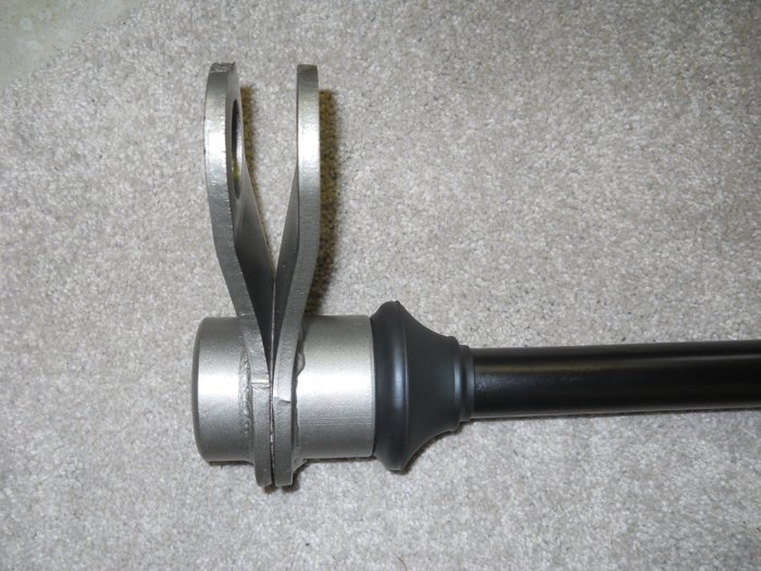

You should have put on the boots for the torsion bar before installing the bushings. The boots can be hard to get over the hex.
Do you mean the central socket? The parts I got from polybushings.com are cut lengthwise, so it should be possible to pull them over the rod and not over the end piece, I hope.

no, the boot that goes on the other end of the torsion bar where it has grease in the socket. the adjuster end of the bar.
Ah now I understood what you meant! Yeah that could get tough, but they should fit over the end. When I removed it, it fitted without trouble. If it won't fit i'm sure I'll remember your words :oops:

If you are reusing the old ones then you probably are ok but the firm feel reproduction ones are real tight. I have a pair if the smaller A body ones coming from DMT and I will see if they stretch enough to work. The F body and earlier C body cars have a bigger end for the large opening of the seal compared to the others.

OK, for everyone`s info. I received the DMT t bar boots today. They are very tight on the bigger end but they slide on the the t bar fairly easy with some soapy water. Now if you are trying to put them over the hex end then you may run into problems because it didn`t seem like it wanted to stretch enough to go over. I will have some Firm Feel Boots for sale since i ordered them too and won`t need them. Plus the Firm Feel boot is poly and I wanted the OEM look. The guy at Firm Feel did say I would have a problem trying to get the boot over the hex end. I told him I had the bars apart and he said they should fit fine that way.

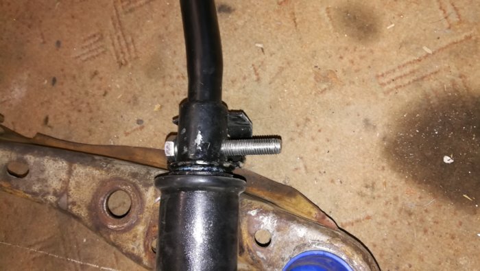

Volare77, about the bolt that holds the end bushing on. This is the one that came with my end kit (aftermarket from NAPA a few years ago), didn't need to cut any extra length off.
