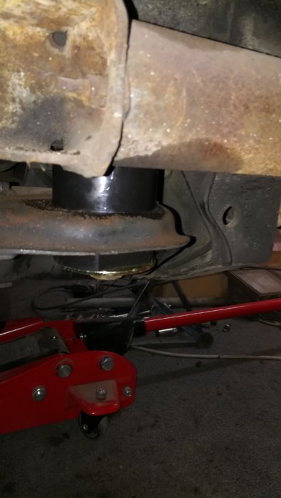

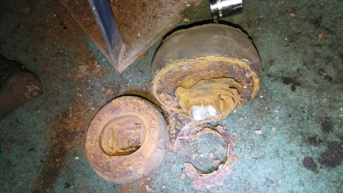

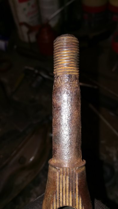

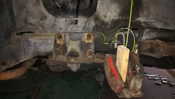

Thank you very much for the lively discussion. Last time working we did a few more things.

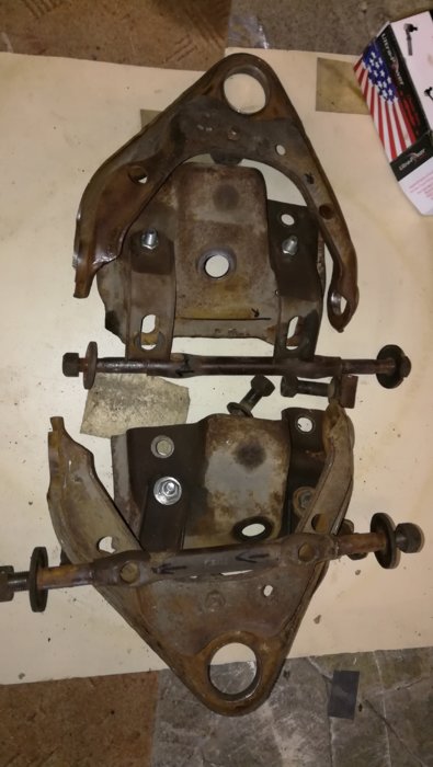

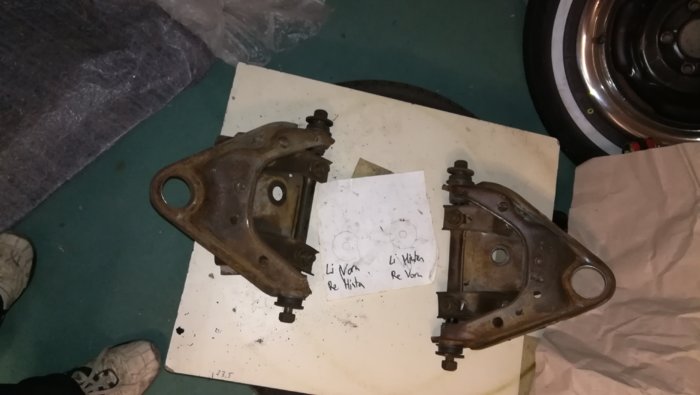

Since my delivery of the K-frame mounts will take some time, we decided to remove the upper control arms and also replace the bushings. I ordered them a year ago from Rock Auto. Actually we wanted to postpone this work until the TÜV has checked my car. But since the actions with the torsion bars we are so far from getting it done that it doesn't matter anymore.
Enclosed the photos of the work...

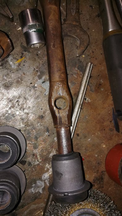

Volare77, about the bolt that holds the end bushing on. This is the one that came with my end kit (aftermarket from NAPA a few years ago), didn't need to cut any extra length off.
Aspen 79, It took some searching but i found some grade 8 bolts with the perfect amount thread so practically none was inside the t bar. I cut the excess thread off that was sticking out..

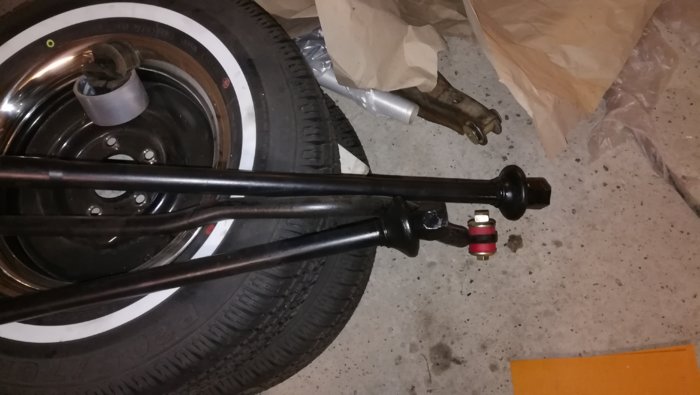

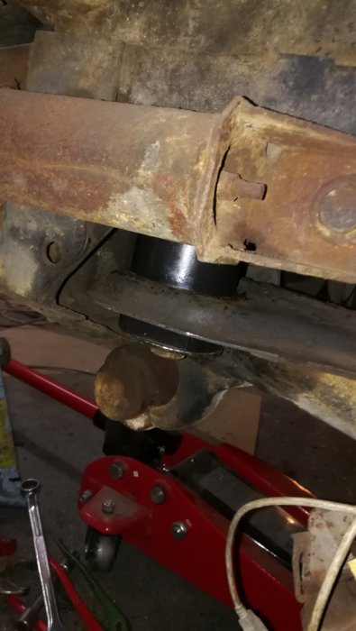

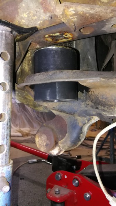

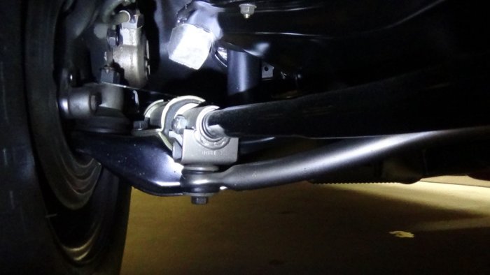

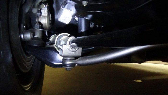

Coming to my last works on the front suspension. We changed the k-frame bushings and renewed the upper control-arm-bushings. AND I was abled to pull the shoes ower the torsion bars. (See pictures below)
Due to some job issues I won't be able to put the suspension all together before christmas. But I am optimistic that the work could be finished in January 2019.
