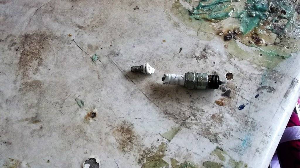

Ok so I got the big idea to change spark plugs and cap-n-rotor .. now I'm not saying I didn't touch this plug .. and I did put the socket on before the ratchet (tight fit with the alt. in the way).. but as soon as I put the ratchet on .. ping ... went through the rest of the job easy enough .. started the car and idles smooth now, might of been cracked all along ??.. and here I was blaming the carb all this time .. plugs all looked good to me (2nd pic.) the plug wires ? .. well the ones on the car actually look better than the replacements .. so I left them on.

Thanks AJ/ .. I did try to use a swivel on the front one .. maybe the socket wasn't on properly .. I ended up using a 1/4" drive with a 3/8" adapter and with that combo I cleared the alt. easily.
7,323
2,971
I 2nd the socket broke the insulator theory. What I'd guess is, one of the plugs has a crack in the porcelain internally where it's not visible and causing an arc to ground. At work I've changed plugs (or just the plug on the suspect cylinder) to verify if the plug is the cause or isn't. The times it was the causal part, couldn't see a darn thing wrong with the one I took out.

I'll agree ... was funny tho .. never even had a chance to bear down on it .. broke as soon as the ratchet got put on .. I did have to push tho .. I struggled till the smaller tools came in ...

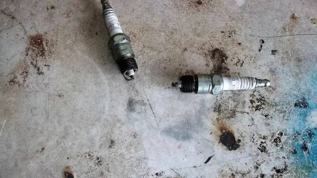

Many years ago, I had a 95 Sunfire with a 2.2. It had a habit of suddenly running on three cylinders from time to time, just out of the blue. I drove it nice, cuz I had the Cuda to wail on. I isolated the faulty cylinder and swapped its nice-looking plug to another hole and sure enough the problem followed the plug.
So I popped a new plug in and carried on.
Some months passed by and it happened again.By now I had forgotten which hole had the first issue, so I again isolated the hole and popped in a new plug, and all was well. This time I noted the hole.
Then I had a real good look at the plug. Under a magnifying glass I found a longitudinal crack going up the insulator. Aha! I said. I wondered if the first plug had that same crack; so after scrounging around I found that first plug.And sure enough, it was cracked the same.
More time goes by. It happens again.Same hole.
I pulled the head off.It was pulling coolant into the chamber.I bought a new head. It never had that problem again.
The point of this story is;
Check your plug(s) for a cracked insulator, with a magnifier.A cracked insulator is usually associated with detonation. Detonation is bad. If you find a cracked one, you will need to do some more hunting.....
