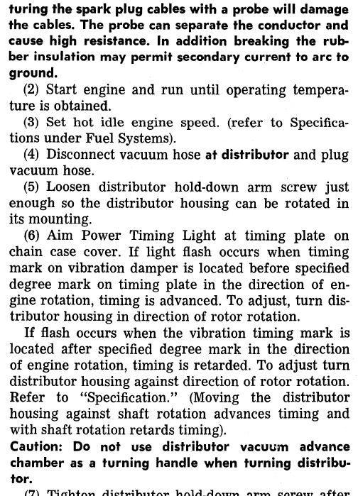

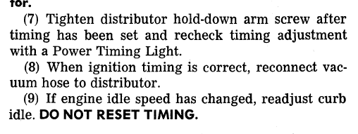

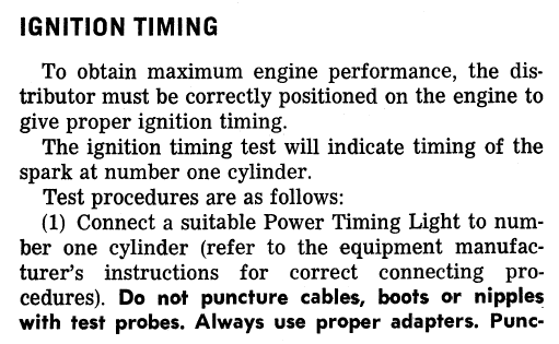

Instructions from my ’77 Service Manual.

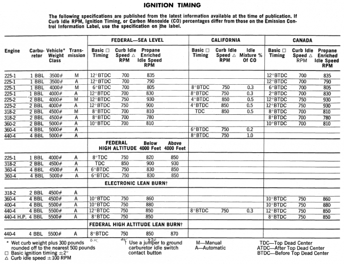

Specification page for all ’77 Autos.

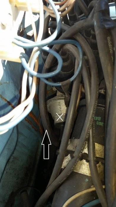

A picture from my ’77 wagon 318 for illustration purposes (providing you do not have Lean Burn).
The vacuum advance has a (small) white “X” on it and hose going to it is marked by white arrow. Just remove hose from the vacuum advance diaphragm, then plug hose (a golf tee, small screw, a stick or even someone’s finger (on edge of hose, not inside) works fine).
Note: this picture is standing at Right Front wheel looking towards the brake booster. if you have a /6, you would stand at same location but look down while bending over fender.
