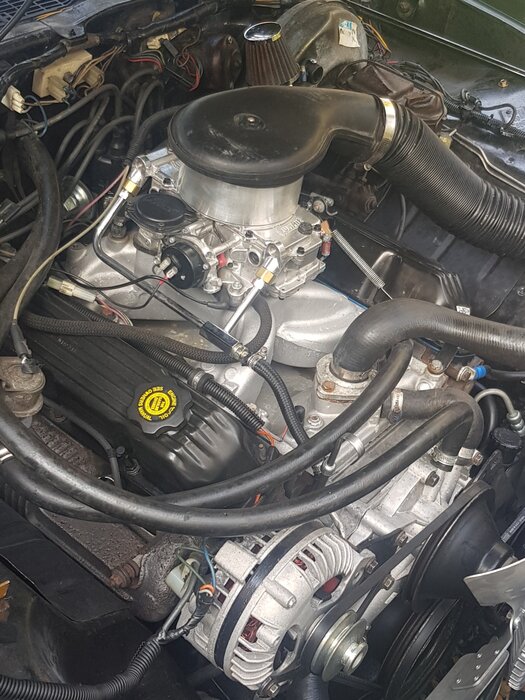

I got the Professional Products cross wind dual plane intake (#55026) on a 5.2 magnum.
For the price I got no complaints, but this is a stock Mag in an Aspen used mostly with a light right foot on sunny days.
My only regrets is that I didn't check the port matching and casting burrs i've seen mentioned in the reviews before installing it.
But it seems OK for my use.
Dont have the car here now for measurements, but I'm guessing 6-6,5 inch hood clearance from the intake.
Carb height is 3,25" + 3/8 base plate + 2" spacer + ~1" top hat
The pictures shows my setup. I used the magnum "top hat" with a 2" spacer and a remote air filter.
I later cut of about 1 inch of the spacer because the plastic top hat got some scratches after rubbing against the hood bracing.

What car is this on? I have an '89 Diplomat with an Air Gap intake and factory 4 barrel air cleaner and hood closes.
