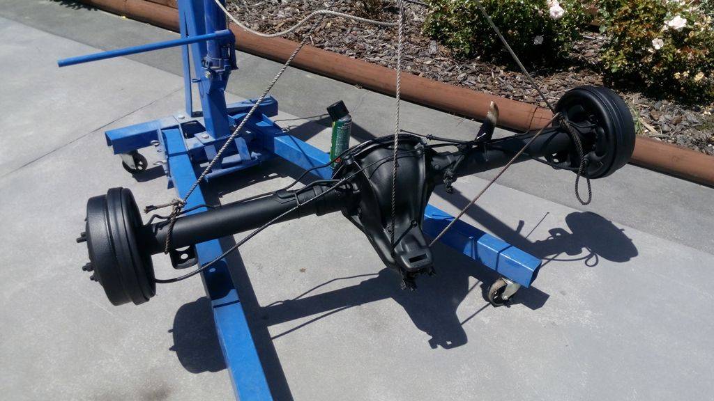

Hi Guys, see you have been busy on this post, I have ordered a cover with a filler in it from summit, should be in NZ in a few weeks. I got the rear end back from the sand blaster today and painted it all up in a special rust/chip resistant paint. What you think?

Looks Great!
The only thing I would do different is add 11" X 2 1/2" Brakes and air cooled drums.
But that can all come later if you even wanted to do that.
