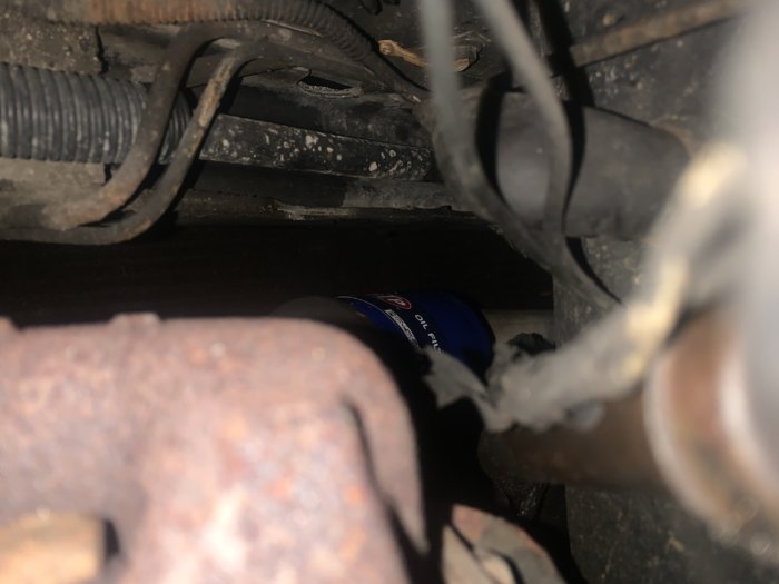

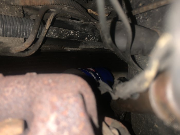

True about to change the oil with brad penn 10w30 tho I gotta find the right oil filter I want to find a mopar one but my 5th ave has that dopy 90* adapter I don’t even know if I take it off could I just use the short n stumpy one right on the side of the block atm I got a cheap stp on it for now And the condensation problem I was having was because I had such a low temp thermostat in there I only had 160° thermostat and now that I put on the stock 195° thermostat the condensation went away
I have the same filter adapter and long tube headers in the way also. I’ve been using the K&N gold filters, they have a thicker can than most filters and a hex nut welded onto the bottom so, it’s really easy to get to from underneath the car with a ratchet (I think 9/16 socket) and extension. You spend more for the K&N name but, the quality of the silver and gold filters is top notch. Silver filters are meant for garage beauties that only need annual oil changes and have a high micron element. Gold filters are meant for high volume oil flow and regular oil change intervals.

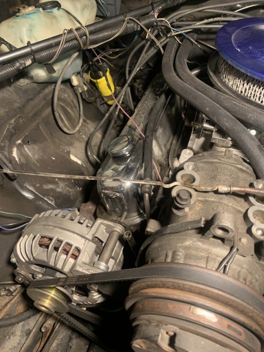

I’d love to get headders but before I do that I gotta pull the old girls heart n rebuild it because it’s got a nasty oil leak from the rear main seal and the oil pan is gettin rather rusty along with worn out valve guide seals to boot in the spring I MIGHT install a holly sniper efi system but the motor itself is tired I’ll post a short vid once I get a chance of it firing yp
