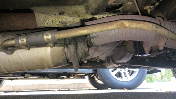

for context, my catalytic converter was stolen before i got the car so maybe 2018-19. a new one was put on there, then in summer 2023 the welding for that came loose and it hung loose under the car for about a month. i got it welded back on and well now i guess its broken. should i just get this thing straight piped? Maryland doesn't require emissions for cars with historic tags but at the same time i feel kinda bad letting out all those pollutants into the environment. but i did love the noise when my cat was hanging loose.

for context, my catalytic converter was stolen before i got the car so maybe 2018-19. a new one was put on there, then in summer 2023 the welding for that came loose and it hung loose under the car for about a month. i got it welded back on and well now i guess its broken. should i just get this thing straight piped? Maryland doesn't require emissions for cars with historic tags but at the same time i feel kinda bad letting out all those pollutants into the environment. but i did love the noise when my cat was hanging loose.View attachment 52134
That looks more like the flex pipe broke. That's more like a DIY type of repair. A shop shouldn't have hadva problem using normal exhaust pipe there.

Yes, that was an alley repair. It would have been pretty standard to hog the cat out with a long chisel and put standard exhaust pipe in there. It would last for years. As the gentleman mentioned, your exhaust fumes would smell

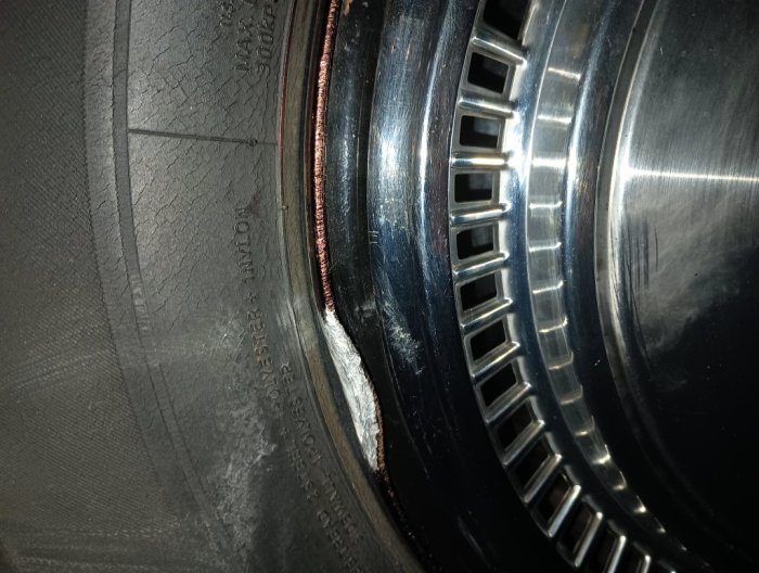

Soooo. i ran my car into a curb this night and bent the hell out of my rim. Prius wouldn't move at a stop sign even though no one was coming and instead of doing the smart thing of a friendly "beep" what do i do? mash the gas around him on a slick wet road. So the ass swung out and i thankfully prevented myself from ollieing on the concrete median but i then swung the other way right onto a curb, hubcaps flying. I'd been wanting to get rid of my civ rims anyways, so i guess its a good a time as any to ask. who makes the better police style rim? Classics Industries or Summit? always remember. its never worth getting mad on the road.
