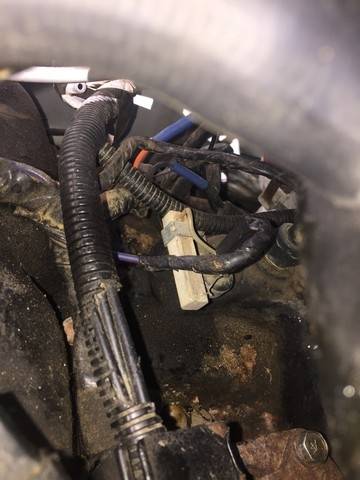

    Chewed through this
    The red and white line which was chewed this spring, was chewed again.
    The pink line going into the firewall box has some plastic chewed off and I see copper wire.

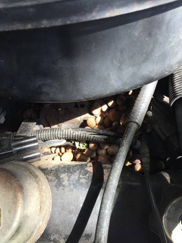

    There was this:
    About 100 acorns on top of the engine under the air handler.
    And you can see some of the wires are chewed at:
    This is under the air handler looking from the passenger side towards the middle of the engine bay.
    I spliced the broken wire again.
    I have not fixed any other wires. I removed all the acorns.

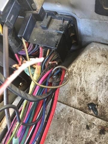

    I removed the brown (sol) wire from the starter relay.
    Starter relay small box with black funky shaped plugs in it on driver side firewall close to fender.
    Unthreaded the wire to get access to it.
    Put a probe wire in it.
    Had brother sit in the car and turn the key to on (courtesy lights on, bell dinging cause door is open).
    Placed the other end of the wire on the positive terminal of the battery.
    A couple of small sparks.
    Lights dimmed inside the car.
    I heard a very faint click when I'd touch the battery (did it 3 times).
    Did not start.
    Brown wire has not been chewed by rats nor spliced.

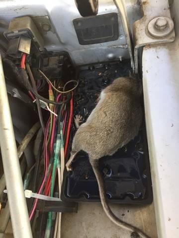

    So far this fall the cats have brought me 4 large rats.
    I've glue trapped two young ones and this older one in the Chrysler.
    Something about the wiring in this car they really love.

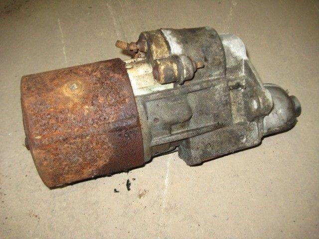

    The older style looks like

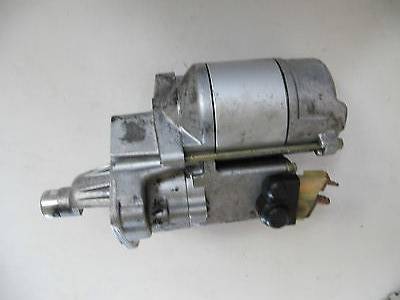

    The mini starter looks like
