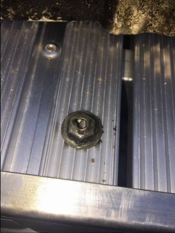

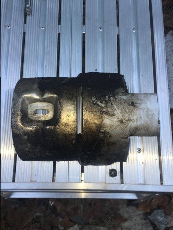

I still don't have the starter out, however; I do have the heat shield off.
(and the crowd goes wild!!!!)
The heat shield is held on by 1 bolt and 2 'fake' nuts... I have no idea what these jewels are called.
I looks like a nut but its just a cover that presses over the end of a stud.
I should have used a screwdriver under the edge and 'encouraged' it to move back off.
But since I thought it was a nut, I spent an inordinate amount of time looking for the 'correct' size of socket or box wrench. There is no match. Its a little too large or a little too small, a little too rounded off. Wow did I get frustrated.
I finally used a 3/8 inch long socket to rotate it 1/4 turn before it started to just rotate and not move. Pulled the socket off and used my fingers to encourage it off.
Now I have the heat shield off:

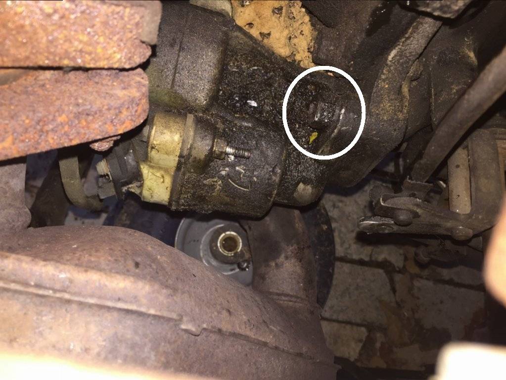

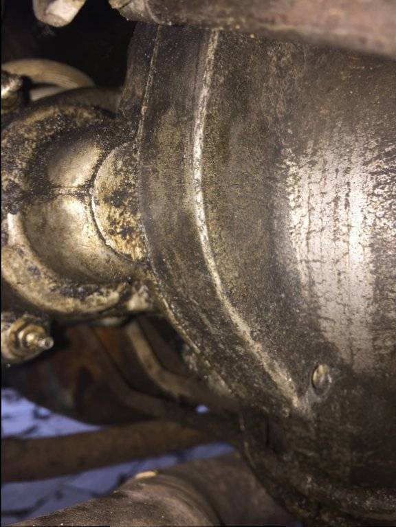

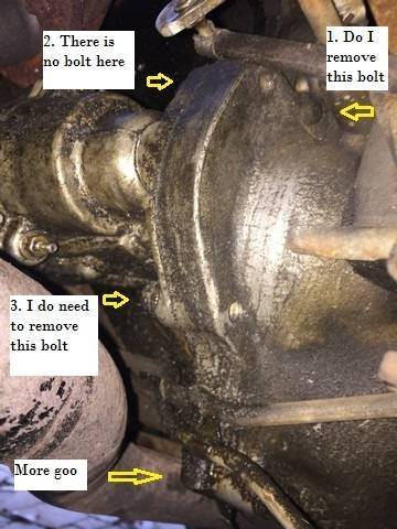

I cannot get the 5/8 nut to break loose.
I'll try more PB Blaster tomorrow and an impact wrench if I can get access to it.
I have a couple concerns.

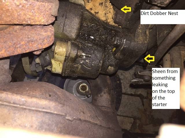

1. The starter is completely rusted on the backend, I expected something like that. But the whole thing has a fluid leaked all over it.
Its not oil (not black). Not transmission fluid (not red).
It certainly looks like something is leaking since this thing is completely coated. And if you look in the previous post, its all over the heat shield as well.
Yes I have discovered more dirt dobber nests--like a never-ending, creepy treasure hunt.
2. My second question is about bolts.
I think I have a missing bolt at the top.
There appears to be a big bolt at the bottom. This is a 5/8 head which I cannot break loose.
Anyhow, I'm still amazed its taking me so long to do something that seems so simple.
Course, I also spent 4 hours working on the pressure tank and water lines. I need a new pump house, stronger hands, and smaller pipe wrenches.
Well ... I can't help with the main problem ... those aluminium nuts is something we called "speed nuts" ... just a way for the automakers to shave pennies, and yes they taper so it's iffy to get a socket on them just right ... sorry I'm no help with the rest of the project but, I read your posts, very informative.

1,492
That oily residue you refer to, is engine oil. A normal amount for time and miles (so nothing to be concerned with).
Giving the car a good bath helps beforehand, but won’t get rid of the oil entirely.

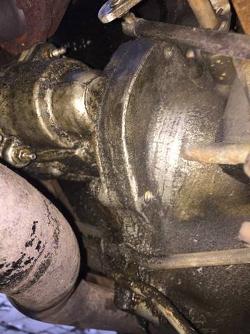

A worms eye view
Picture “A”
Item 1 – leave alone. Don’t worry about that transmission bolt (which also happens to be 5/8”).
Item 2 – there is a bolt there (refer to picture below). It does need to come out, before Item #3.
Item 3 – The second starter nut. Loosen this nut a smidge before removing bolt (Item #2).
Item 4 – also points to your transmission cooler lines and a clip that both pop into. That clip is one mentioned before that you can usually leave in place but slide forward a couple of inches (generally attaches behind nut (Item #3).
Note: Bolt (#2) and nut (#3) are both 5/8” hex.
A birds eye view.
Picture “B”
A 5/8” end wrench to loosen bolt and generally finger it out while gently wigging starter (if Nut #3 is loosened a smidge), which (IMO) is faster than getting a socket wrench and extension hooked up.
Both the bolt and nut are easiest to access from under car (also IMO). The stud will hold the starter up – until you are in position for it to drop down.
You can remove starter wires after starter has dropped down but I think it is easier to do before you remove the two starter fasteners.

I have the smaller starter wire removed.
But got sidetracked on why these 5/8 beasts don't want to back off.
LOL
I'm sure it has nothing to do with the 4 hours I spent bent over in my pump house trying to get the lines, unions, teflon, pressure tank, pump working again so I could wash dishes, clothes and self.
I'll try loosing the other one first and have a go at the bottom one again.
Thanks for your help.
1,492

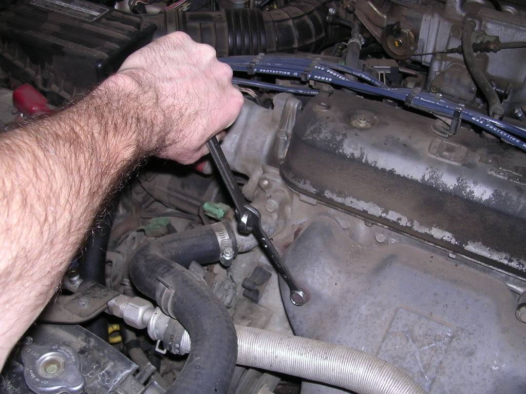

That 5/8” nut and bolt are on fairly tight.
A short end wrench won’t get them loose. A normal end wrench still takes a bit of oomph but will do it. A long end wrench is great – but not in everyone’s tool box.
Cambo
Sep 27, 2016
37
6
Southwest Michigan
If you are careful and have the room you can try doubling up the wrench. Works great in a pinch, but if you slip it's busted knuckles.
