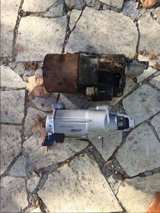

Got the new starter (smaller) and had it installed in 20 minutes.

If you used the mini starter, you won’t need the heat shield (it won’t fit anyway).
When those full size starters come down, you had better get out if it’s way.

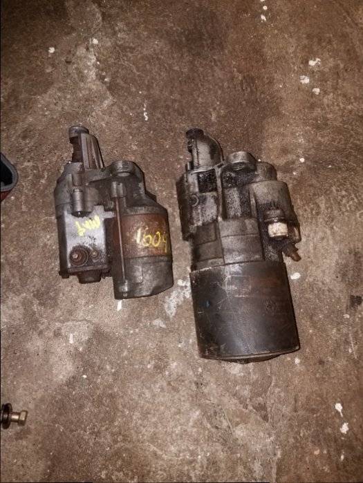

I used the mini starter 4:1 gear ratio and about half the weight of the old one.
If anyone needs an old style heat shield, I have one available.

Old starter and new starter.
