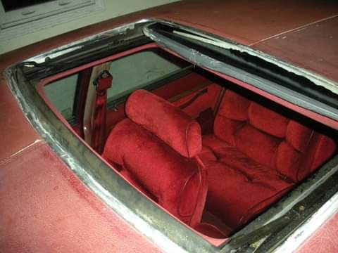

Reminds me of my '87 Diplomat when I bought it: the front passenger window moved slowly and slipped a few times on the way down, the rear passenger window worked perfectly, while both left windows didn't work at all and were slightly lowered, and the sunroof worked but was glued shut.
Glued shut, did they say why lol? My 2013 200 had a moonroof and I rarely used it. I found I really didn't enjoy it, although I have enjoyed the full top down of a convertible. If there's enough decent weather whenever I get the car back I'll dig into the windows, but I have a feeling it'll be months away still. It's been at an exhaust shop for 2 weeks and either they or my mechanic who's had it for over 2 years will finish the rest. Hoping I get to drive that car before WW3 or a total economic collapse takes place.
Glued shut, did they say why lol? My 2013 200 had a moonroof and I rarely used it. I found I really didn't enjoy it, although I have enjoyed the full top down of a convertibles
It was glued shut because there was no weather stripping on the glass, I found it once I cut the glue off and opened it, it was in the back part, I duck taped it back on-it didn't look that great but it worked! I always liked sunroofs, my other car has one and I usually have it open
