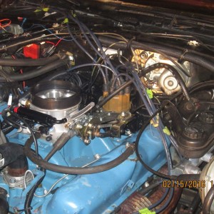

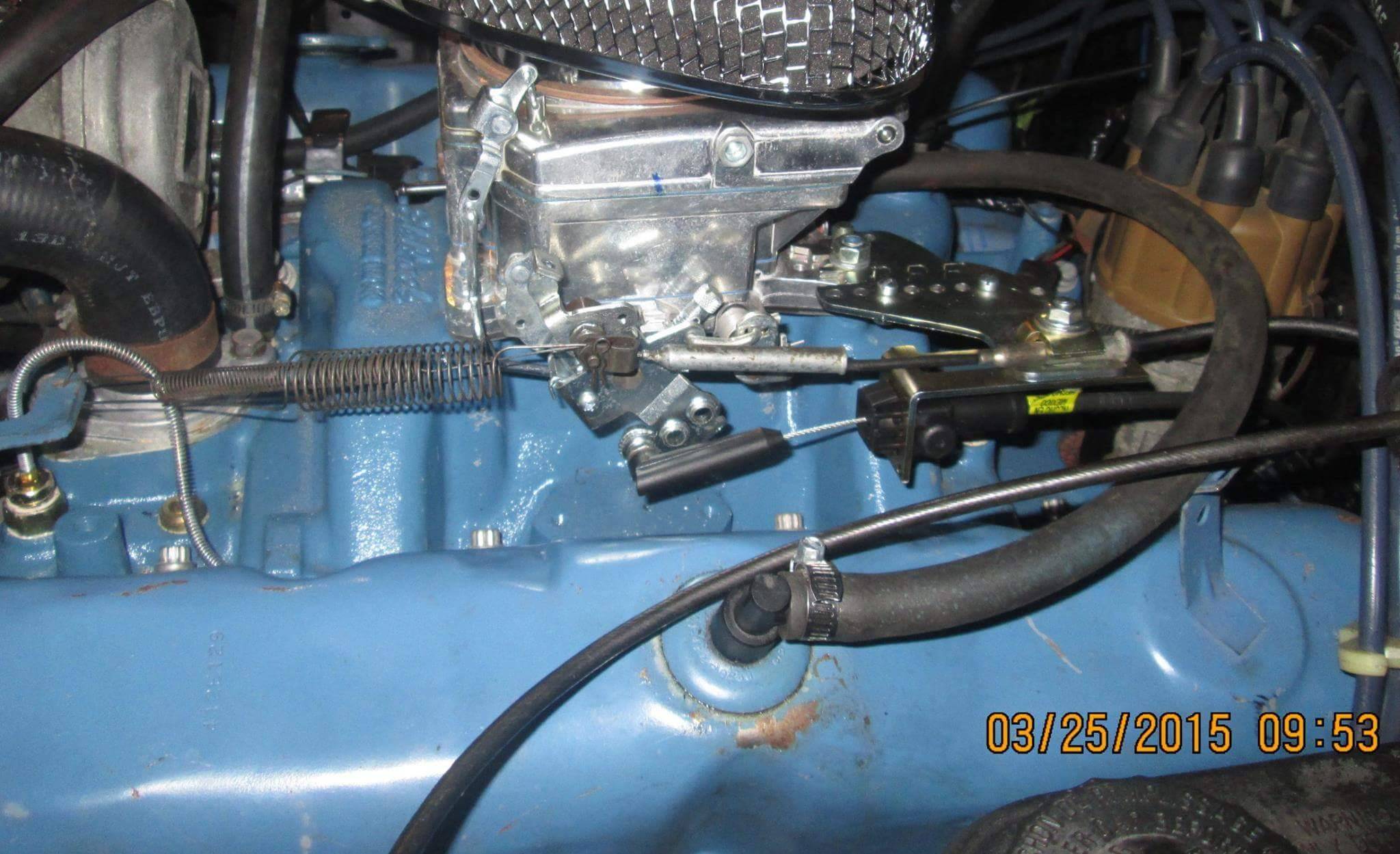

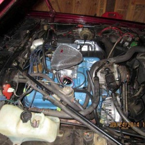

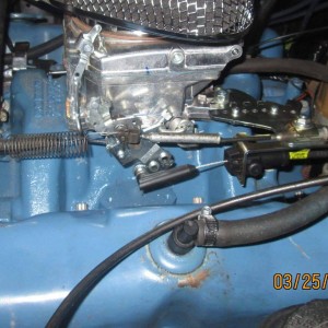

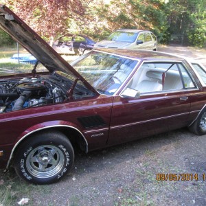

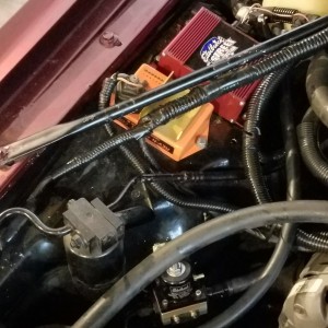

CURRENT SET-UP

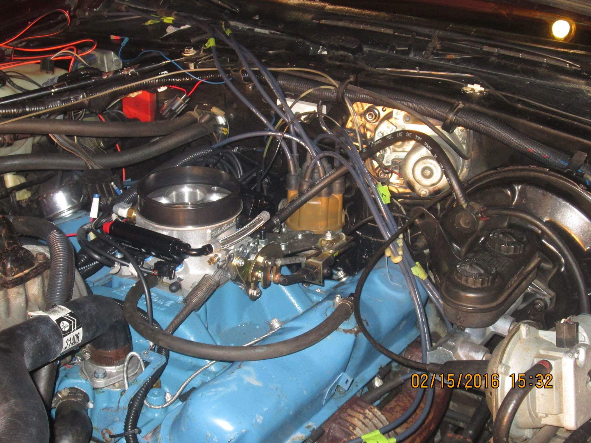

-318 cid
-Edelbrock Performer Intake

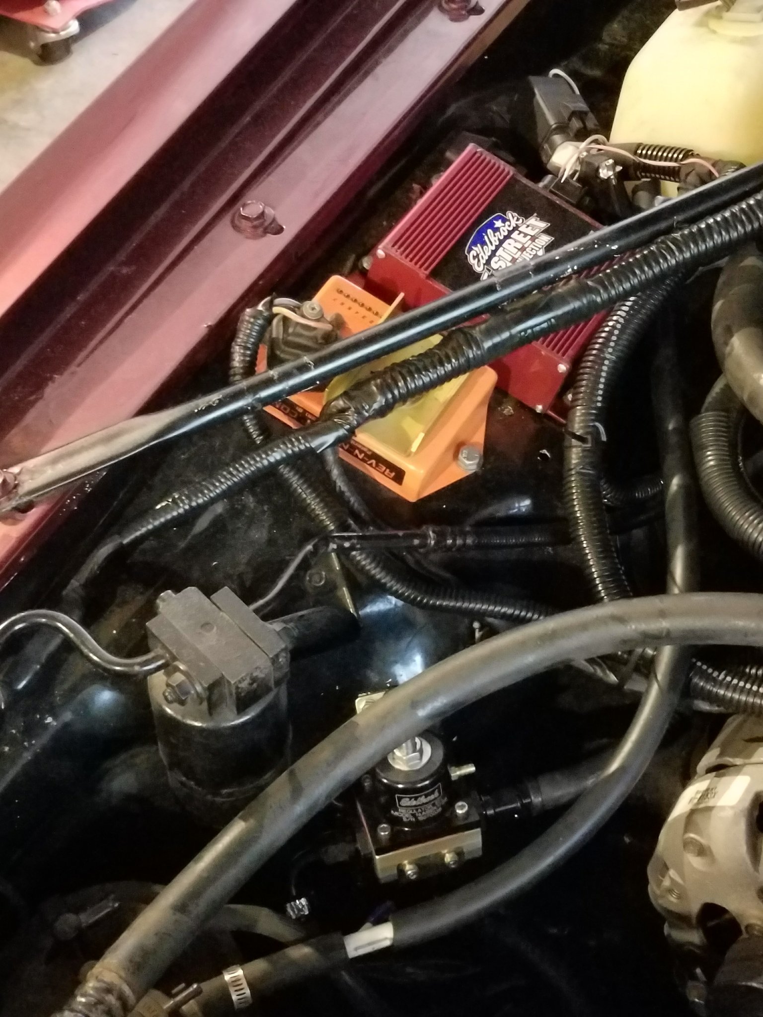

-Edelbrock E-Street EFI
-Stock heads and short block.
-Camshaft is unknown
-8 1/4 Rear End.
-Gear Ratio is stock.
-A998 Lock-up Trans
-Stock Converter
-Stock front and EPSO 4 leaf springs
-Dual exhaust 2.5"
-Revenator ECU and Pertronix Second Stike.
THE PLAN
-'95 318 Magnum Block (on-hand)
-Hughes 390 stroker kit (pending)
-Magnum Indy X 1.94 cylinder heads (on-hand)
-Intake Ported Edelbrock Performer (on-hand)
-Edelbrock E-Street EFI (on-hand)
-New gas lines for EFI (on-hand)
-Custom cam from Buddy Rawls
Intake 269 adv, 220 (.050"), 138 (.200"), .316" (.506" w/1.6")
Exhaust 273 adv, 224 (.050"), 141 (.200"), .316" (.506" w/1.6")
On a 112 Lobe Separation Angle, Installed at 108 Intake Centerline
-Headman Tight tubes (on-hand)
-Custom Troque Converter (pending)
-2.94 SG (pending)

Next step is the edelbrock Street EFI which I'm going to get in next month. Spring time, the 8 1/4, New sure grip with 2.94's, and new springs go in.
