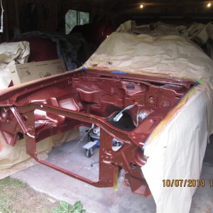

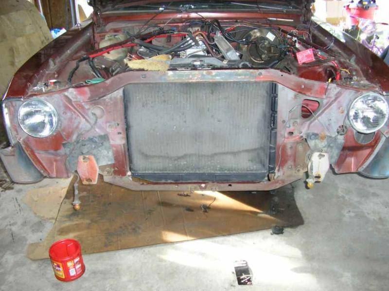

Combo '77 Aspen R/T 4 spd O.D.
ENGINE
Used
-(BLOCK IS '96 360 MAGNUM) STOCK CRANK, RODS WILL BE RECONDITIONED.
-SIZZLER THERMOQUAD: Refurbished
-RECURVE DISTRIBUTOR
-ROCKERS (MAYBE)
-VALVE COVERS
New
-STREET DEMON 750 CFM

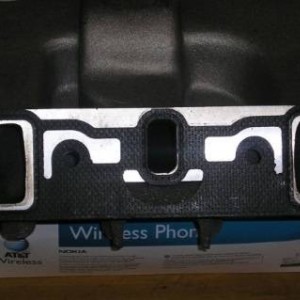

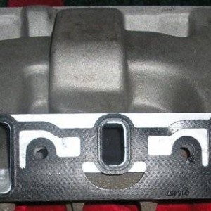

-HEADS: Magnum Indy X heads w/1.92 drilled for LA intake.
-KB 107 PISTONS

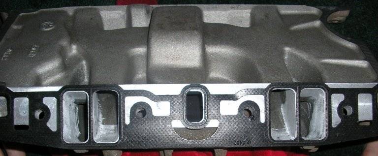

-PORTED EDELBROCK PERFORMER
-CRANK PULLEY BOLTS
-ARP ROD BOLTS
-ARP MAIN CAP BOLTS
-TIMING CHAIN TENSIONER
-TIME CHAIN
-POLY MOTOR MOUNTS: SCHMACHER
-OIL PUMP
-ROLLER LIFTERS
-OIL PAN BOLTS
-PUSHRODS
-ACCEL LINKGAE BRACKETS (LA)
-RETURN SPRING BRACKET (LA)
-OIL PAN (CENTER SUMP)
-ENGINE GASKET SET
-CUSTOM HR CAMSHAFT by BUDDY RAWLS:
Intake- 264(adv), 212 (.050), 127 (.200), .305" lobe (.488 w/1.6)
Exhaust- 268 (adv), 216 (.050), 130 (.200), .305" lobe (.488 w/1.6)
113 Lobe Separation Angle, installed at -108-110 Intake CL
-INTAKE BOLTS EDELBROCK 8579
-HEAD BOLTS: ARP
-TIME COVER BOLTS
-CAM BOLT
-CRANK BOLT
-FUEL PUMP
-FP ECCENTRIC
-TIMING CHAIN COVER
-FP BOLTS
DRIVELINE
-A833 OD TRANSMISSION
-FLYWHEEL: MAGNUM 360
-TRANS MOUNT: SCHMACHER
-CLUTCH/PP KIT
-CLUTCH LINKAGE PARTS KIT
-CLUTCH ADJUSTER ROD KIT
-TORQUE SHAFT SERVICE KIT
-FLYWHEEL BOLTS
-PP BOLTS
-POLY TRANS MOUNT: SCHUMACHER
-BELL HOUSING TO ENGINE BOLTS
-TRANS TO BELLHOUSING BOLTS
EXHAUST
-CERAMIC HEADMAN TIGHT TUBES
-2.5" DUAL EXHAUST W/ CROSSOVER
-MOD TANK FOR DUALS

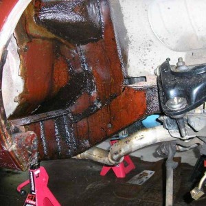

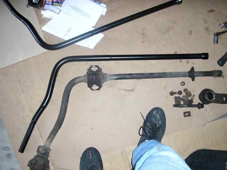

SUSPENSION/BODY

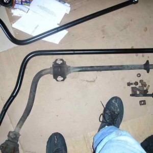

-FIRM FEEL TORSION BARS

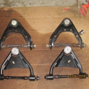

-FIRM FEEL TUBULAR UPPERS

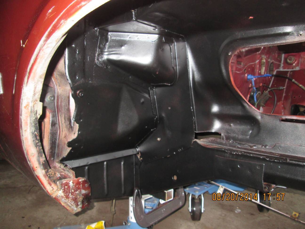

-RECONDITION K-FRAME
-RECONDITION LOWER CONTROL ARMS, SPINDALS, SWAY BAR
-NEW BALL JOINTS, DRAG LINK, AND WHATEVER ELSE I CAN REPLACE.
-ALUMINUM ISO PUCKS
-HOOD BUMPER: ROCK AUTO
-SUBFRAMES
-EPSO F-BODY FIVE LEAFS
-FUEL TANK PAD
-FUEL TANK STRAPS
-BATTERY TRAY
-ROTOR DUST SHIELDS
-MASTER CYLINDER

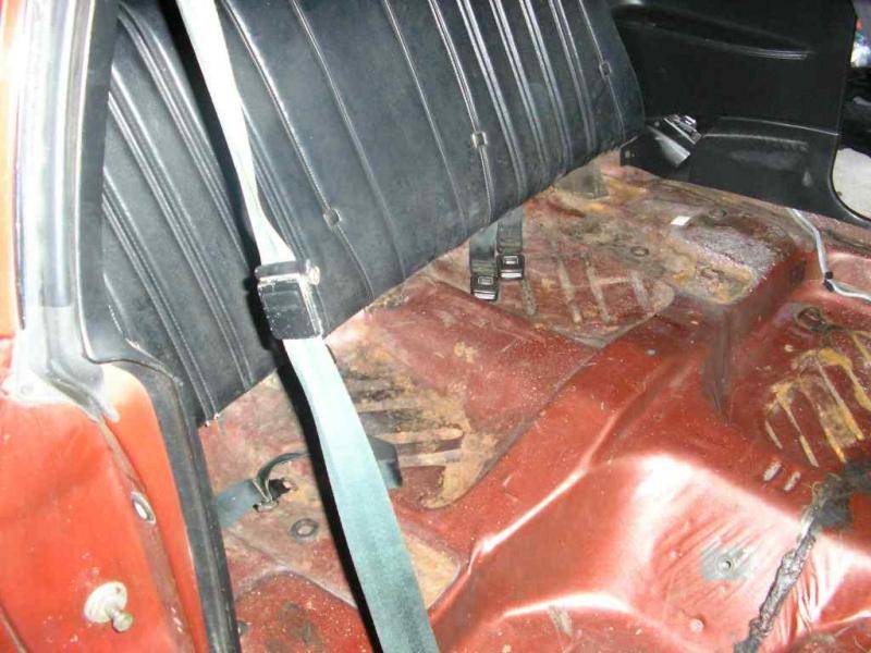

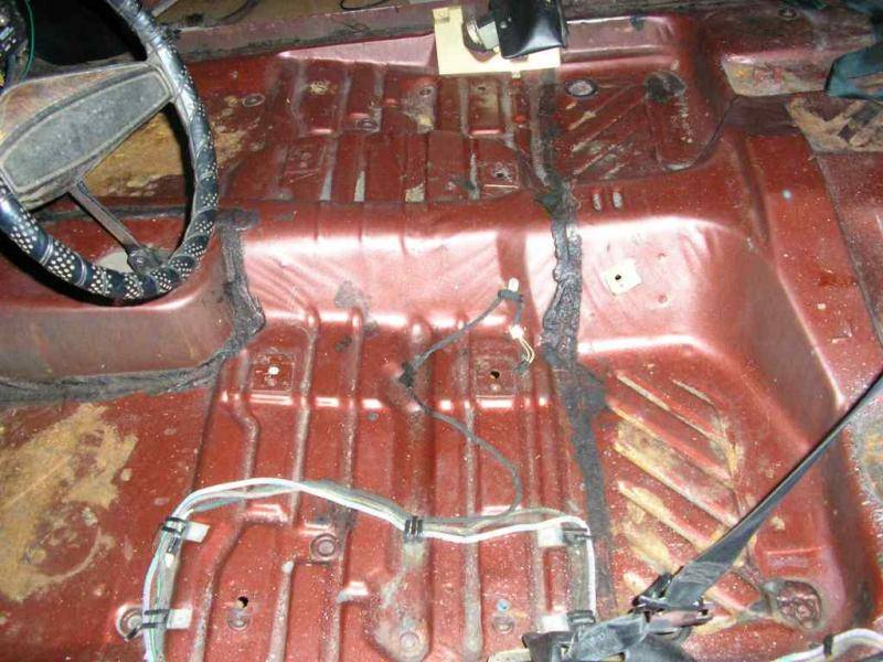

INTERIOR
-NEW CARPET
-RECONDITION FRONT/REAR SEATS
-HEATER BOX
-RECONDITION INT. PLASTIC
-HEADLINER: THANKS JIM
-TRUNK SEAL
-DOOR SEALS

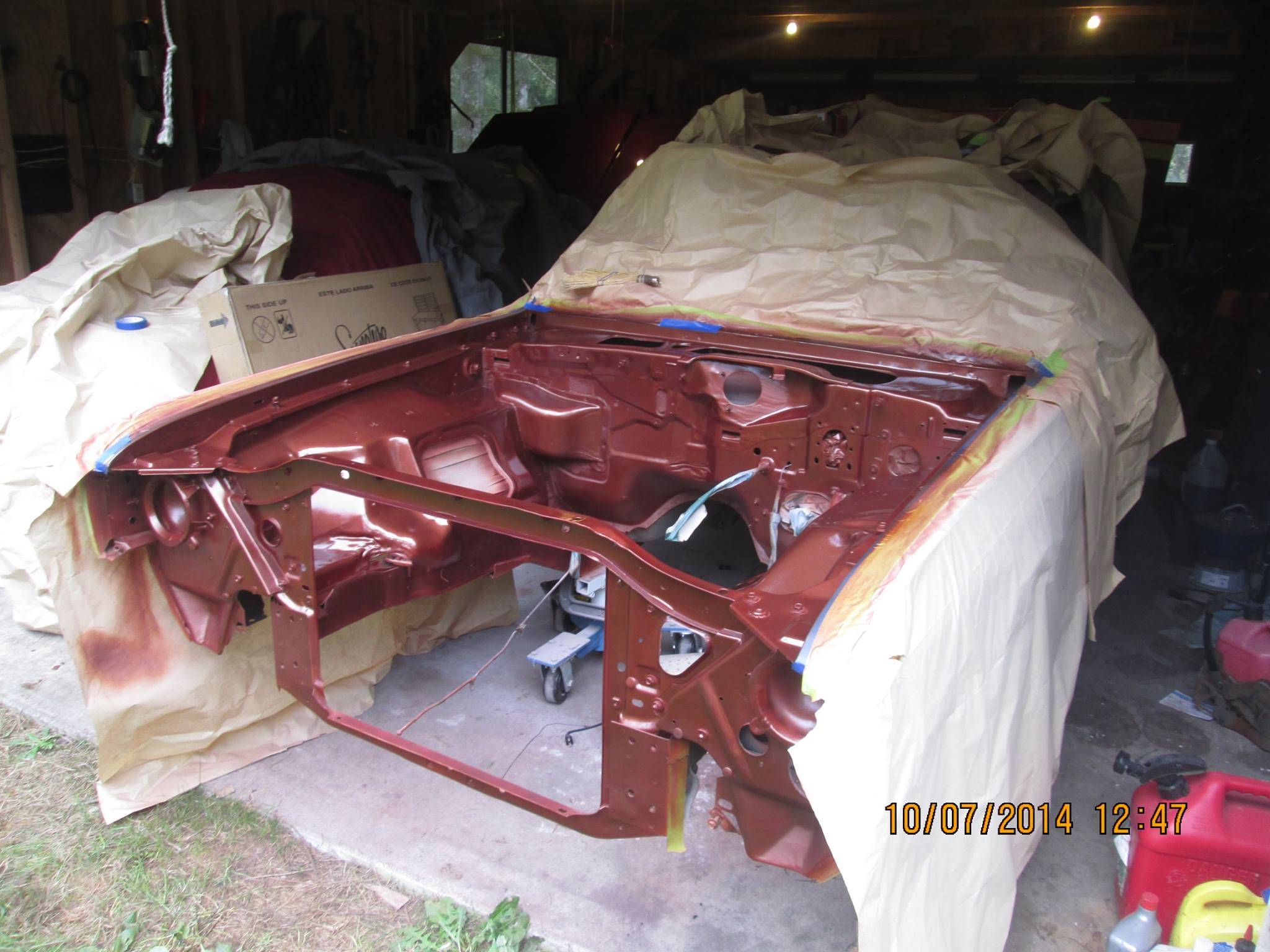

Comments
Nice work!
Love a freshly painted engine bay.

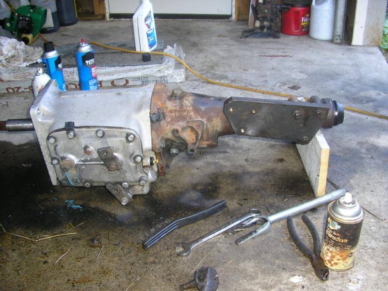

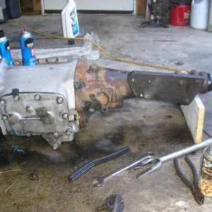

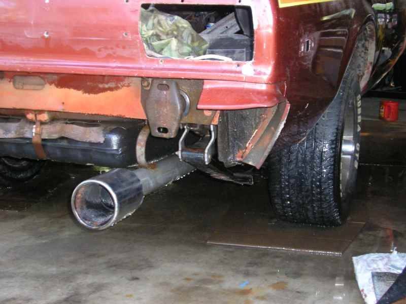

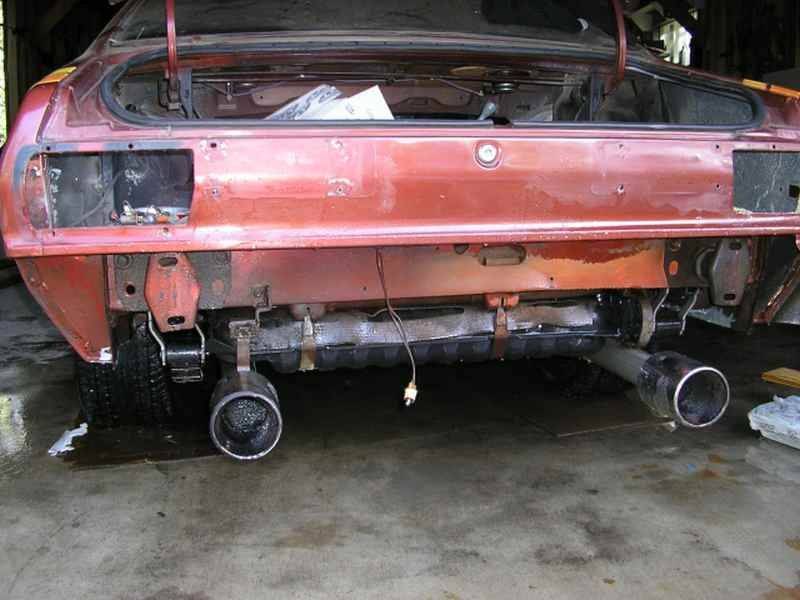

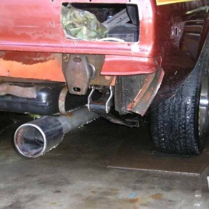

Just curious why you needed the shifter adapter plate,
Is it a long tail shaft transmission?
Long tail that's is correct. The previous owner did that. It threw me off when I first saw it. He also modified the gas tank to fit the dual 3" exhaust out the rear.
