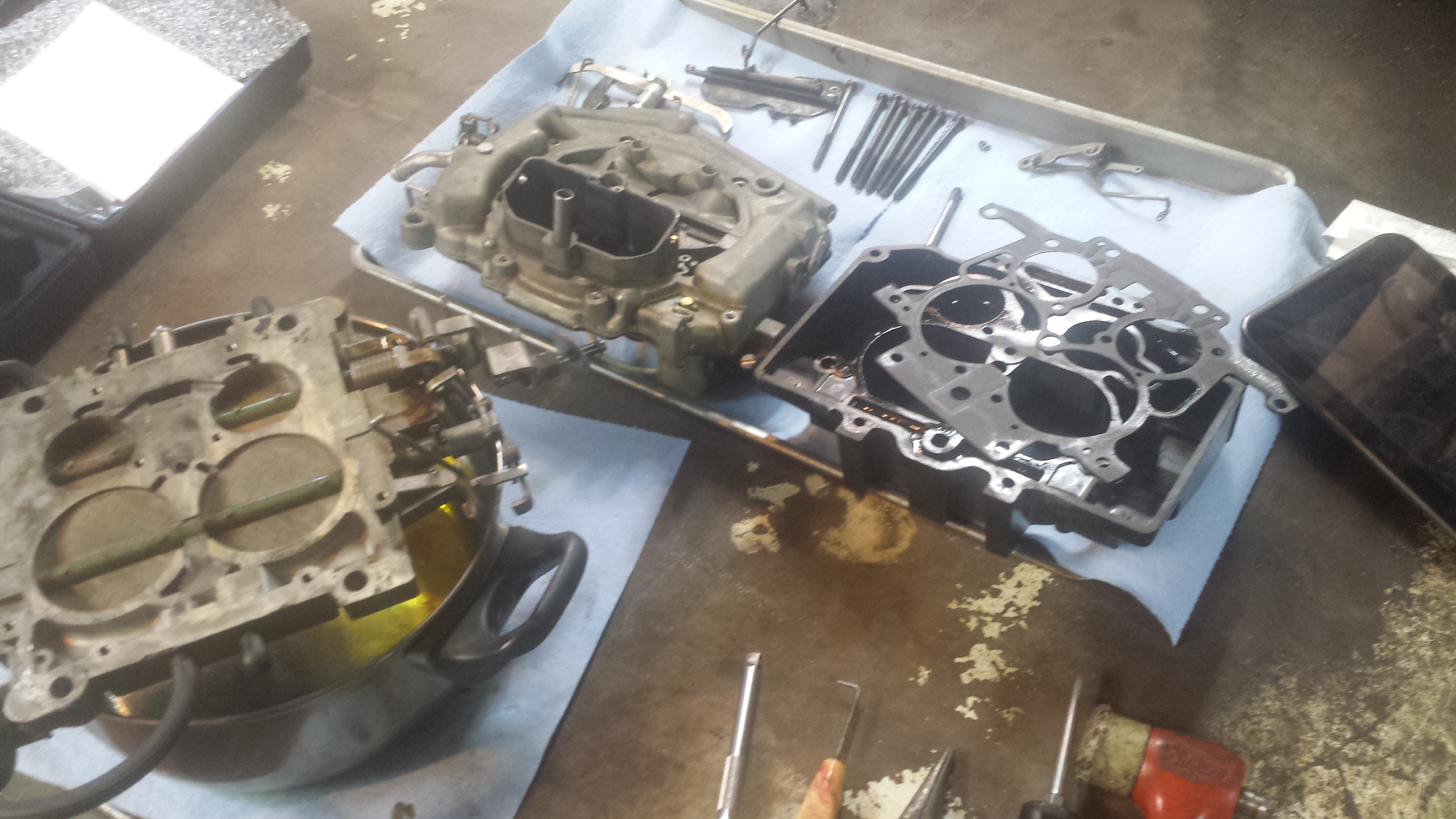

Well, the fresh gas work for a little while, unfortunately it cleaned all the varnish out of the gas tank. After but in the car run a few times put it outside to get another car in my garage to work on next day I went to pull the road runner back in the garage and noticed it was started running really bad, then really really bad, then really really really bad. So I checked the headers and the Left Bank number one pipe was really warm and the other three will cold, went to the right Bank and all four pipes for normal temperature oh, really hot....
So I look down the throat of the carburetor and only have fuel coming out of one side, so I got to pull the carburetor and the gas tank and clean them both as well as flush out all the fuel line.....

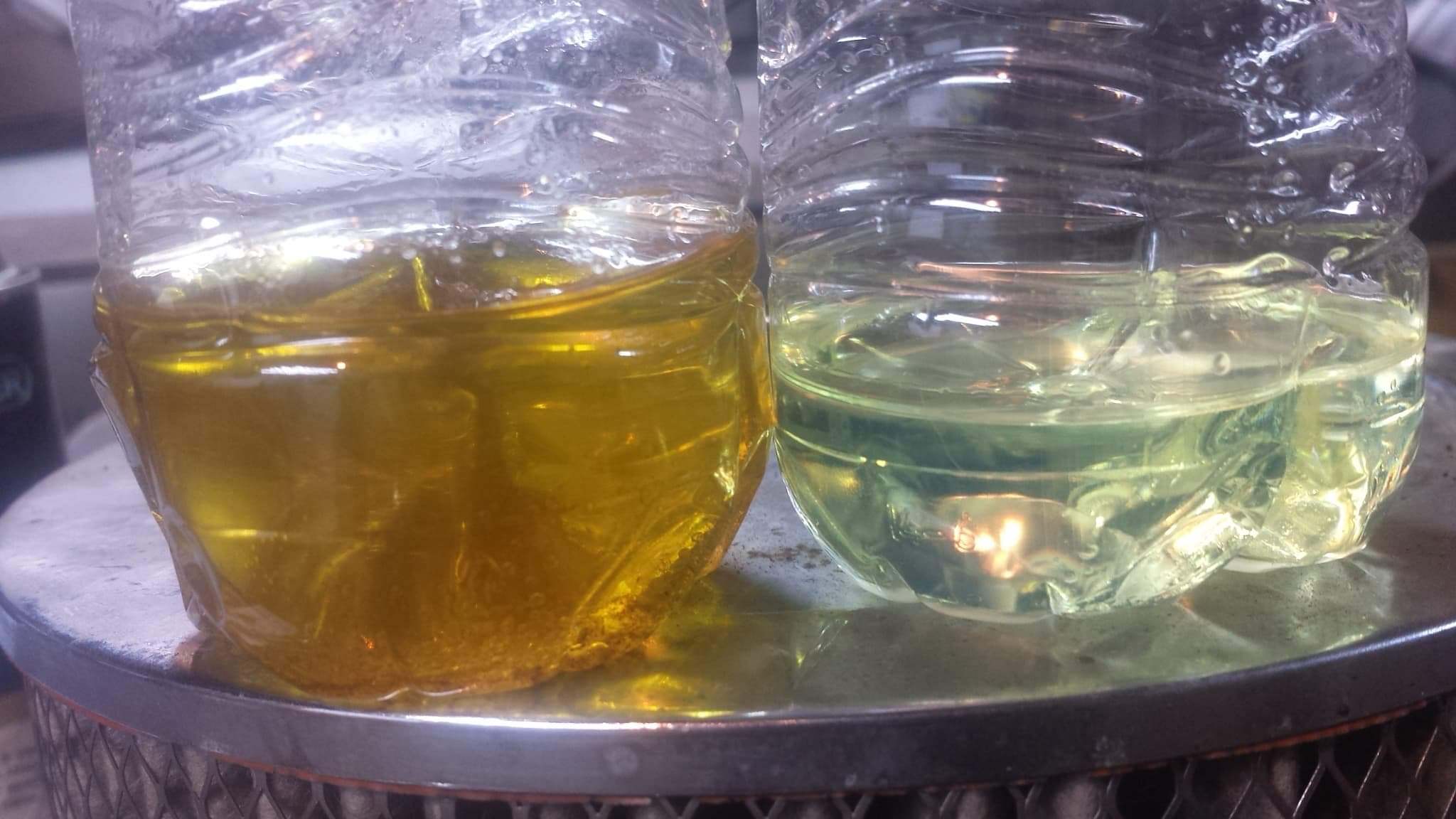

The first picture is the same gas out of the same can oh, the one that ran through the gas tank and that's the amount of varnish it picked up, yes brand new gas
I'm still having a little trouble with the carburetor, not sure I'm getting the right kit LOL
The first picture is the same gas out of the same can oh, the one that ran through the gas tank and that's the amount of varnish it picked up, yes brand new gasView attachment 36845 View attachment 36846 View attachment 36847
Those are great carbs but can be finicky.
Unfortunately that’s our ethanol. Can you find ethanol free gasoline? That’s all I run in my Duster wife’s Volare.

I'm actually going to start running Exxon Mobil 93, which is what the engine was initially built to run on......
By the way I'm still fighting with the carburetor I've got it off again

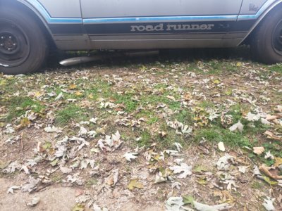

Just put tags and insurance on the RR after over 23 years of being dormant in a garage.... WooHoo!!!!!!
Got the exhaust installed today and took around the block a couple times , now I got to tune it with the exhaust on LOL
