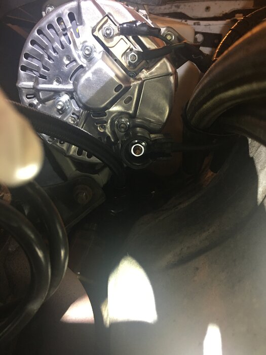

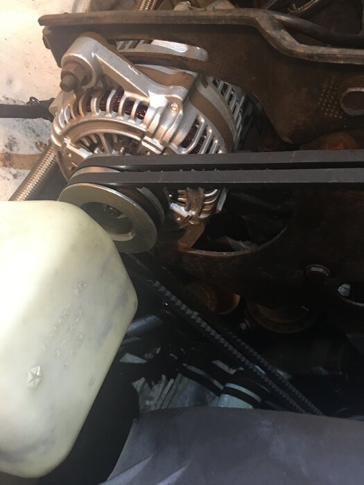

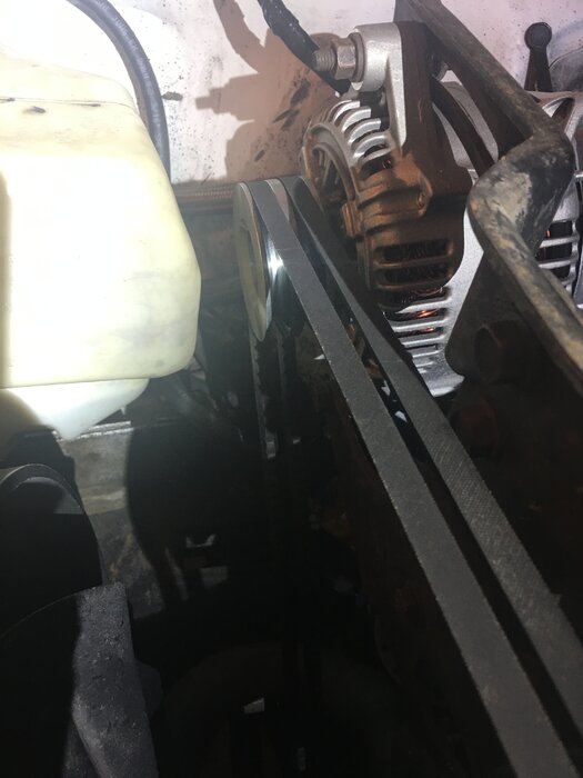

My '89 Diplomat AHB alternator is what they call "Denso type" 100 amp I THINK? Powermaster tech guy said he believes they had Mitsubishi style and I've never heard that. I asked if they made replacement for my car.

It looks like a Denso style. The give-away is the partial case vanes on the front. Very common feature of many Denso model alternators. But it is not exclusive to Denso.
1,494
Anyone know if this is Denso style?
Yes.
It is the Denso, which is short for Nippendenso. Denso makes a lot of alternators for a lot of different makes of vehicles.
Chrysler used them on all small blocks starting for '88.
Well, almost all small blocks. There was the 120a (new Chrysler) alternator, aka plastic-back, as an option. and in some cases a 90a Chrysler was used when having supply issues on Denso's.

Will this muddy the waters lol? Back of mine not plastic. I didn't know whether to put this here or your other very informative post. Also, would this style have internal voltage regulator? Thanks!
Edit: just answered my own question by getting off my rear. Found part number and no internal VR (good because I have VR connected) and 120 amp.
