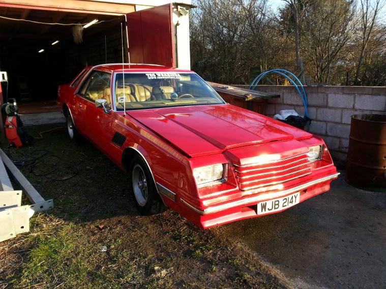

Some of the Mexican and Canadian vehicles received different badges than those sold in USA.
This is a fellow forum member’s Mexican ’80 Dodge Dart:
