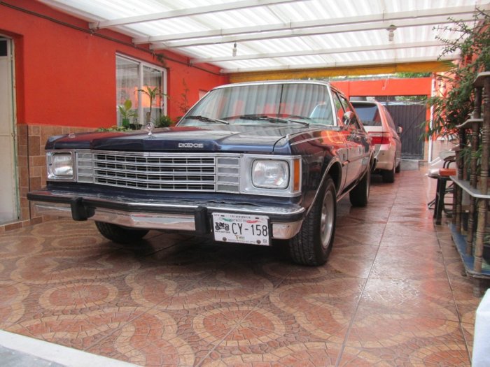

Some of the Mexican and Canadian vehicles received different badges than those sold in USA.
This is a fellow forum member’s Mexican ’80 Dodge Dart:

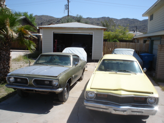

The 73 - 76 Dart hood is the same as a 67 - 69 Barracuda hood in case anyone needs to know.
73-76 dart/dart sport hood outer skin is the same as the 69 Barracuda.
Underside structure crumple zones are different.
67 and 68 didnt have the center rib/beak in the hood so its not a fit.
