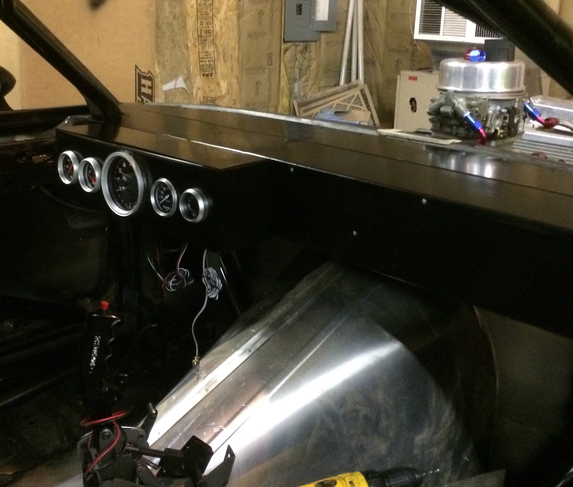

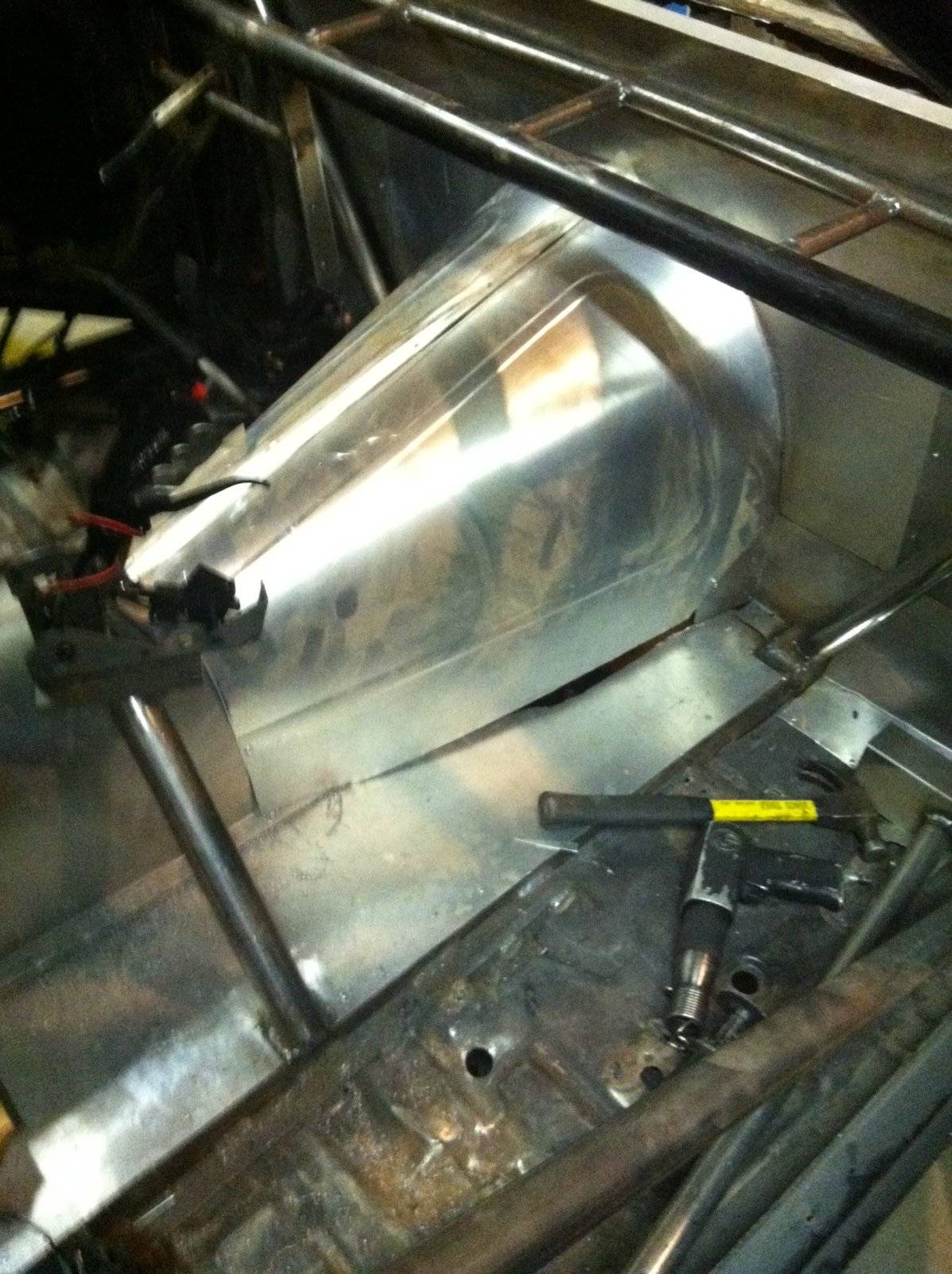

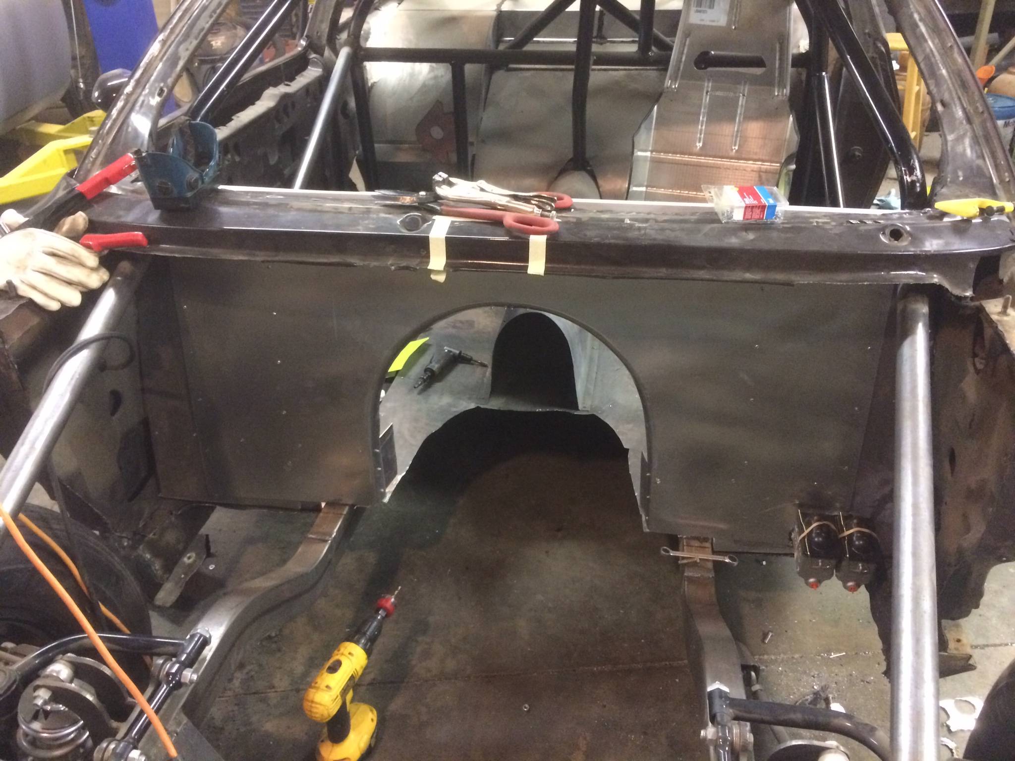

Got he firewall pretty much put in and the master cylinders and brake pedal mounted. Coming along.

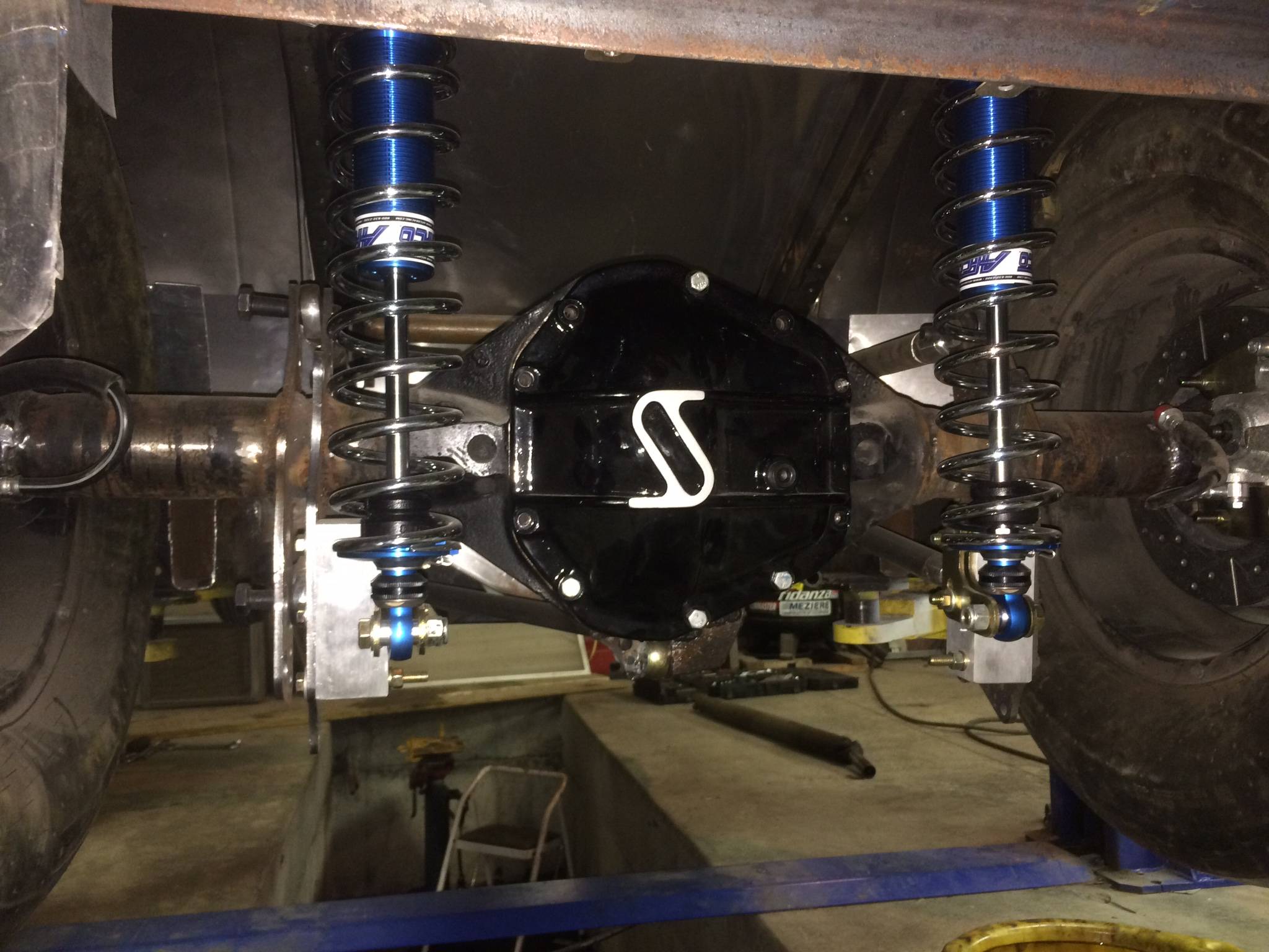

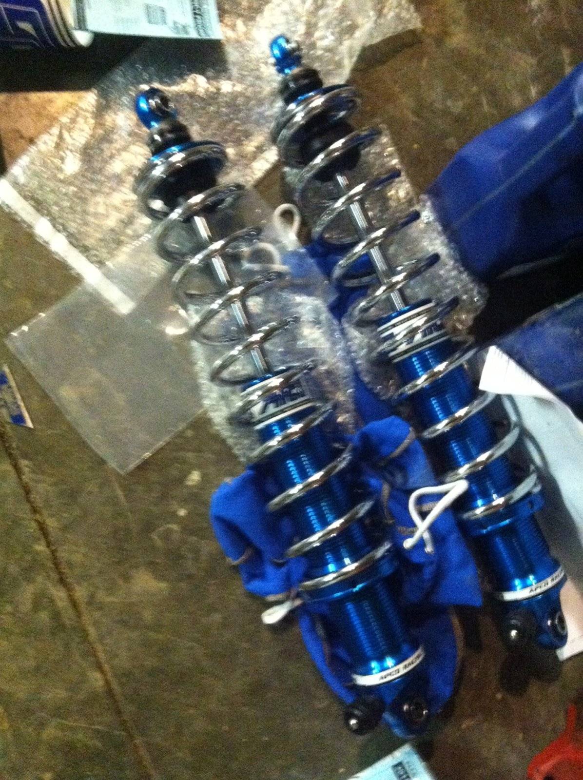

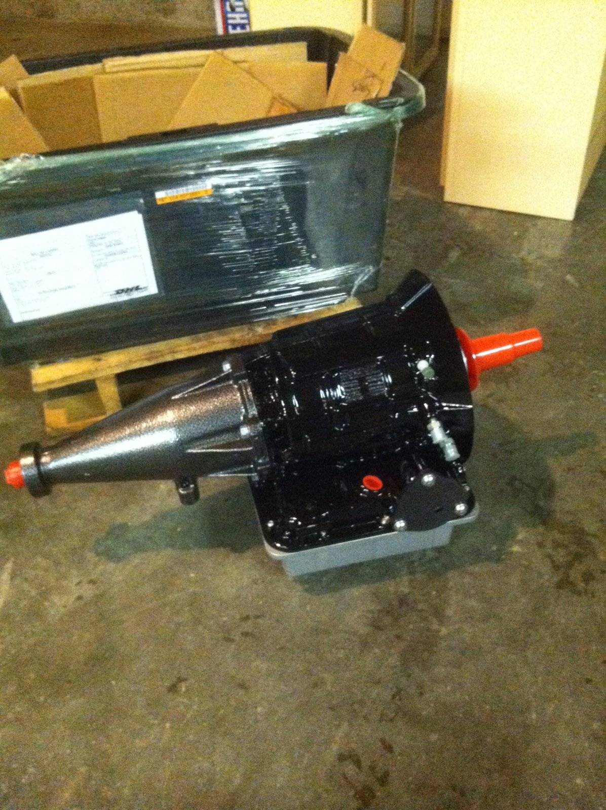

Few updates. Rear end is completely done except for installing anti-roll bar but the coil overs are in and wishbone. Had to shorten the rear end 3/4 of a inch on both sides to get proper wheel spacing. It's coming along. Going with a power glide trans. JW made the conversion real easy. Not many big things left to buy other then the rotating assembly.

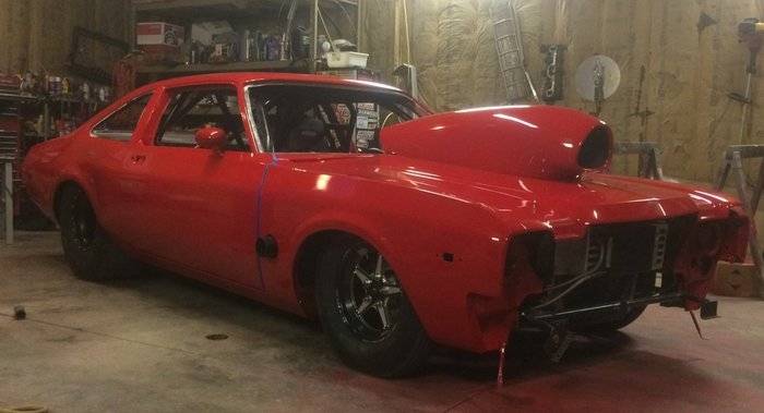

South Dakota
Sorry for not posting in a while. Took a little break from the internet lol. The car now running, And we just got paint done last weekend. Have to cut and buff the paint. Hopefully have it to the track at least one time this year yet to break the engine in.
