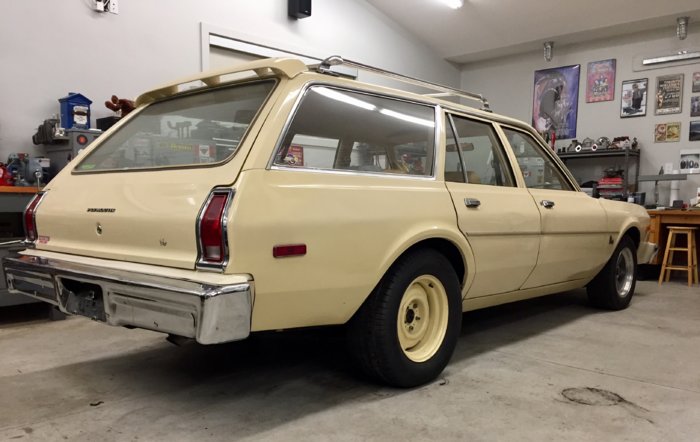

Managed to spend the last two days hanging out in the garage and got quite a bit done on the wagon.

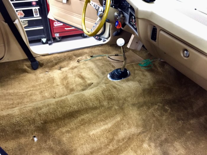

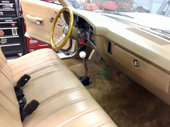

First I got the carpets shampooed and they turned out surprisingly good. After that you put the front seat back in and gave the interior a bit of a cleaning. All in all looking good after almost 40 years.

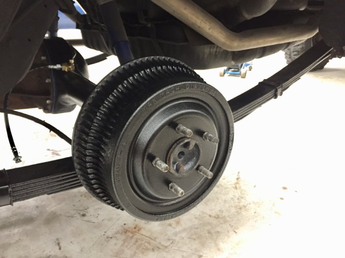

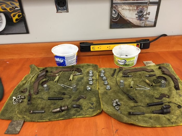

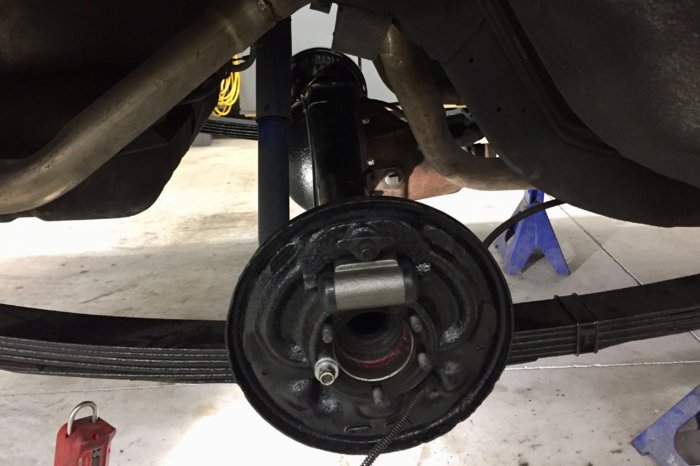

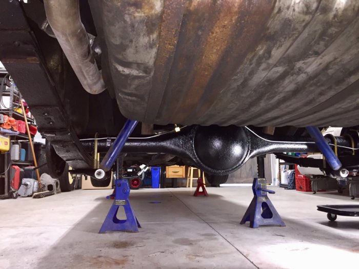

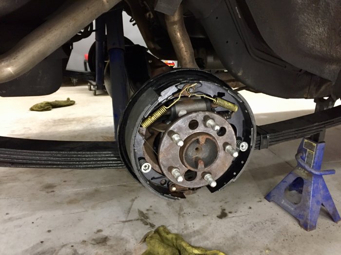

Next job was to put the rear and back together and get it back in the car. My original pot has a bad pinion bearing. I picked up a used pot with 3.23 and a sure grip from a friend. He had it under his work bench for years and thinks it’s good. Im hoping its ok. I put it together with new axle seals and brakes and got it installed with a little assistance from my grandson who we were babysitting today.

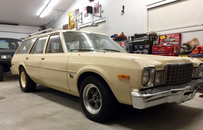

I couldn’t resist dropping it back on the ground to see how the re-arched springs worked out. The spring shop delivered. 2 1/2 inches lower and it looks way better. I turned down the torsion bars which were cranked up far too high and the whole thing looks good.
Next up is to reconnect the rear brake line and bleed the brakes, put the driveshaft back in and take a test run.

Aghh! You're killing me! What I would give to have an empty, clean garage like yours and the time to work on OY! Your carpet looks like new! You were lucky you didn't have to buy replacement. Your wagon is almost a visual double of OY. The interior is a lighter shade of tan than OY, but the exterior paint is very close. Although I'm not sure, I think it's a shade lighter than the "Classic Cream" that was a '78 only color. Nice job on the rear axle and brakes. Did you add another leaf to the rear springs? I have the 5 leaves in OY, and want to get them re-arched to raise up the rear end a bit. That, and I plan on putting on spring loaded rear shocks too. All in good time I suppose.

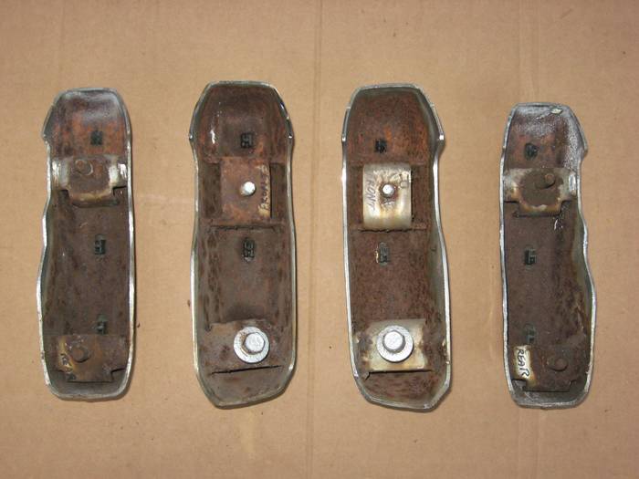

I do not want to hijack this topic, but have a short question.
But is it possible to remove the rubber strips and, if possible, place them a little neatly? Or to leave out the whole?
With my bumpers is already quite some rottenness between these rubbers. I do not know if it will be tidier then.
Opticon77
Apr 15, 2018
307
214
SE PA

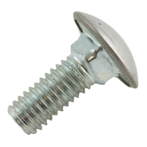

Not sure about separating the rubber from the chrome, but the entire chrome vertical "bumperettes" are technically removable (rust could be a challenge). There are small bolt holes behind there so you'll need some chrome capped "bumper bolts" if you want to keep it looking clean.
Judging by this back photo of the bumperettes there will be a few oval slots along the leading edge if you pull the rubber off...

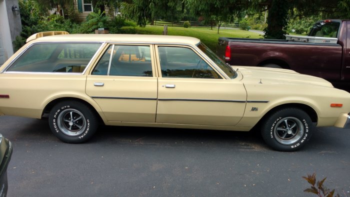

I just noticed another minor difference between the '78 and '79. The side molding on your '79 Volare is body color, and it is black on my '78 Aspen. I actually plan on removing it altogether I think. Definitely if I get OY painted in the future.
Removing that side molding is on my list. I'm thinking a heat gun and some gentle prying. Not sure how much adhesive will be left behind and how I'd get rid of that.
Heat gun will do it and it will remove the two face tape that holds the molding also. I wouldn't be surprised if the paint is a little deferant color under the molding, as in not faded.
I'll try the heat gun and provide an update on the end result. I'm expecting some paint variation.
