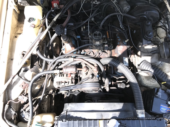

You need to plug all of the un-plugged vacuum ports.
You can purchase a package of multi size caps - or get some short pieces of hose, then insert a small screw or stick in the other size.
With un-plugged vacuum hoses - it will be hard to diagnosis any problem on the car.
I think everything's already plugged off Bud. Unless you're seeing something I'm missing?

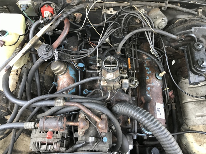

I finally got around to cleaning all of the acorns out of the intake manifold. (I've only owned this car for a few weeks now!) I think this car sat for a while and some squirrels made a nest in the top of the engine lol.. there was a ton of acorns!
Anyway, I cleaned and vacuumed all the acorn debris etc out of there finally, and took some hi-rez pics. Uploading now...

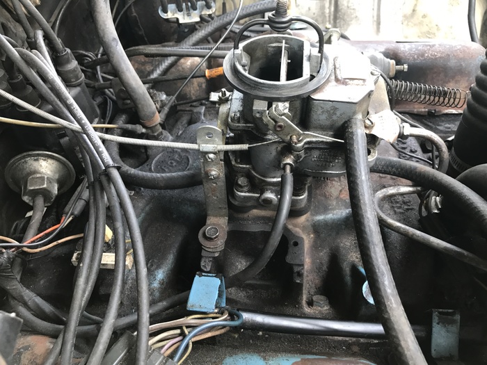

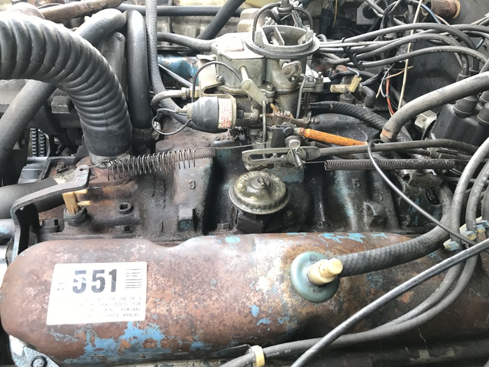

Here's a few more pics after cleaning out the acorn debris.

Note: I did pull that PCV valve out.. so that's why it looks loose. I need a new grommet and probably a new PCV valve itself.

Say,Bud; do you remember how that bowl vents? Does it vent into the airhorn beside the hold-down system? There is no adjuster under that flat tin plate,right?
Or does it vent back to the canister?
You know what I'm thinking right?
OP has stated he heard a whosh when opening the gascap. That's not supposed to happen. The tank is supposed to vent into the canister, and so is the float bowl. Since the tank is not venting properly, maybe neither is the floatbowl.
But if the tank is pressurized, it will add it's pressure to the pumps pressure, and maybe the float valve cannot handle it. I heard the Op say he had driven around with gascap off, and it still does this, so one might rule that out.
So that takes me back to the canister. I see the big fat bowl fume- collector hose is still on the carb.
So what triggers the canister purge? I think I see the trigger hose is still on there
Oh I see it now! The vacuum advance hose is hooked to venturi vacuum, and the purge hose is hooked to the spark port.
Am I right?
Well that's messed up.
That would trigger the canister purge right off idle, and it would go straight to 100%, instead of being modulated by the venturi vacuum.And I don't think the venturi port has enough power to operate the vacuum advance, and if it did, it would be very late in coming in.
OP,wait for Bud to chime in and verify. or not. But I think you are gonna need to swap those two hoses around.

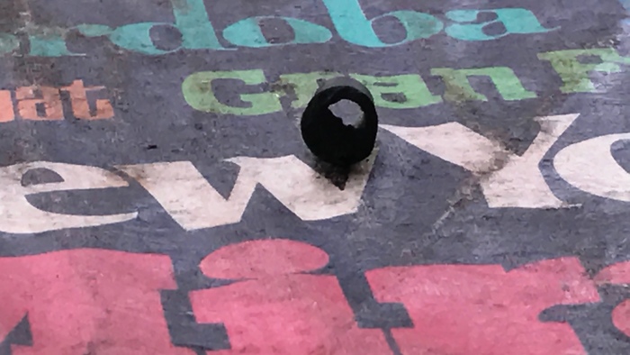

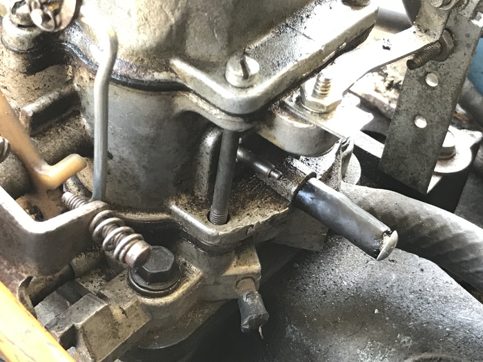

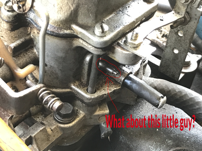

Oh... I think I found something! Might not be that significant, but it's something! Ya see that plug in the picture above.. right below the red "W"? Looks like it's plugged right?
Intrepolicious
Feb 16, 2017
206
17
Florida
So I put a proper plug on that one, and plugged the little skinny one as well.
That got rid of the whistle! Preliminary results are; started right up and ran like a champ around the neighborhood. I let it warm up for a few, then took it out around the block, up to about 45mph for a few stretches, and did a couple semi-hard brake tests to see if the kickdown to idle was good... didn't stall one time!
Maybe that fixed it...

According to the colorized diagram in post #76,your routing is correct.
According to the one above it, your routing is wrong
Oh, I see you found something. Yahoo!
Now if you if she stalls again, pull the bowl-vent hose off the carb, that is the big one at the front, the highest one. Then roadtest again.
