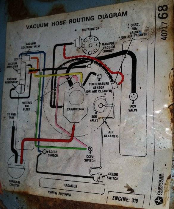

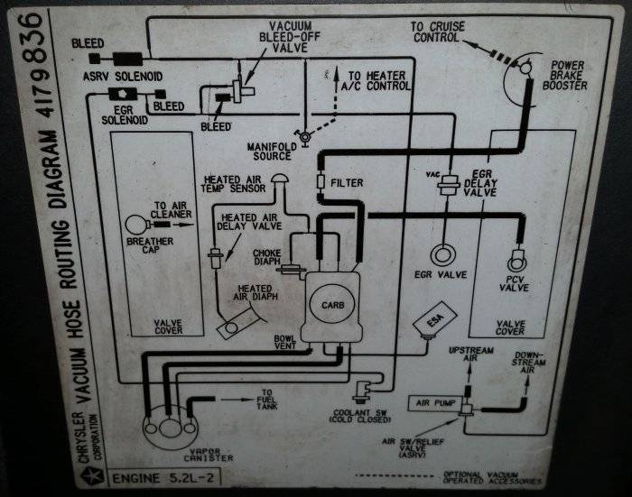

2. Missing vacuum lines
I didn't see any vacuum hoses at all, except for one going to brake booster(?)
Attached is copies from my '77 Wagon and '86 5th Ave. Both are 318 2-bbls.
The '77 would be more correct – and even then, not all needs to be re-attached.
'86
'77
The port going to Temp Sensor (on Air Cleaner) can be plugged (in Florida).
The PCV valve hose and hose going to distributor vacuum advance are both a must.
The OSAC valve can be bypassed (the '77 diagram could come with or without a OSAC valve and both are listed – which is confusing).
The EGR, CCEGR (either), CCEV, Vacuum Solenoid Valve*, Vacuum Amplifier* and Vacuum Reservoir* hoses (and part themselves) can be left undone – as long as ports on carburetor have been plugged. (* means I suspect these parts have already been discarded).
Thanks for the pics! With the lean burn setup removed, there's all kinds of things plugged off on the carburetor. The PCV and the dist vacuum advance hoses are there. Everything else looks like it's plugged off, although I am hearing a whistle when I rev it.
