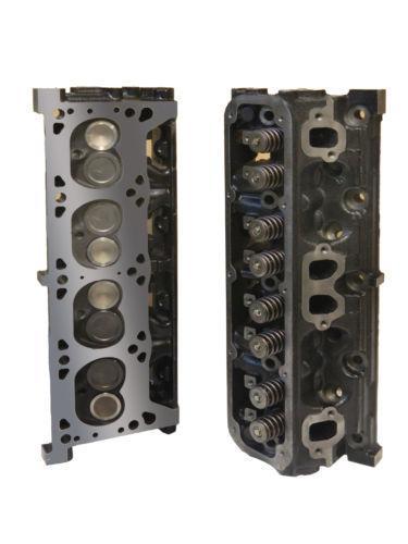

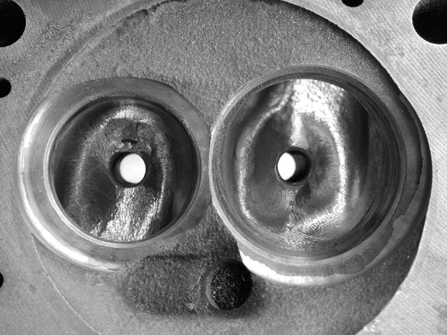

You can get 340/360 cylinder heads to bolt onto a 318 (which is what the police 318’s have) – but for some reason the factory made the 340/360 heads with larger combustion chambers (higher CC (Cubic Centimeter)) – which effects the compression ratios, and a more.

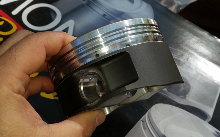

A person can install 340/360 cylinder heads and manifolds to a 318 – but you will also need to change pistons because compression ratio will be way low, otherwise.

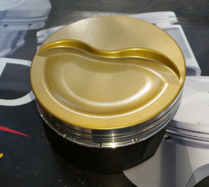

What a stroker crankshaft kit does is increase the crankshaft stroke (according to size you request). The common size is 4.00” stroke (up from 3.31” on 318 / 3.58” on 360) – which would give a 318 a new displacement of 390 ci or 408 ci on 360. The down size is a stroker crankshaft kit (consists of crank, rods, pistons, rings and crank bearings) run about $1,500-2,000 (US).
They also get the compression ratio back up to a better place.
To make use of the displacement, 340 or 340 cylinder heads (or Magnum) are now needed (so engine can breath) – or the engine using 318 heads will run out of steam at about 3K RPM (again – think small straw size and trying to push more air through it).
