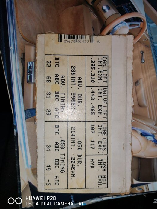

Hi Guys, i have a 360 LA engine installed, it was rebuilt by the previous owner...i''ve attached the information card with all the measurements and specs.
Currently i was able to determine the following:
BRC WG-1161 Camshaft
Keith Black 107-040 Pistons
I believe the heads are stock, can anyone recommend some nice heads to increase performance? I also want to change the camshaft eventually down the road to get more power but maybe just heads for now if thats possible.
What about the ignition system? including the ballast resistor and all that stuff. Everything is stock except for the lean burn which was removed. Can anyone recommend a decent ignition system?

Yikes!!!
That cam has got to go my friend.
So here is the thing, it's an older style design with a lot of advertised duration delivering very little duration @0.050". It reminds me of one of my first "performance cams", which was a SpeedPro CS-1019R. Oh, cmon, yes tiny bumps on that thing, but we all gotta start somewhere!!!
Bottom line, I would recommend getting into some newer tech. The un-needed longer advertised duration is what's going to bleed your street manners...lower vacum, poorer throttle response, etc., mind you, we are talking here street behaviour.
I once ran a Crower 282-HDP CompuPro (#31243), which was a .480/.503 lift, 228/238 @ 0.050 and 282/292 duration, on 112 LSA. Great street grind. Compare that to your specs and see what the Crower gains you.

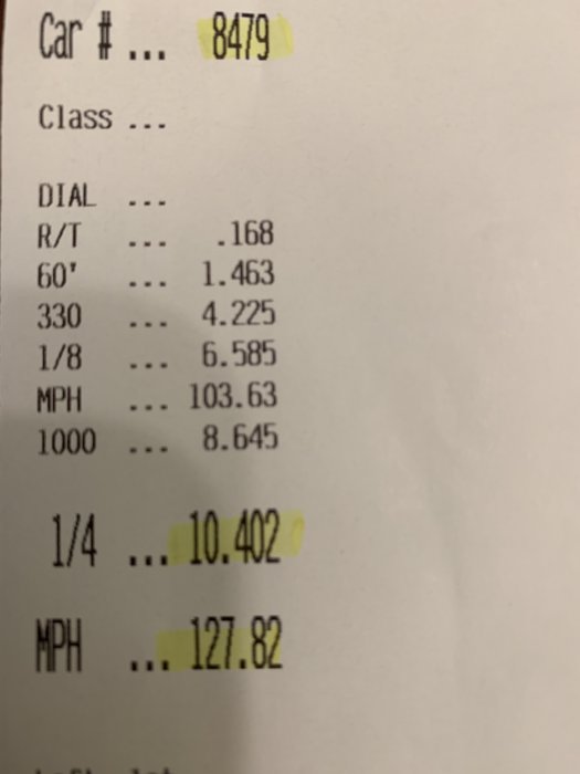

If spinning isn't winning get better tires!
I couldn't agree more.
I have a 4k stall converter in my coupe, that's behind a pretty hot 360 motor. The switch from 3.91 to 4.10 made things worse, but the sticky street legal Nitto NT555R rubber out back is plenty good to prevent the tire hazing!
Point being: you can't just think of it in terms of IDLE/WOT terms. Yes, even with sticky tires you can still "surprise" the machine and break 'em loose, but that's not using your driving skills, is it now?

Did some thinking here, the edelbrock top end kit is going to put me in the 440hp territory... way to much for a street car with 3.91 gears so you are definitely right. I don't have a tach but I suspect im a smidge over 3000 RPM's at 60 MPH. The final drive ratio in 3rd gear in the 727 should be 1:1 before it reaches the rear end so 1:3.91 for final. At this point im planning on skipping the heads since I just pulled the valve cover off and they are stock mopar 587 iron heads ported at 1.88. Restricted yes, but im not sure its worth a big jump in money since i realized i dont need 440 HP. At any rate im looking for around 350ish HP, im guessing im at about 250-275 now. Im interested in changing the Cam, and I really like the sound of a lumpy cam...can anyone recommend one I know edelbrock makes one, not sure if its any good.
With the cam, im going to need new:
-Valve springs
-Lifters
-Rocker Arms
Am I missing anything?
