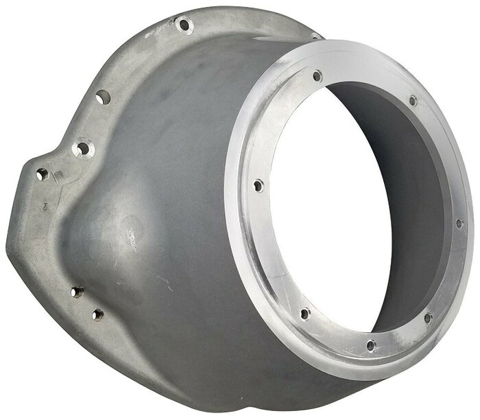

Practically there is no real difference between a big block and small block 727, other than case. Year range, and "designed load" are the differences
1,494
Are the SB 727 guts any different from the BB 727? I didn't think so. Could swap cases so you don't have to buys parts over again or fuck with adapters.
Yes and no.
For the most part, a low end 318 A727 guts are the same as an (same year) 383/400 2-bbl A727 guts (the difference is the case).
Now /6 guts are way low end. There is not much, if anything, inside a /6 A727 (or A904) worth keeping.
As the performance level goes up, the number of planetary gear pinions (3, 4, 5 or 6) on the two (or three for overdrive) and the number of clutch disks/plates on each clutch pack (more disks/plates = more torque capacity).
A lot of parts changed over the years (for better and for worse).
I have heard from friends the plate style SB to BB changeover is finicky, cheap looking and hard to get things setup correctly (crankshaft center-line to transmission center-line) - but have no first hand knowledge on that.
Another point is the transmission mount will be placed rearwards the thickness of the plate - which can be (or not) an issue.
The system used on post # 92 is what I have been eyeballing.
JW Performance 29457 Ultra Bell. This item is not cheap (over $500 US) and requires cutting up a case to make it fit. I have "heard" a friend saying this method is not that strong sense all power goes through the small front pump bolts - but there is a ton of people using this without any problems - so I think someone was trying to make this method sound bad (...I guess).
Note: I have been working on this reply for sometime now and others might have beat me in replying.
2,991
It isn't only the bolts taking the force. When properly torqued, the "friction" between the case and bell are adding strength to the set up. I'm not sure how much of the torque actually goes through the bell. I mean, a 4-speed is only attached by 4 bolts and they work fine. Granted, the bolts are a little bigger but only 4 of them, vs 7 for the adapter bell.
1,494
The front pump bolts on A904 are tiny. The A727 front pump are a bit larger.
I would not use the bell replacement on an BB using an A904! If you want to use a A904 on a BB, use the adapter place method.
