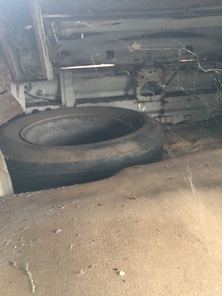

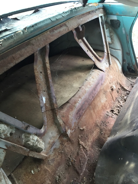

Backseat is out, this is the crawl space to the trunk.
I've cleaned it up and removed the dirt dobber nests as well
No dead bodies, but looks like a full size tire.

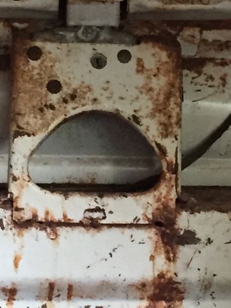

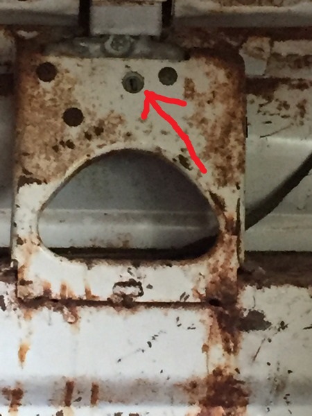

You can see the backside of the lock in the top/center.
Here is a closeup of the backside of the lock. There is a plate there.

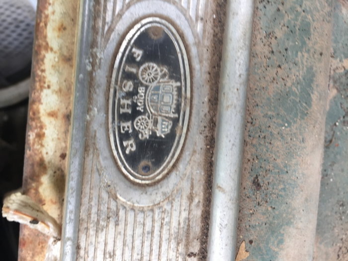

Love the imprinted logo on the floor coverings.
Apparently this company provided the interior.

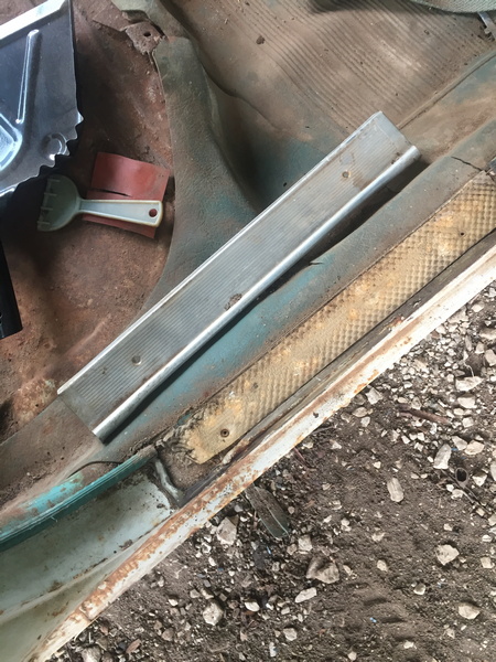

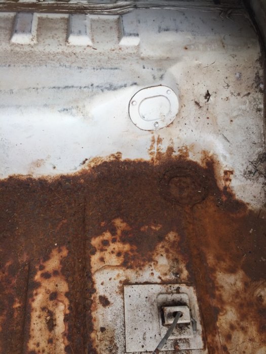

Removed the beauty rail in the right rear.
The is at the center rear floor area.
Since the transmission is in the rear, the 'hump' for the bell housing is in the rear center.
Apparently there are no weep holes, so all the water over the years has accumulated and cause it to compromise the floor.

The hole in the lock plate, more or less in the center, looks to have a slot in the piece behind it. Stick a screwdriver in the slot and turn. This is the same slot the lock linkage goes into from the other side. Provided the latch isn't rusted tight, the trunk should pop open.

Fisher was the body assembly division of GM. My dad's 1966 Chevrolet Biscayne had the same logo on the sill plates. At one time, GM used to advertise cars as having "Body by Fisher".

Fisher was originally a coach builder and started building bodies for GM in the early years of the automobile as an independent company until GM bought a majority share in it at some point (late '20's???). It was dissolved in the early '80's, IIRC. Just some more useless trivia rattling around in my brain, for some unknown reason.

Fisher became GM's Assembly Division. GM reorganized the body assembly by car "lines" (A body, G body, etc.) and produced all of the cars of that line for all divisions within the same factories, thinking they could maximize efficiency that way. Prior to that each division built its cars in its own factories, with Fisher body being a specialized section of the factory. So, by the 1980s. one factory would build the Chevelle, Lemans, Cutlass, and Century (for example), on the same assembly line, most of the time jumbled up in no particular order. GM also got rid of all the different V8s (Pontiac, Buick, Olds) and settled on the Chevy V8s as the "corporate standard", and also standardizing the transmissions (no more Pontiac, Olds. or Buick bolt pattern Turbo Hydromatic transmissions).

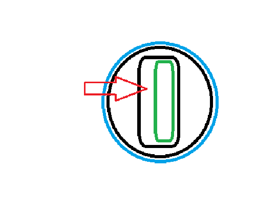

They make a flat screwdriver that is used for the very purpose of opening trunk locks. The tool is about four foot long, has a conventional screwdriver handle and a smallish flat screwdriver tip.
A person can take a regular screwdriver and tape it well to a broom handle or something instead of buying one.
Stick the screwdriver blade where the red arrow is and twist one way or the other. It should only turn in one direction. It does help to have a good flash light and a bit of patience. The truck should pop open a short distance.
I believe it will need to be rotated counter-clockwise - but don't quote me on that.

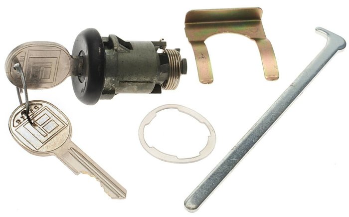

Once the trunk is open, the trunk lock cylinder should be removed, then bagged and tagged. The old lock cylinder can be taken to a locksmith to get a key made for it. With trunk lock cylinder removed, a person can close the trunk and insert a small screwdriver into the missing trunk lock cylinder hole and twist to open the trunk (until lock cylinder is reinstalled).
I did a quick eBay search and this is a random '61 Pontiac trunk lock cylinder.
If this is the correct one, when you will need a bigger flat tip screwdriver, and pry the squarish C-clip away from lock cylinder, and the cylinder should pull away from the car. The long flat piece is an extension from lock cylinder to the trunk latch. I'm not sure how it attaches – but should make sense when looking at both parts of it,
Reinstalling the lock cylinder is reverse of installing it. The trick is to get the extension into the latch hole. Then holding the lock cylinder in place when getting the squarish C-clip back in place. It shouldn't be too hard but may take a couple attempts. Just don't discard anything until its back in place.
Personally, I prefer to replace with new lock cylinders on older cars - but that is just me.
If you are painting the car, I would leave the lock cylinder removed, for now (again, my opinion).

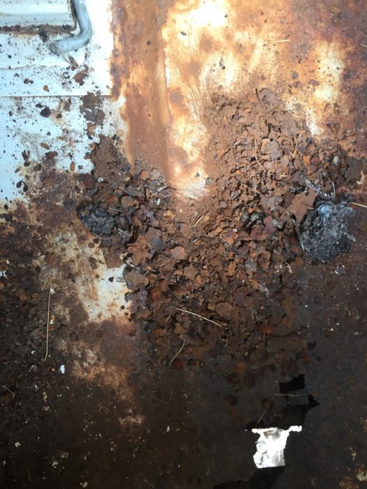

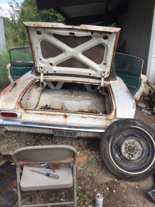

Trunk is open !!!

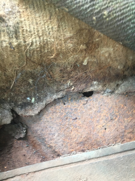

The trunk pan is toast. Lots of pellets of rust that I had to sweep up.
Pellets and a hole on this side with a matching one on the other side.

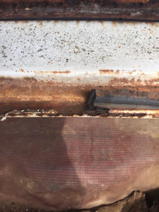

And this is the lip of where the trunk lid sits. It is gone on about 18 inches of the edge on the left side.
Looks like I have to learn about welding thin metal.

That car would not have a trunk floor in WI, or an interior floor, or most of the 1/4's, the rockers would be non existent, half the cowl would be gone...........even if it had been sitting in a barn since 1971.:eek:
What I mean is, what's rotted beyond repair in Arizona (or Texas) is called minor rust in the "rust belt" of salt happy DOT's.
Welding thin sheetmetal takes practice but a MIG welder is fairly easy to learn if you have never used one. Toughest part is patience. You use tack welds spread apart, let it cool some, then some more tack welds, let it cool, lather, rinse, repeat until the seam is welded together, so it doesn't end up warped beyond repair.
