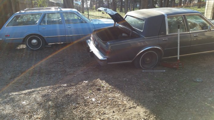

My metallic charcoal gray ’86 Fifth Ave doesn’t have any body or structural issues (minor door dings, except for picture below) but I do have a major (massive?) clear coat failure that needs to be addressed. I like the car but getting tired of looking at it. The roof appears to have no paint left on it – but that is hard to tell in this photo.
A 6" limb hit the car.
