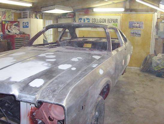

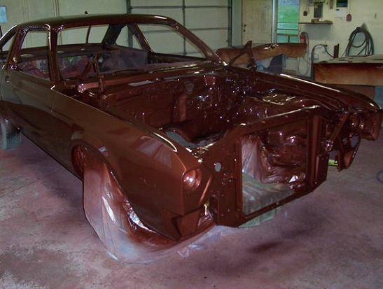

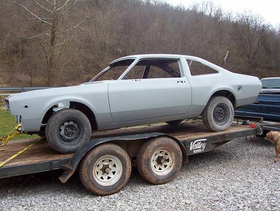

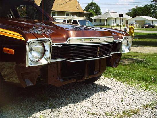

This is what it looked like after a toooon of metal work and new sheetmetal. This car has been in my family since 1981 but it was pretty rough by the time I got it so I had to pretty much build it from the ground. The only sheetmetal that is original to the car is the roof , floor and quarters, everything else needed replaced.

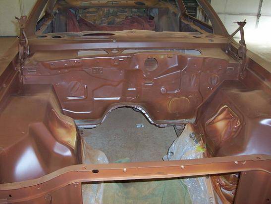

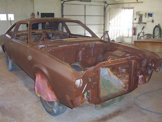

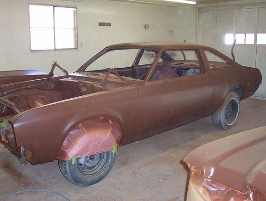

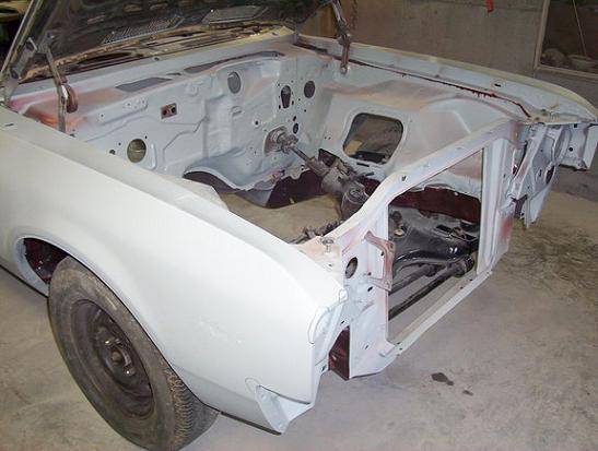

These are a few shots after it's first prime..
2nd prime:

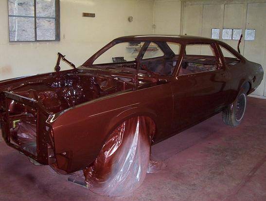

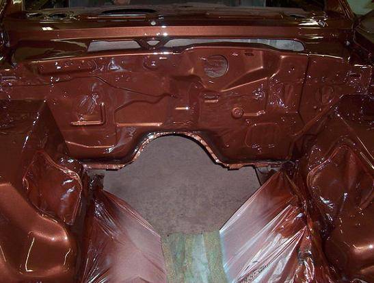

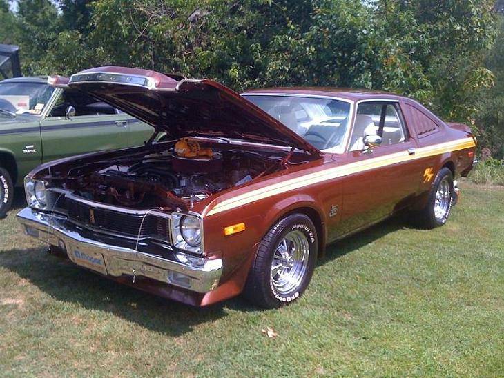

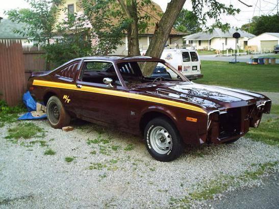

Paint day...

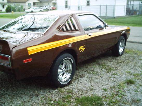

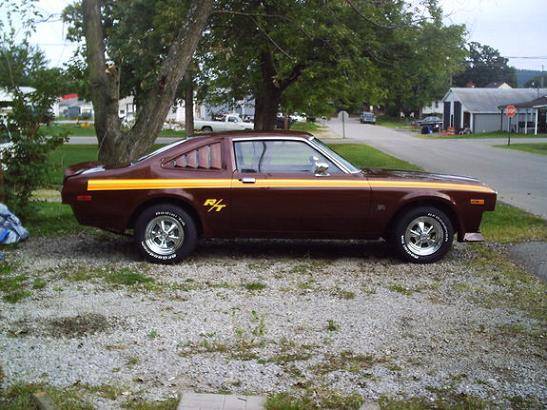

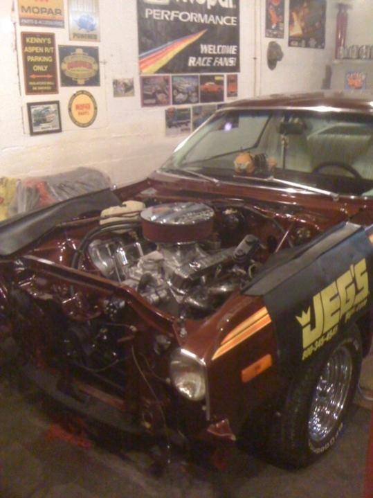

Assembly and stripes etc...I didn't have a garage at the time so I started putting this car together outside...

Where did ya get the stripes from? That is the stripe color I'm looking for. BTW your car is very nice.
76CinnamonRT
Feb 2, 2012
249
1
Ripley, WV
Well the stripes are NOS ones I got lucky on, they were still sealed in the box from 1976! I had to make the spoiler stripe and quarter-end stripes myself because they never did make a superpak car with these stripes. My car is an A57 R/T but it did not come originally with the Superpak stuff, I added all that. Phoenix graphix wouldn't make me a set in the right colors so I thought I was gonna hafta run the incorrect red/orange on the car until I ran across these!

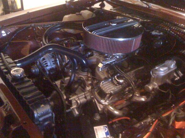

Good job. What radiator did you end up using?

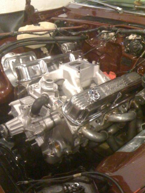

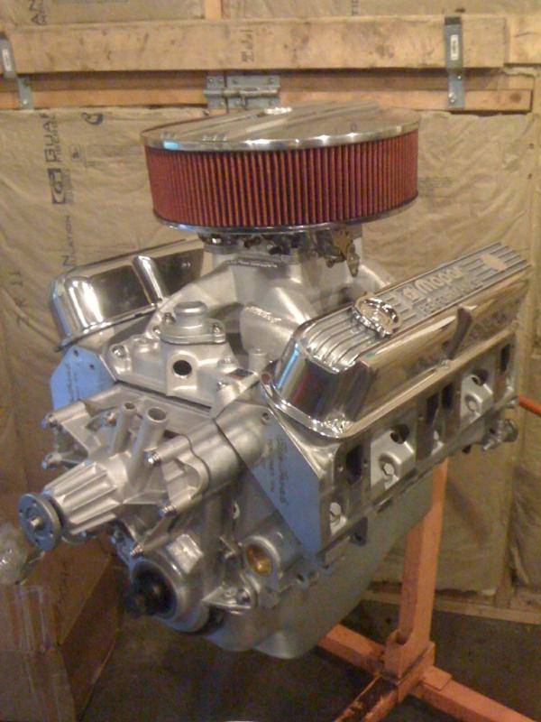

Right now I am using a re-cored 22" with an electric fan and controller. I am going to upgrade to aluminum later this summer when I get the extra $$$$.

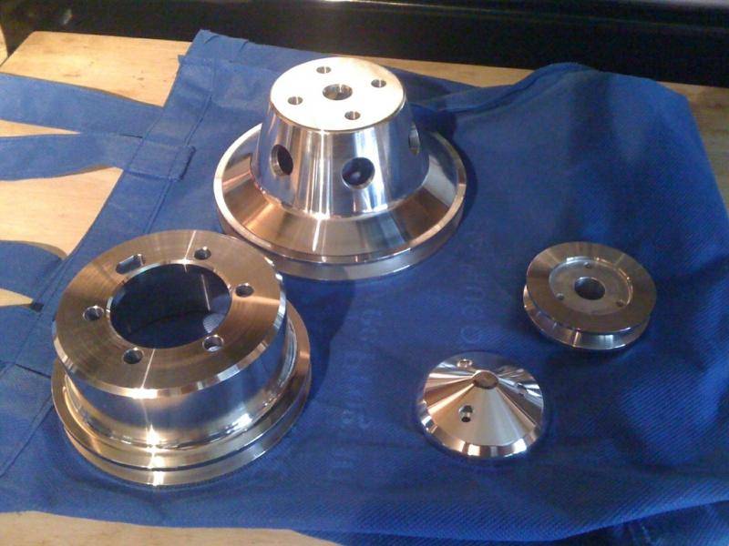

I did purchase these off ebay the other day...
The car is a manual steering car so pulleys are pretty simple.

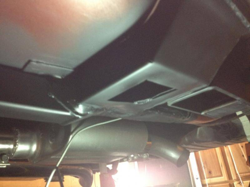

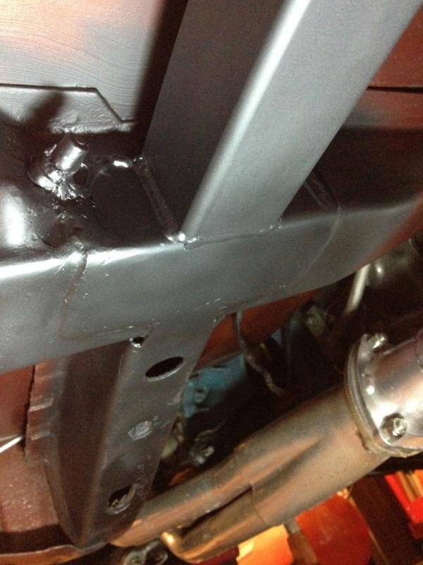

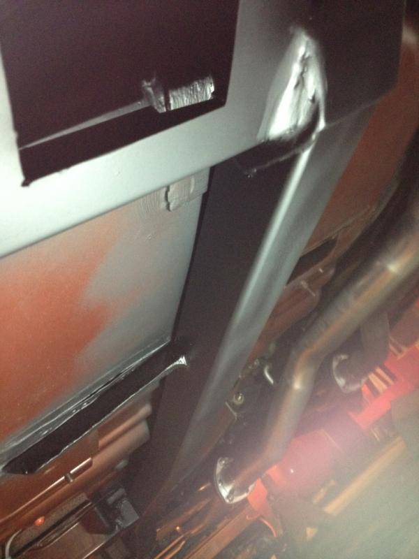

These are the Auto Body Specialties connectors/ torque boxes too by the way....
And the one in the back shows the adapters for the superstock springs, I believe those came from Mancini racing. I added a little plate to the bottom of them just to strengthen em up a bit....
The frame connectors and torque boxes had to have a little "finessing" to fit my car but over all they are ok. I would recommend anyone with one of these cars producing very much power invest in a set. They are gonna strengthen mine up bigtime, it would have been nice if they would have had em factory lol
