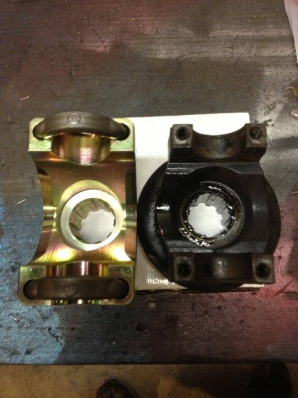

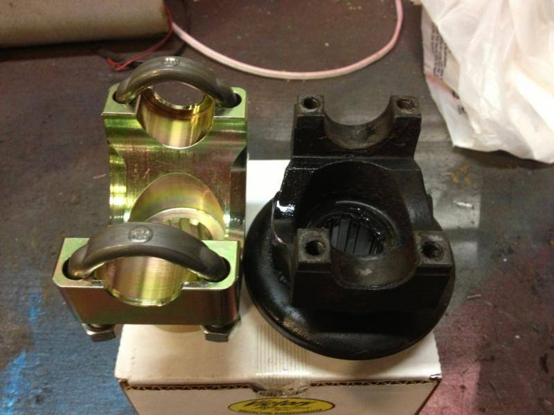

Been working on her again
New pinion yoke, went with a billet 1350 with u bolts, almost $200 but I have broke 2 mopar factory 7260's and I like overkill lol

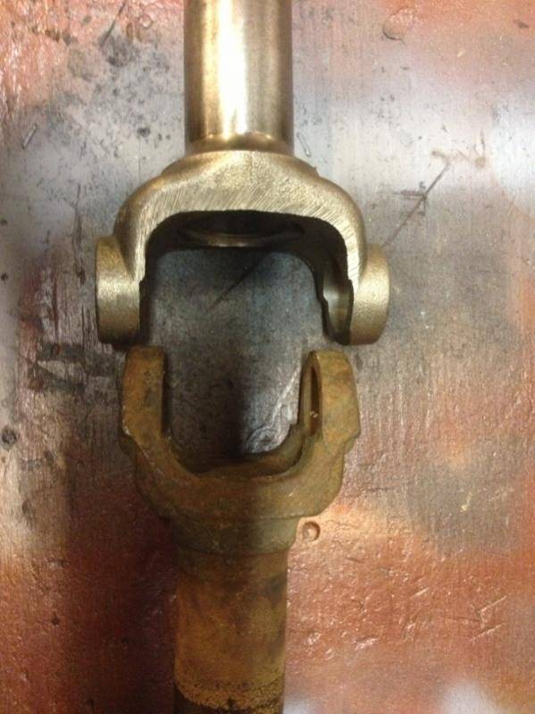

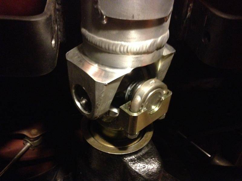

And here is the front, a 1330 series Spicer I found on Ebay for $25, fits the 904 and as I just recently learned 78 and up 833's lol

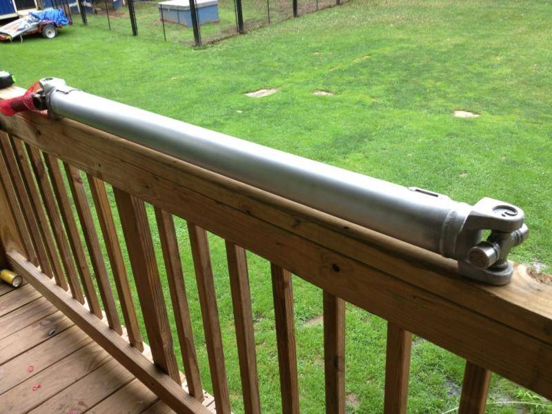

Gonna order a custom built aluminum driveshaft this week with solid joints, 1330 front and a 1350 in the rear.

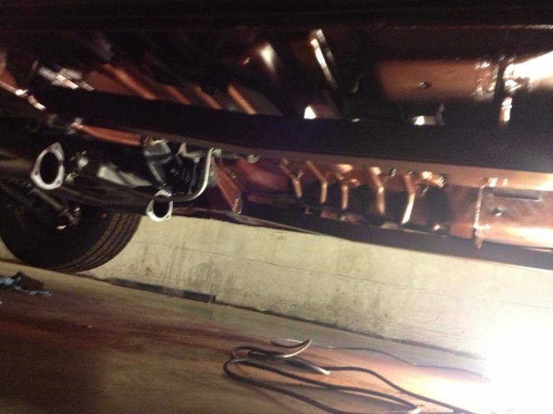

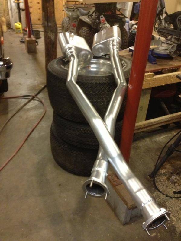

Got the exa-haust done and back under the car...
Frame connectors etc. painted back up..

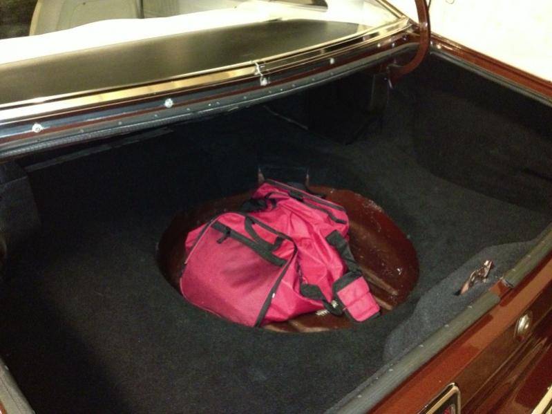

Carpeted my trunk. I got the plastic trunk dress up pieces out of another R/T along with my fold down rear seat. I am not carrying a spare so I made a plywood cover for the well and I keep my cleaning products in there lol.
-Kenny

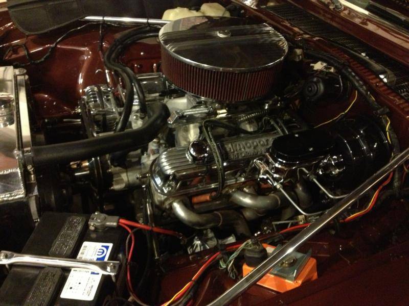

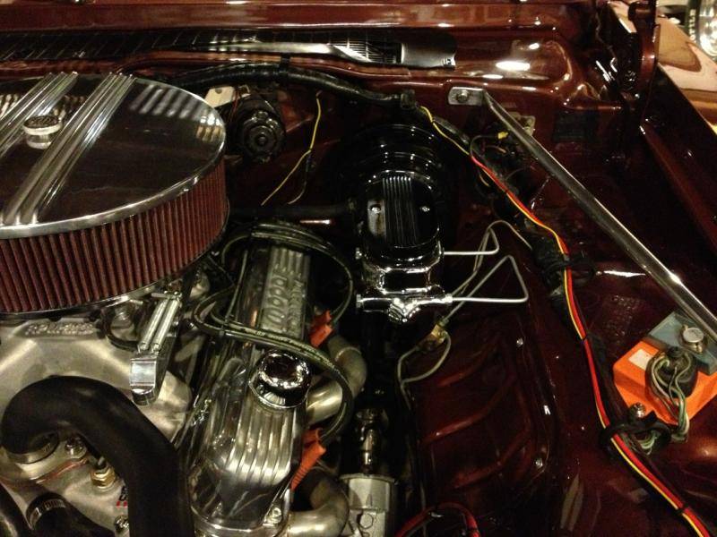

New powdercoated booster and master cylinder. This is the Ebay special kit for b/e bodies. I am happy with it, the 8" booster gives me waaaaaay more room to get the valve cover off the drivers side plus it all looks better. cost me $329 to the door.
