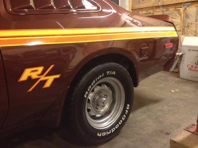

Well it did have 15x8" cragars on the ass and 15x7" on the front, with 255/60-15's on the rear and 235-60-15's on the front. It now has 15x8 Rallye wheels on the back and 15x7 rallye wheels on the front with the same size tires it had before I just bought new ones.
It took me forever to decide what wheels to go with I even had a thread on here asking opinions..
I haven't been on here for a while but this is where it is. I haven't bought centers or trim rings yet, I put one 1970 center I had on it to see if I liked it.

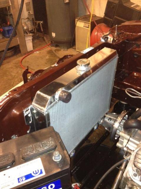

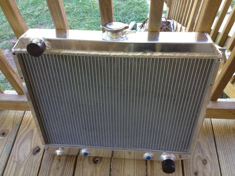

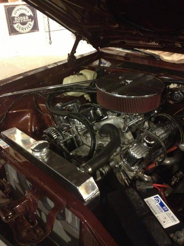

New radiator I got for it. I need to polish it I am not happy with the finish as it sits and I trimmed the brackets some but other than that it looks pretty good...
-Kenny
Yeeeeep sure is. Not a bad radiator, needs some polishing to be up to my standards....
Still not a bad deal, shipped to my house for $229.
-Kenny
Thanks for the info. Those ralleys look good. Man do i have a soft spot for those cragers.
I did like the Cragars too but they just got old. They had been on there since 2007 and I was ready for a change, plus they were starting to pit. The chrome is soooo thin on the new chinese cragars that polishing them by hand with metal polish will go through it.

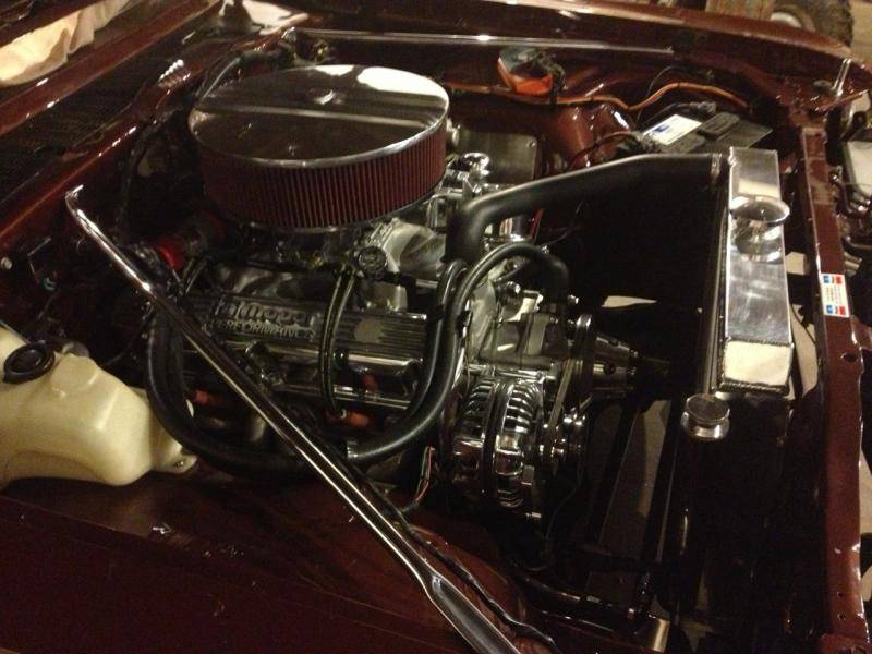

Well it has been a while since I touched it but I have been hitting the car hard the past week. Spring will be here soon.
This thing used to be all stock under the hood, and it all changed just because I didn't want to paint my heads lol
Electric fan and Wilwood master cylinder are next.
-Kenny

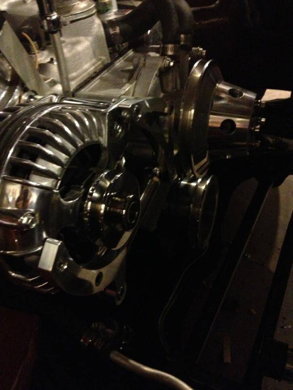

Billet alternator brackets and pulleys and a Tuff Stuff 100 amp alternator...
Noone makes polished fender braces for a lowly Aspen so I made some myself.
